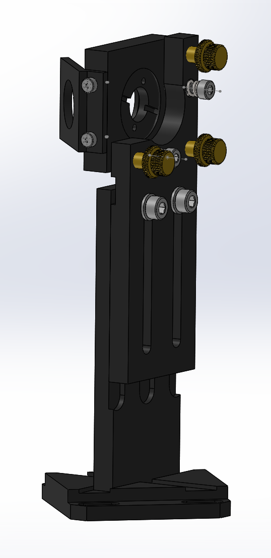

Here’s the second stage mirror assembly. Shares most of the parts with the first stage, but one part is shorter and has different slots, and the other two parts are utterly different. But I started with a copy of the first mirror, and changed the parts, so it’s basically the same design tree. Again, this model is good enough to use to validate fit in a model; not for manufacturing.

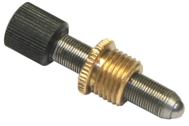

Through this modeling work, I learned about the M6x0.5 screw pitch. At least, I believe this we have correctly identified what they use for the kinematic mount roll/pitch/yaw adjustments for the mirrors. It’s the first time in recent memory that I’ve run into a screw pitch that I don’t find on McMaster! But I can still find M6x0.5mm tap and die on Amazon with Prime shipping. If I ever am doing another kinematic mount for a 3D printer, this is an attractive option.

I can’t find the roll/pitch/yaw adjustment screws for sale anywhere. It’s hard to believe that they are really a custom CNC part for only these laser heads; feels more like I am just failing on search terms to find them offered for sale somewhere.

Other than modeling the kinematic reference screws and locking nuts, and adding standard screw/spring hardware, we have an assembled model of the first mirror set.

Yeah, I can find those set/grub screws in the US too. But no other kinds of screws so far…
Wouldn’t those be usable? They would give you the option to scew on a counter nut without unscrewing the whole screw.
Misumi seems to have some:
https://de.misumi-ec.com/vona2/detail/110300591440/#
https://de.misumi-ec.com/vona2/detail/110302671930/?rid=rid3
https://lehmann-praezision-shop.de/de/
The set screw tip shape is wrong; needs to be pointed to engage with the floating mount. Also brass is softer than steel. :smiling_face:
YES!
“XBM6” tells me English “stage maintenance feed screws” and now I have the initial search terms I need.
“9S7C-18” leads me to “micrometer screws” as well.
Thank you! :smiling_face:

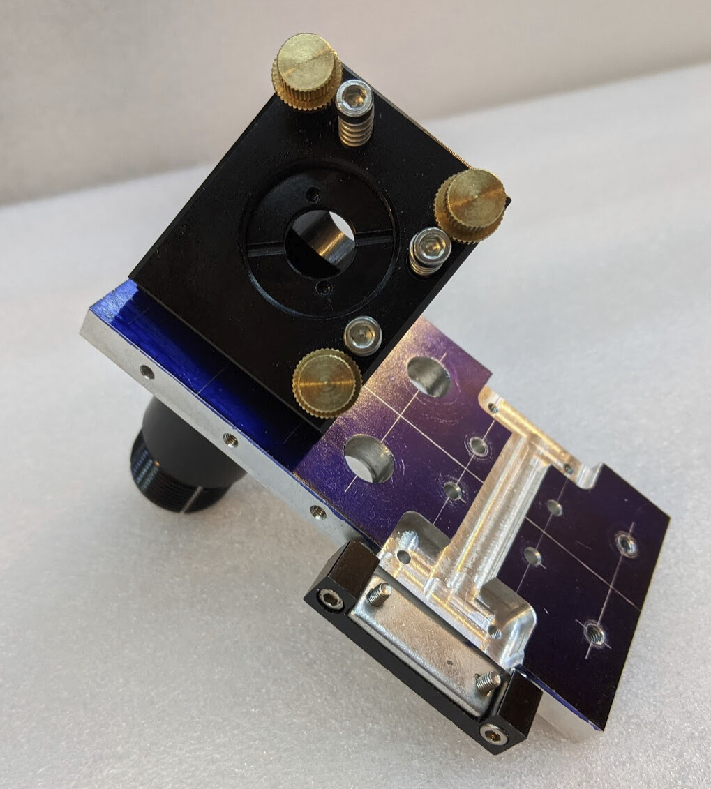

In the meantime, I made an alternative bracket that is designed to print or machine. I’m starting with printing, but may well cut it out of aluminum later once the design is proven. Here it is, done with the realthunder branch of FreeCAD:
The 3D printed bracket isn’t as stable as I would like.
Also, I worked out that the intended linear rail for the cloudray C head is HGR15, because as far as I can tell it is the only type of linear rail that has M4 holes on a 26mm square. If I hadn’t already purchased MGN12 rail I would just use the bracket that came with the cloudray set, and if anyone follows after me here to make another monocle, that should be the norm. In fact, HGR15 rails can be bought for $90-$100 for two 1500mm sections with four carriages, which could be cut up and be enough rail for the whole thing as long as you don’t want more than about 700mm Y travel.
But since I already have different rail, I thought I’d use my measurements to make a replacement part with mounting holes appropriate for MGN12-C with 20mm x 15mm M3 mounting holes.
When I tried to assemble it, I discovered two small errors in the model; one was that the countersinks for the laser head mounting screws are slightly too deep, and the other was wrong screw spacing for the belt clamp — I’m not sure how I measured that wrong from the model, and at least I got the holes on the side for the belt tensioning clamp right. Washers will solve the too-deep countersink, and I can work around the belt clamp problem one way or another, maybe just making a new clamp using my mistaken measurements.
