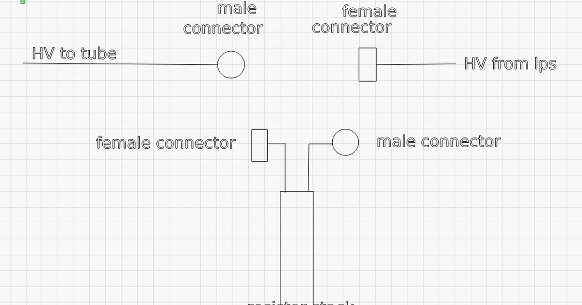

With connectors, always ensure the female is on the supply end. That way you lessen the chances of it contacting anything. Don’t want the protruding male end to be exposed, whatever the voltage. Generally you don’t leave wires unconnected if there is any chance of it powering up.
When I build stuff I make my cut where needed and install a pair of connectors to reconnect the wiring. When I want to ‘insert’ my device I match the connectors so I can just put it in circuit. I can remove it and restore the original wiring or vice versa in a couple of seconds. Of course you need an extra set of connectors for each device.
Maybe this sketch will help illustrate, it’s quite simple and you probably already know it anyway.
They build the connectors for laser tube connections… Here’s one from amazon
Jack (8-))
Ah, I see, patching in the middle, not creating a pigtail. :+1:
