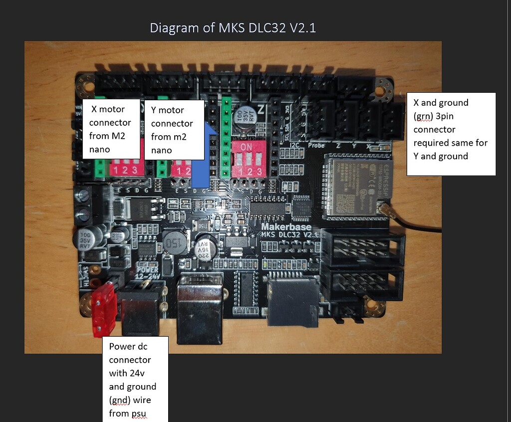

For nearly the same price you can get a dlc board…
I found one on ebay for $15, but it failed to arrive… finally purchased one from Amazon for just under $60 US.
