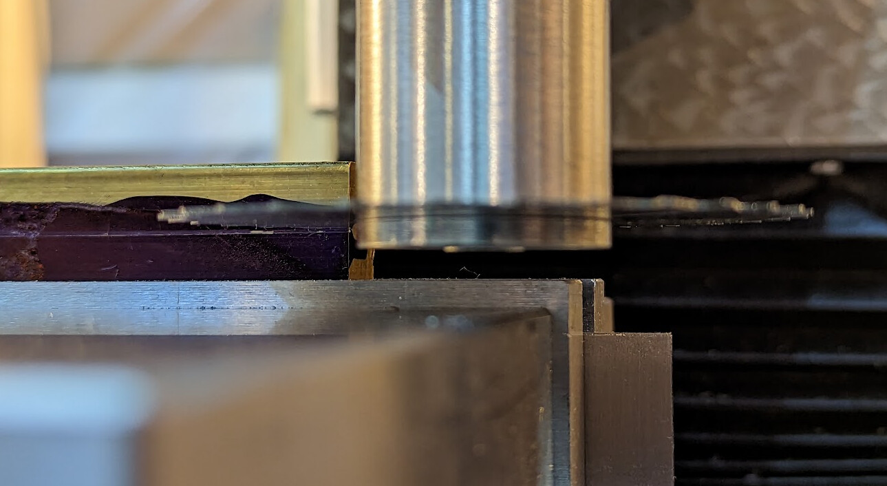

Here’s why I made my own slitting saw arbor: instead of making the top of that brass offcut into chips, I sliced it off so that I can may be use it later. I’m such a stock miser!
But then I was scared about whether I was going to experience Rapid Unplanned Disassembly of my saw, so I ran it with a shock absorbing mat in place just in case:
I needn’t have worried. It worked fine. The saw ran true enough that I had both entry and exit tooth lines on the face, and it measured true to my reference side.

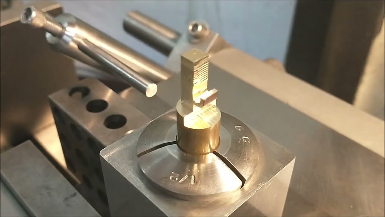

Then I sliced that into four raw pieces:
Apparently I took no pictures of truing them up, but I did that with a fly cutter with polished inserts intended for aluminum. The problem I had there is that I initially intended to gang-cut them, but it turned out that they were inconsistent enough in thickness that the vise didn’t hold one solidly, and it moved and scuffed the surface. That’s the die that I ended up practicing on, making it a normal-ish D6.

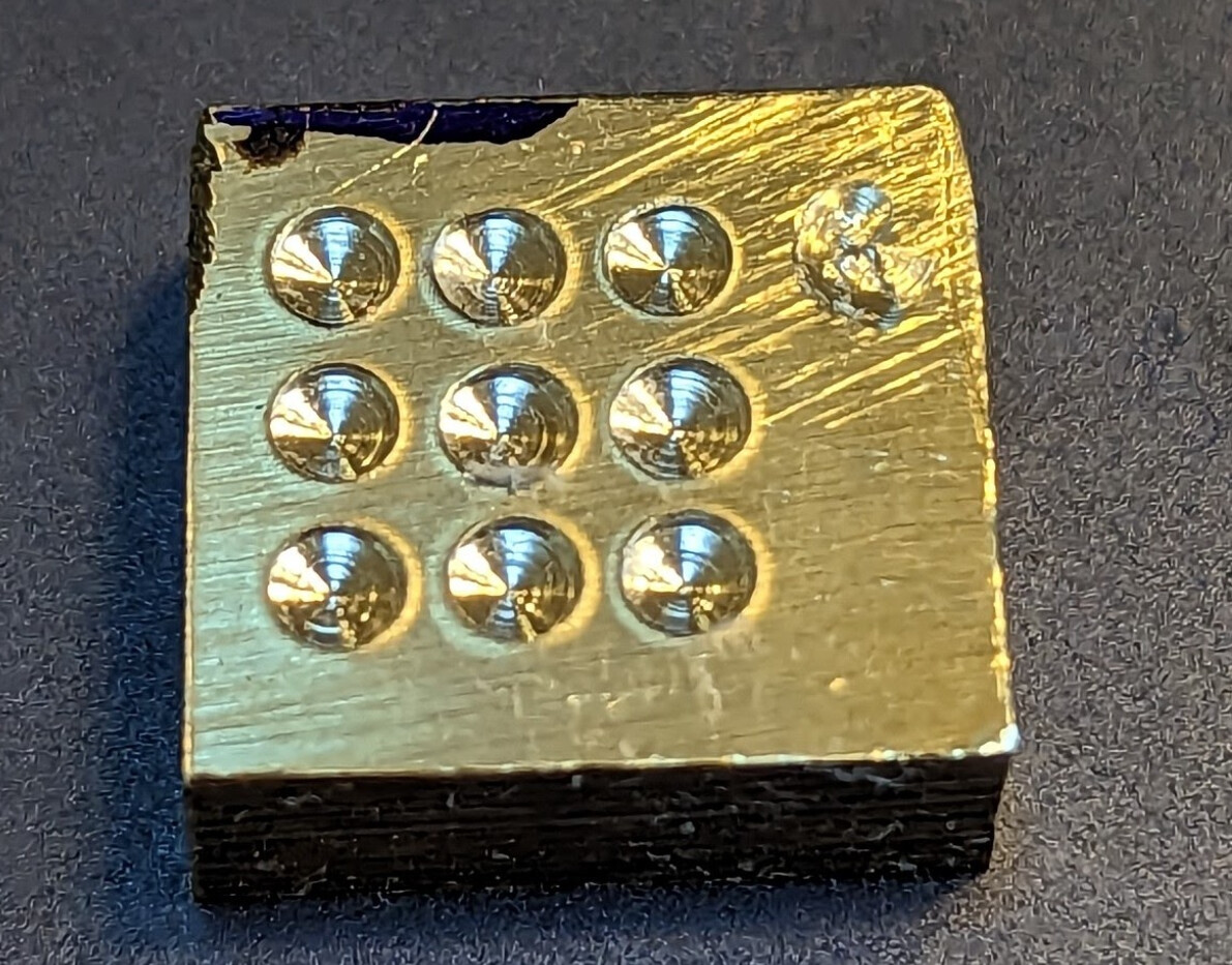

While I was working on this, I couldn’t find my 2mm end mill and tried hand-grinding a broken 5/64" drill bit to cut the pips, since that’s basically 2mm. It made 2.5mm pips and wandered:
That test coupon was the offcut from the end after I’d sliced off four cubes. Waste not, want not!

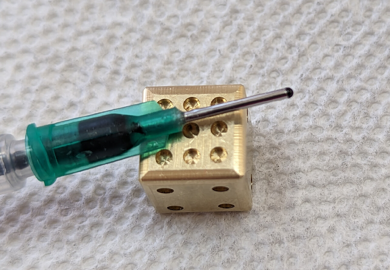

This drop of paint barely peeking out the end of the blunt needle was too big and I had to clean up overflow afterward.
Here’s the filled hole:
Incidentally, you can see that even with 3000 RPM on the roundover bit and cranking the table slowly through both passes from both sides, there are still visible milling marks on the roundover. Oh well. You can also see how I knocked down the corners a little.
For the green, I switched to a smaller, bent needle:
This was an improvement.

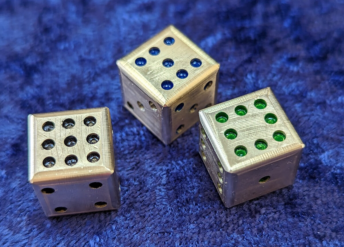

As the enamel dried, it got darker. In the end, this is going to make it harder to distinguish the dice. If I had it to do over again, I would mix up a few ml with a drop of white paint to make them lighter. It’s possible that I’ll use these as a base coat and then put lighter enamel on top some day, if it makes it easier for my wife to use when demonstrating this.
We couldn’t wait any longer for the enamel to cure. It’s inside the pips; nothing is going to dig it out… We had to give it a shot.
After dinner, we sat down with paper and pencil. We each threw each side of each pair 45 times, and recorded the results.
Five out of the six rounds produced the theoretically expected results. The expected results were A beats B, B beats C, and C beats A. Other than a single round in which A beat C, all the other five rounds ended up with the expected results.
