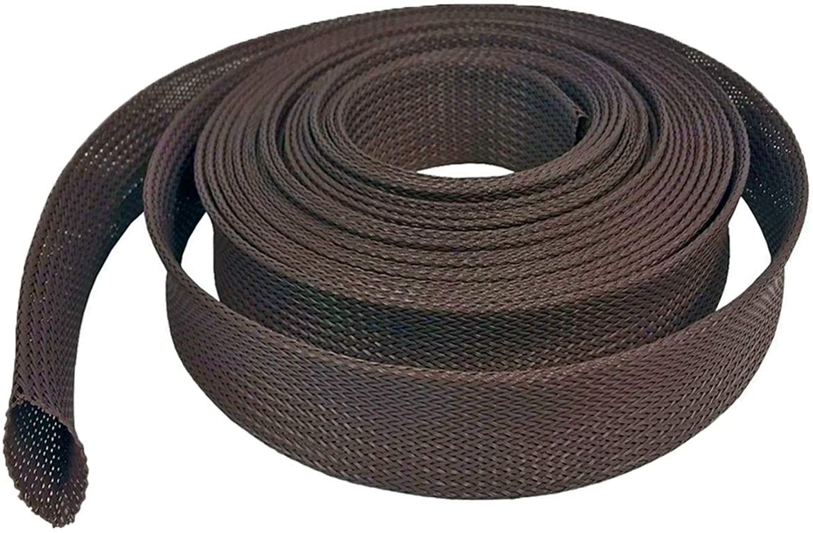

Squirrel proofing your CNC apparently needs to be a thing now :rofl:
Maybe some heavy duty cable wrap, giving the :chipmunk: something to chew on besides the wiring? :thinking:
https://www.wirecare.com/category/braided-sleeving/heavy-duty-sleeving/rodent-resistant-sleeving/rrn0.50db-rodent-resistant-1-2-dark-brown-10-ft-cuts
