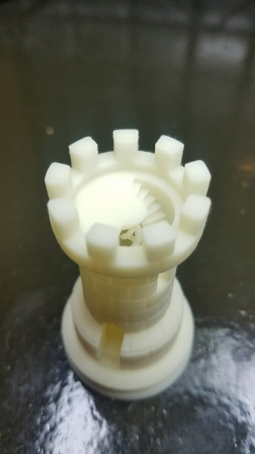

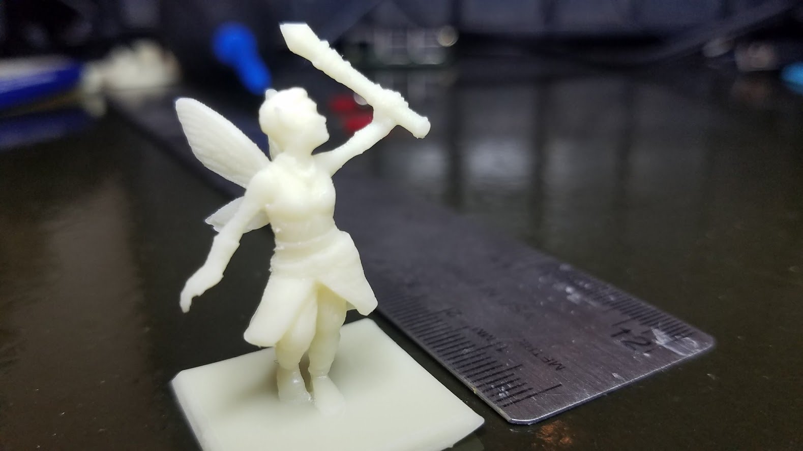

Morpheus Delta - More prints I did over the weekend.
Morpheus Delta - More prints I did over the weekend. I created the vat cover in Fusion360 and printed it in flexible TPU.
I still have a lot to learn printing with resin, so some of the imperfections maybe due to my lack of knowledge. I tried some MakerJuice G+, but got very poor results with the default resin settings.
still pretty cool

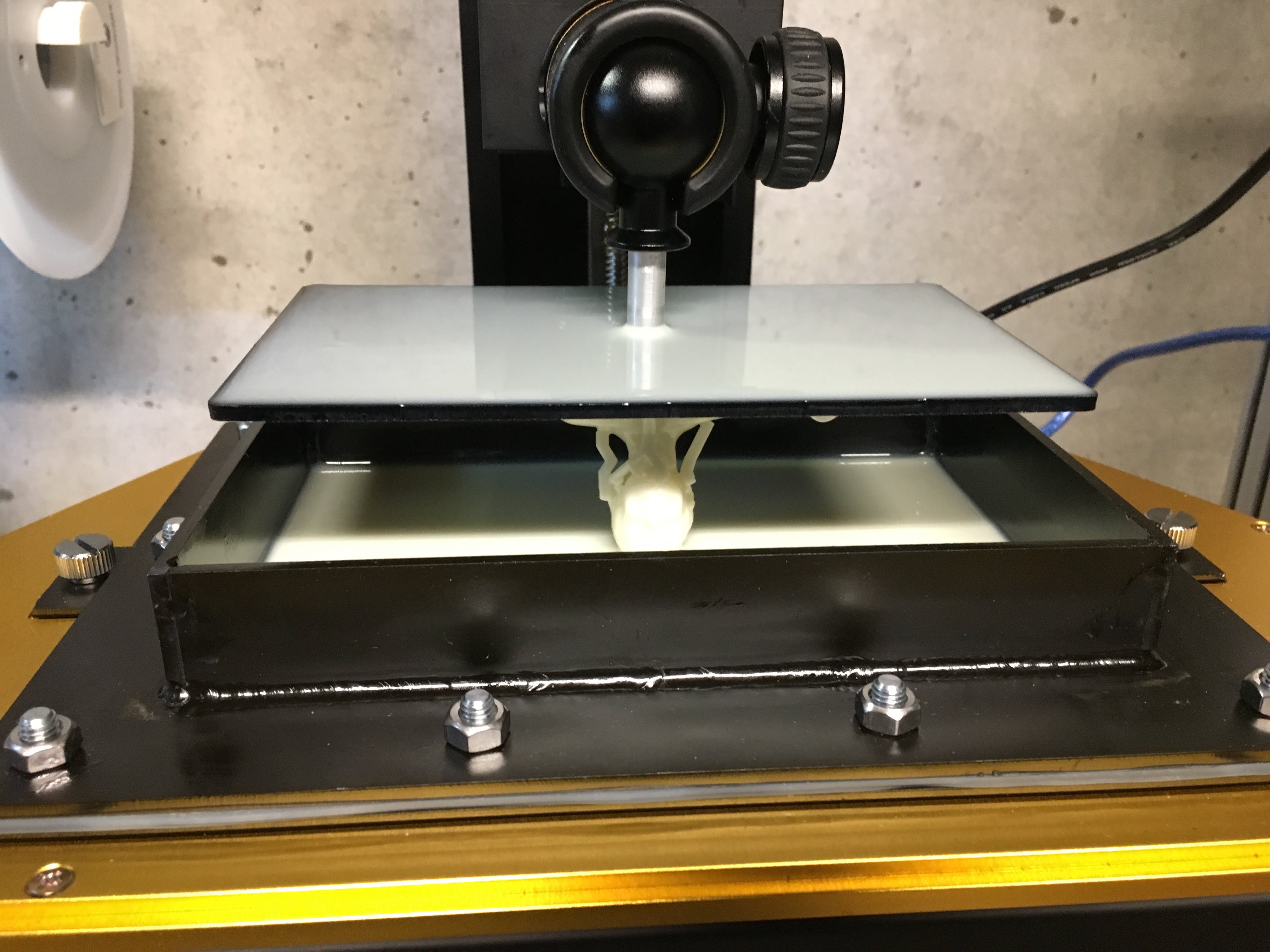

Nice work, but why would you need to print supports ?
@Rob_Wilson ​ The liquid resin is just as bad as air to support the printed part.
@Rob_Wilson The following would still need supports even though it is an SLA print.
(don’t mind the really bad image)
The dark green is the uncured resin line, the shape below that line is has not been printed yet, I am just showing what it will try to print, the box above the dark green line has been printed and is attached to the build plate. Hopefully this bad diagram clears it up.
