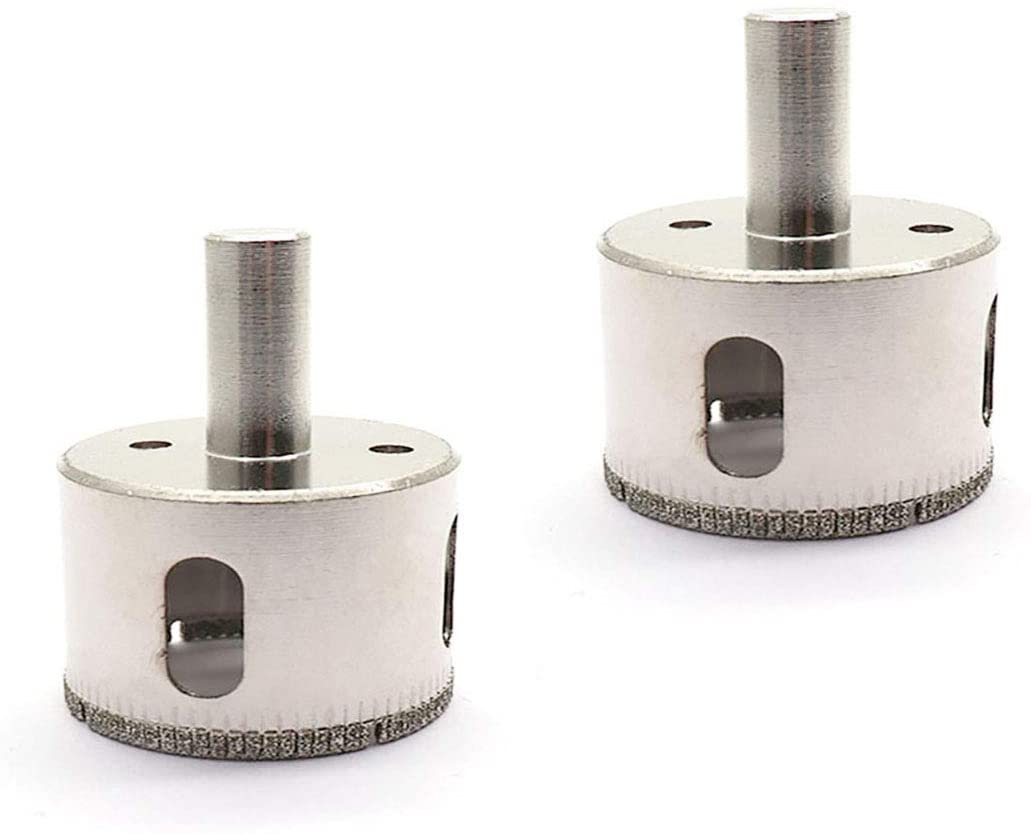

I wonder about using a modified hole saw as a punch.
I made something similar to cut sandpaper circles. Work marginally well.
Cut the diamonds off this and then sharpen the edge to a cutting bevel.
Put material on a piece of wood and use hammer or press to punch the material with this tool???
After a cup of coffee I said to myself… self just search for a 40mm punch on amazon…then there was this…
Now I need one of these to punch sandpaper :slight_smile:

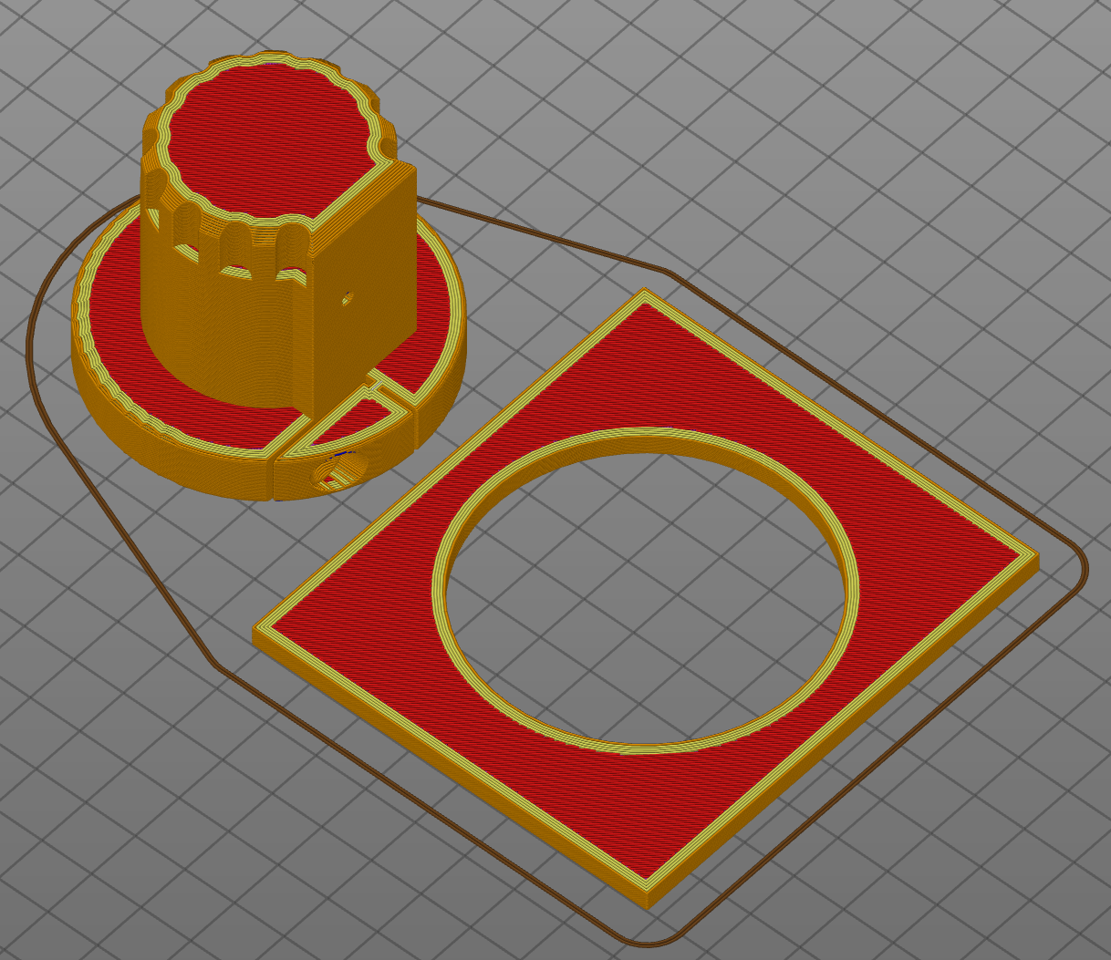

The cutter I designed last night worked great except that the pieces are just a tiny bit too big, because in one place I forgot to account for variation in extrusion width. I have some design ideas to make it easier to use, too. Other than that it works great, so I just have some design tweaks to do.

Third iteration circle cutter printing now, with feedback from beta testers (my kids):
