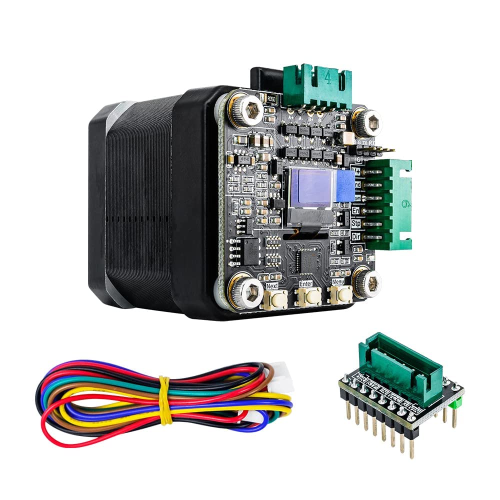

Here’s a closed-loop stepper motor — that is, an absolute encoder that attaches to a stepper motor and corrects for position — that’s not super expensive:
You can also buy just the board and all other components to add to an existing stepper motor:

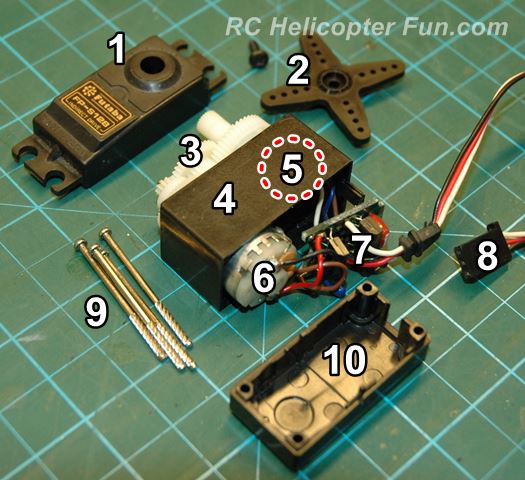

Classic answer here would, I think, be a servo, of the kind used in RC, where it uses only as much current as needed to drive to a setpoint. Move it by changing the setpoint.
Here’s a random page I found with some discussion of “RC servos” — there’s no particular reason that they actually have to be radio-controlled, but it’s a common hobbyist application.

BTW the servos that @mcdanlj recommended are also a good choice for motion control.
I have used them many times for positioning and they are easy to implement as there are many Arduino libraries and RC servo driving boards.
They are generally inexpensive at lower torques and get more expensive at the higher end.
The torque requirements will probably be the limiting factor using these.

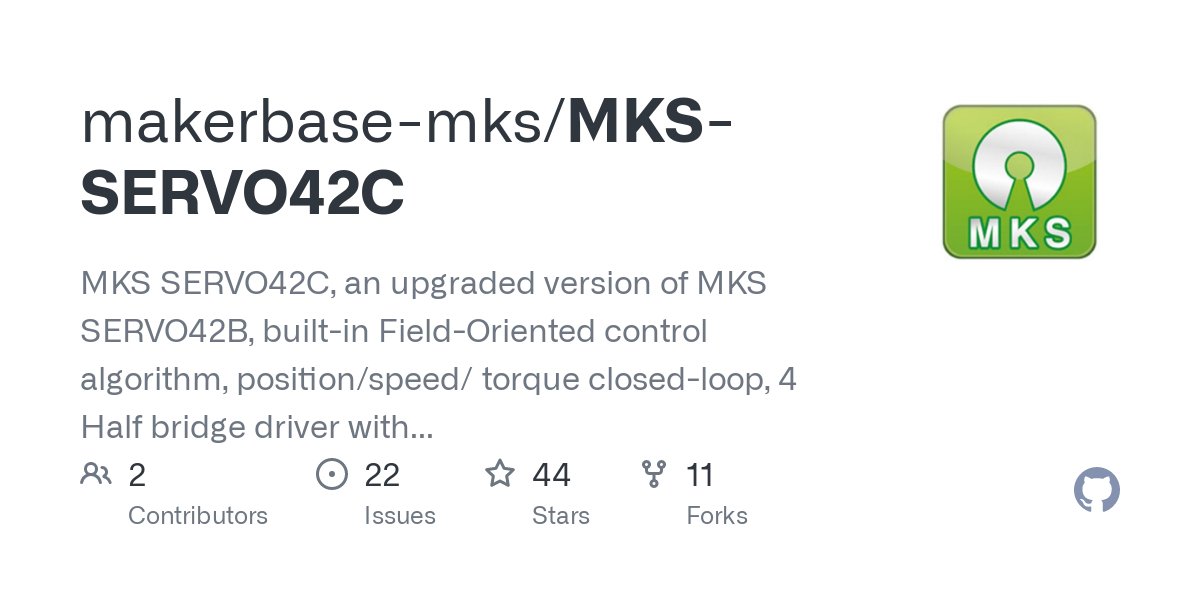

Looks like they are currently having some teething issues with this board.
They haven’t open-sourced the firmware, but if they did it would probably be possible to use this board as a servo controller with alternative firmware.
@Jon_Charnas did some digging and it looks like MKS used some GPL firmware without releasing source. sigh

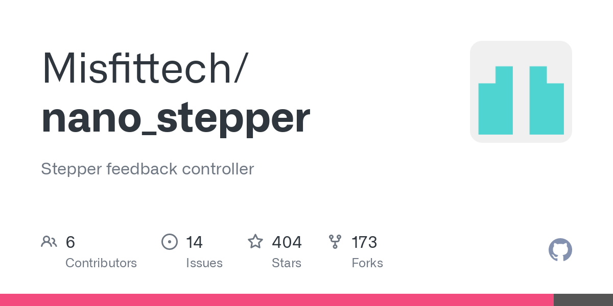

The https://misfittech.net site links to the source which has a note about this:
MKS has taken this firmware but has not provided source back and hardware designs back to the community.
Having been an RC pilot over a decade, no. The torque won’t be. The budget to achieve desired torque will. You can get very beefy servos. But they get pricey real fast, and need a whole lot of power (i.e. 2-cell lipo voltage, if not higher).
