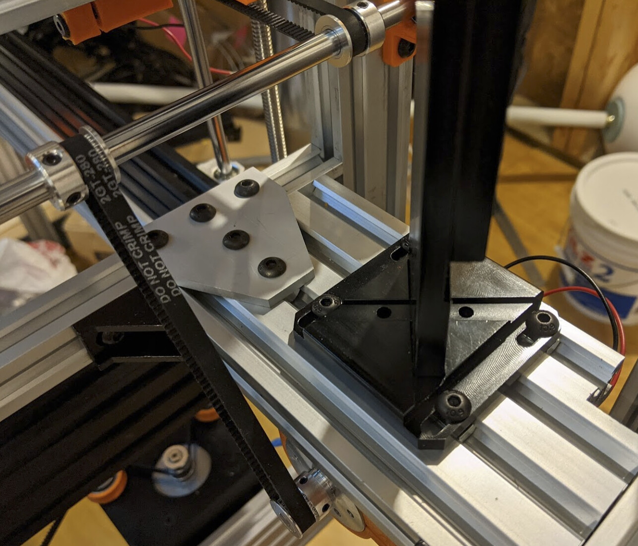

Unlike the saga of redesigning the Z stage, this one ran smooth, it seems so far. Removed the first mirror mount shelf, installed some more t-nuts in the bottom, mounted the motor loosely to the bottom, put the shelf back, slid the loop around, slid the motor back to tighten it, tightened all the screws and pulleys, and it seems quite solid. Very happy so far with how this worked out.

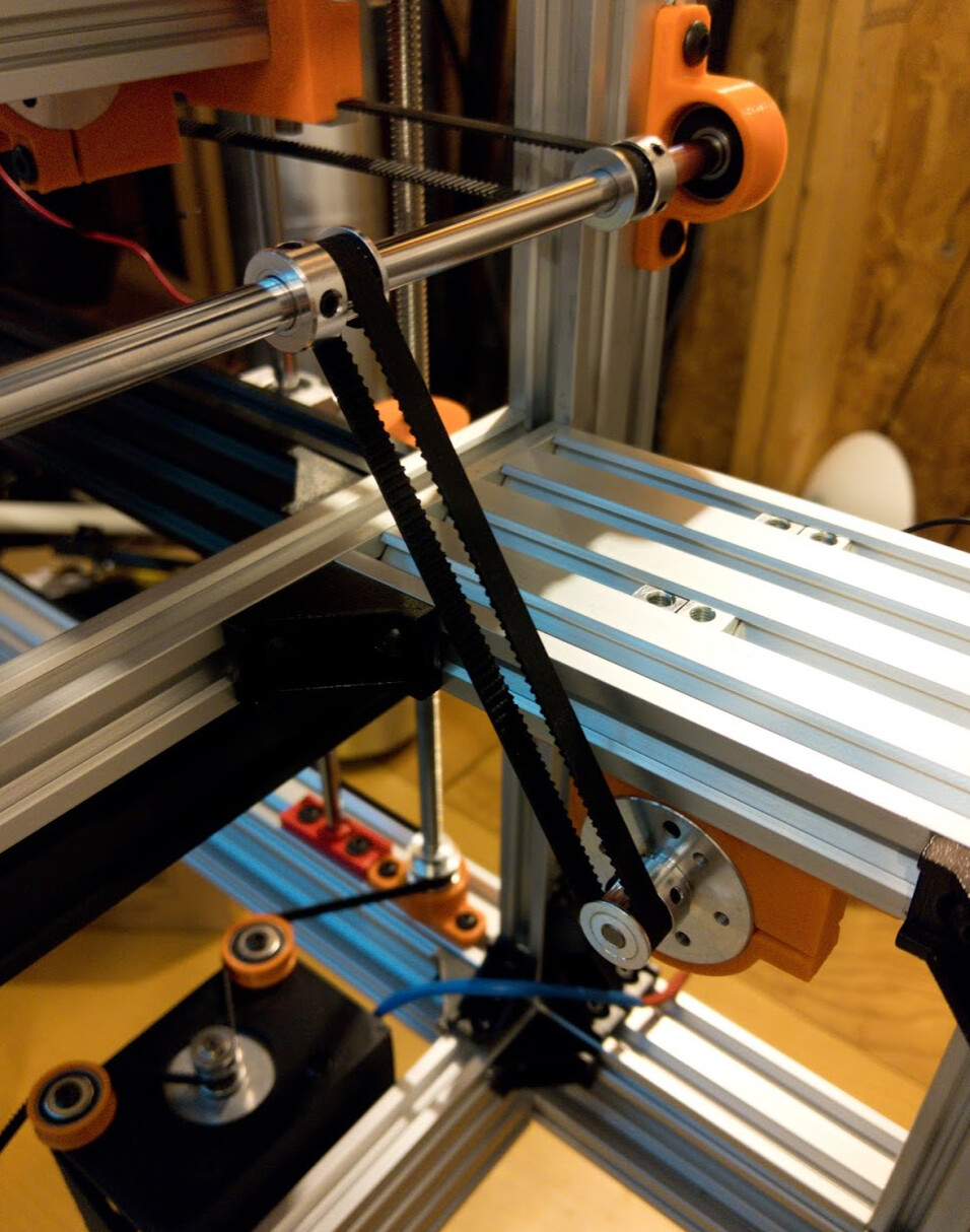

…and the view from underneath:
Since that shelf also holds the first mirror (see the 4 empty t-nuts in the first picture), I need to make sure that this shelf is very stiff. I might use some openbuilds t-joining plates if I can fit them in with the mirror.
All I need now is to design mounts for limit switches and I’ll be ready to hook this up to a controller board and see how it moves. Hoping I can tune the Tarocco board without building new firmware for it; I didn’t realize until after I bought it that building firmware for it requires Windows, which I don’t have installed on my laptop.
Turns out there is room for a t-joining plate on only one side, at least lined up with where the tube is now. I think it will be stiff enough. If not, I can probably slide the laser tube a bit toward the front, move the first mirror to suit, and then put a second plate in.
I originally cut that corner notch when I thought this shelf might need to slide over between the 4040 corner uprights. I should consider cutting a new shelf, I guess.
