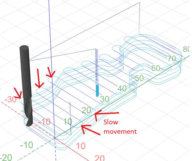

I just finished building my first DIY CNC. I modeled a simple part and did the CAM on it with Fusion 360.
I uploaded the G-code on CNCjs and started the program (after positioning everything). The program seemed to go correctly except when it needed to do arcs between straight movements. Arc movements seemed to be super slow (about 0,1 mm/s). I have tried to increase junction deviation (tried so far 0 and 0.003) and acceleration (20 mm/s^2 and 30mm/s^2) but it doesn’t seem to help. I also have chosen in Fusion 360 “selected configuration” as Smoothie since I use Smoothieboard with recent CNC firmware and config.

Tried increasing mm_max_arc_error from 0.05 to 0.5 and it didn’t seem to help much. Increasing acceleration helped but arcs are still super slow. I tried to do arc movement in a cut that had radius of 20 mm and even that was super slow.
Perhaps I should try generate G-code on something else than Fusion 360 if the settings I use there are not fully compatible. Just doing a simple arc should check if the problem still persists.

Increasing “mm_per_arc_segment” from 0 to 0.5 seemed to fix the issue for at least face milling and 2D contours. I can clearly hear each time it does one arc segment and I worry that may cause inaccurate parts. Boreing operation seemed still slow but I haven’t yet been able to verify that it isn’t due to settings in F360.
