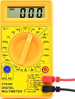

The multimeter that you show above does not have a timed power off and therefore if you leave it on it kills the battery.
As @tomatsu suggests get meter off amazon that has an autopower off and the batteries last a long time no need to externally power them.

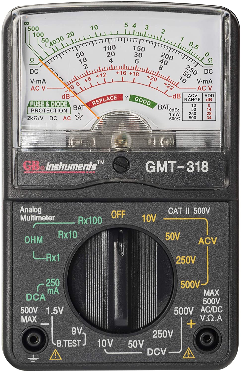

Depends on what you wish to measure. Today’s digital meters have a high input impedance, meaning you won’t ‘load’ the signal you’re reading.
This is type I was brought up with… requires no batteries except for ohm measurement.

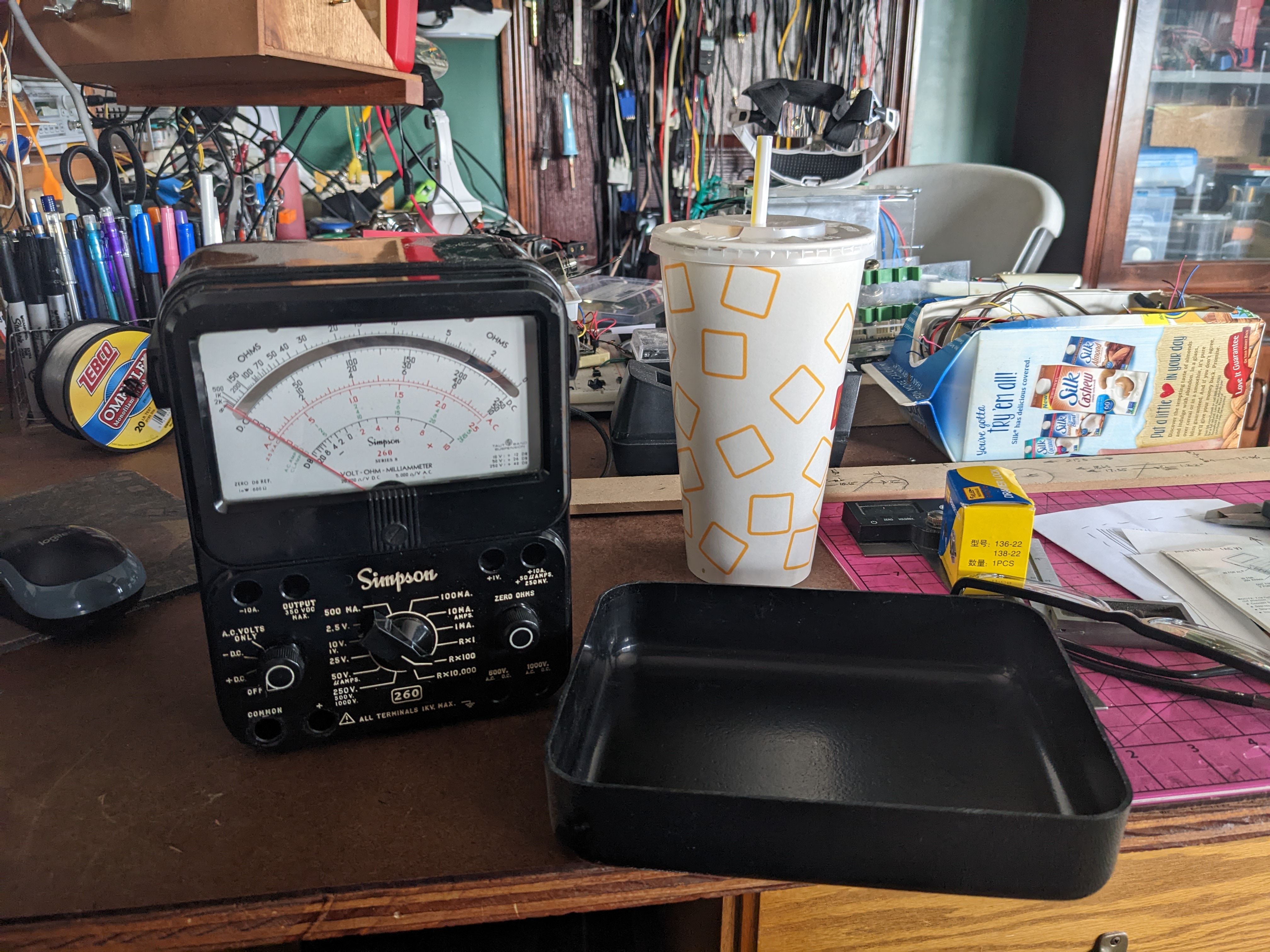

I got one like this before my first year of high school and I still use it. A tad lower cost 55 years ago :crazy_face:

That’s cause Simpson 260 are collector’s items…
Sweeet! I can feel the smooth notching motion of those knobs just looking at it.
Yeah and it takes up 1/2 of my bench space.
It looks pretty ridiculous hanging on my blet.
Guess we’re showing our age… :frowning:
Should a I post a photo of my Heathkit VTVM.?
The Simpson was a lot smaller than my scope… back then.
