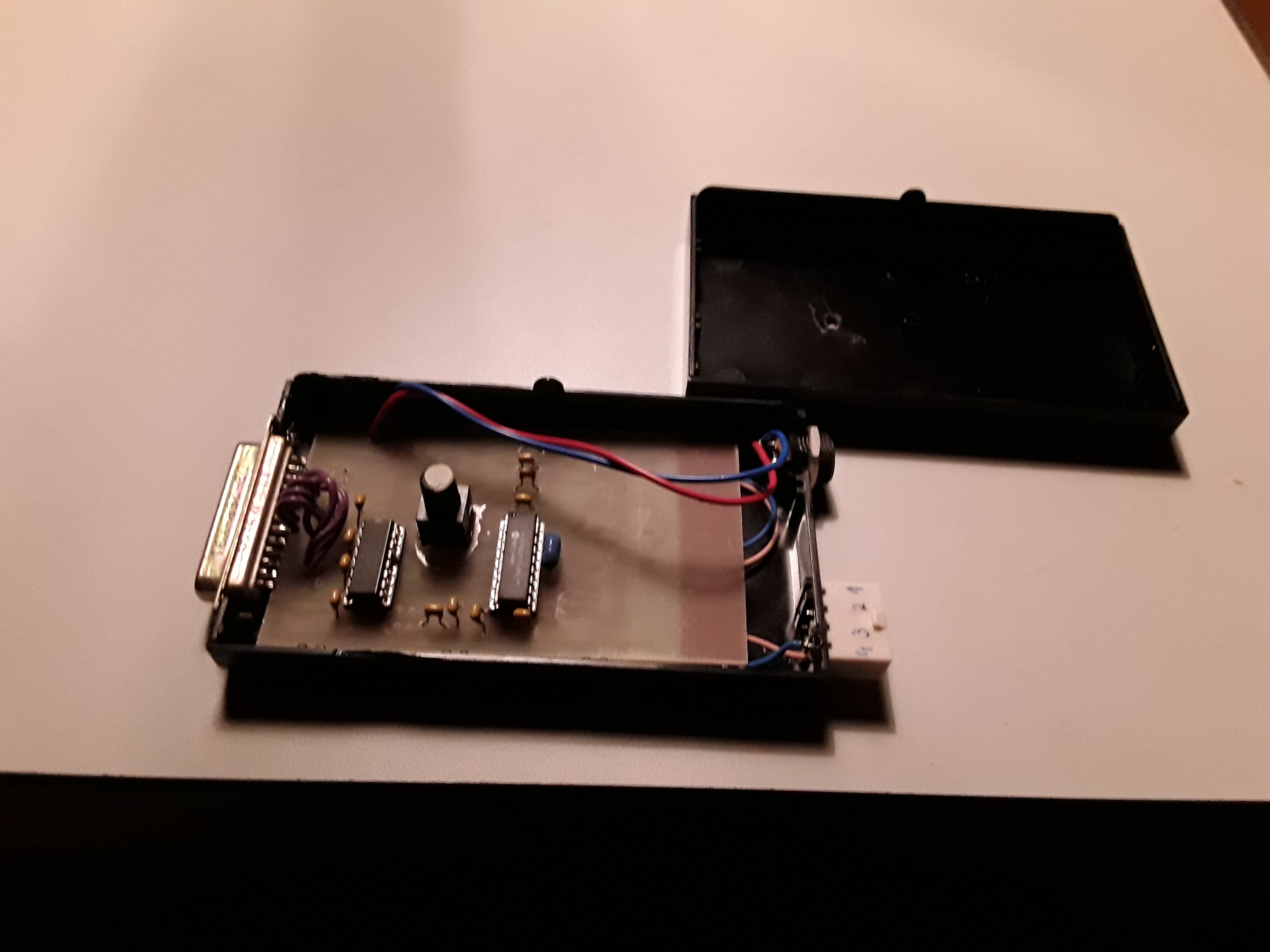

So I built a small controller board which triggered the remote controls of the projectors via opto bank using a PIC controller.
The comunication was solved via RS232 and the command protocol (on a 5 1/4 Disk) was generated via an ASCII table which contained the CD time code of the audio track and was triggered by the running Disk so dependent to the time related signal the two projectors were able to feed foreward and backward
As to fade and blend.
Unfortunately RS232 is past, Delphi( the PC + script/ protocol generator) too and … what is a 5 1/4 " disk, please! One of the projectors was defective and the other had been sold… so the controlbox is the only thing remaining just for sentimental reasons

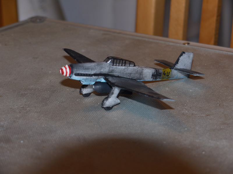

The Stuka was the smallest model I ever built. The Rx is a keyless entry chip (so8) which was supported with the peripherals on the chip case, actuators were 3mm coil actuators with 0.5mm carbon rods manipulating the rudders and the motor was a 4x7mm type from vibrating in a cellphone… battery 100mAh single cell placed in the 500kg Bomb under the fuselage. 15.5cm wingspan 3.05grams all up weight… unfortunately too fast for indoors and too sensitive for outdoors, so it did not have a long life

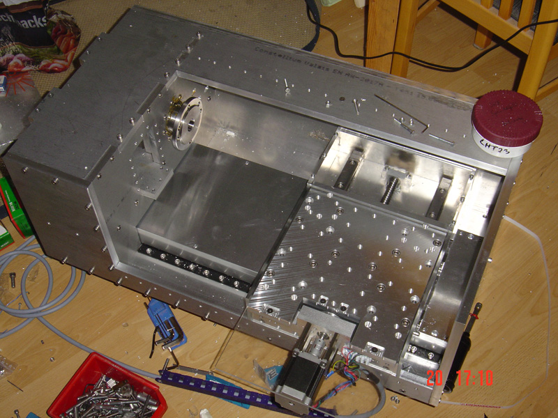

With the rather 60th plane after the same technuque I decided to go a step further and to search for a CNC router to buy. After 1.5 years of research I was not willing to spend that amount of money for the available low precision, and decided to build my own one. But after it went little over budget , I decided that it would have to have additional features for the price.

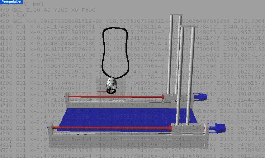

So I made the concept modular and wrote a preprocessor to generate gcode for wire cutting ability.

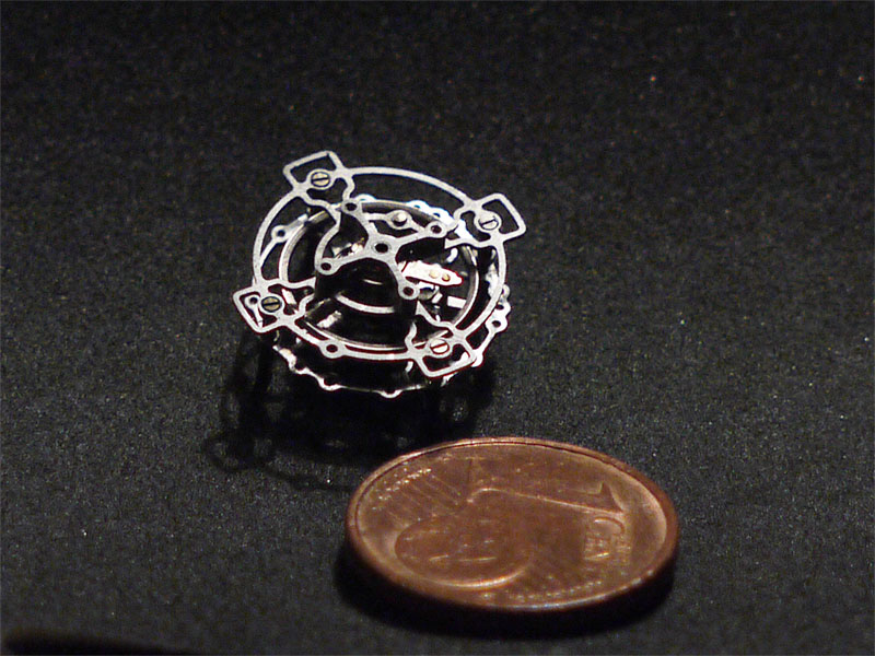

So I decided to buy a Swiss watch movement and started to make the environmental parts from Nickel free Stainless Steel and Brass and gathered my first experiences in electroplating.
Success raises ambitions, so I thought about the possibility to get smaller in parts and technologies and tried myself in producing watchparts for my own purposes…
inbetweenb
From visual to functional parts…
I know next to nothing about watchmaking. Did you cut all those parts by using the lathe as a milling machine by putting a mill in the spindle and mounting the stock on the cross slide? (Thanks for continuing to share this journey with us!)
Nope. First I bulit a router , then I built the small portable router with the big one (clip above). If you watch the hot wire CAD picture and virtually remove both the posts for the z Axis but add a gantry instead you have my big router. Then I used the big one to build the lathe.
Most above parts are done with the first big router, a few with the lathe.

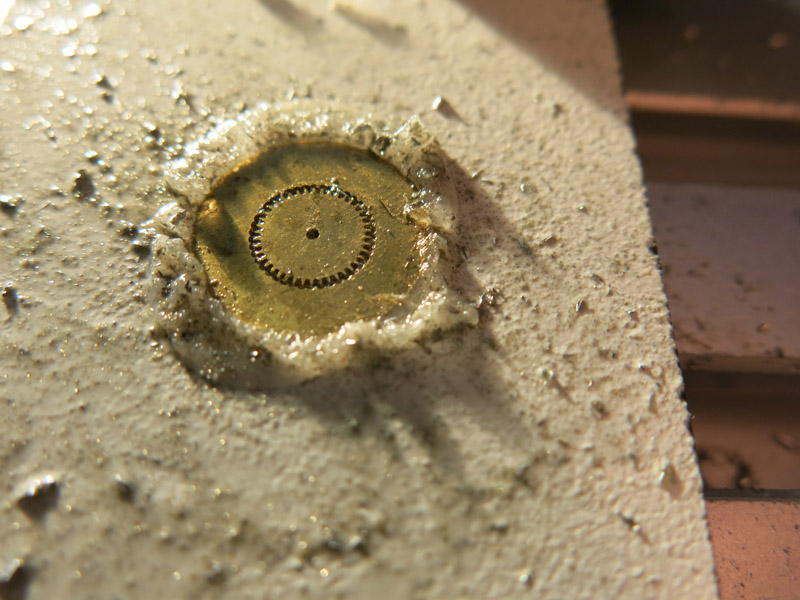

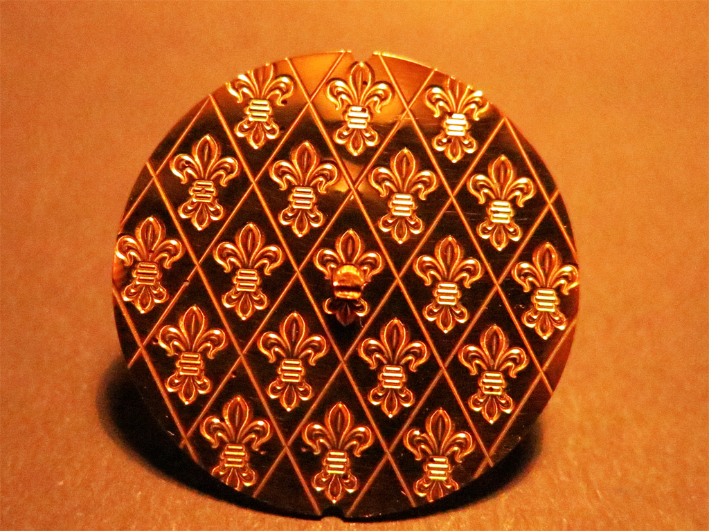

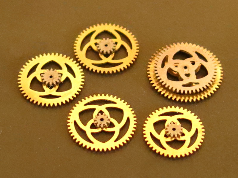

Mostly used tool for that parts is a 0.3mm flat tip shaft bit. Some engravers and bigger flat tips for the surface patterns the posts of that tourbillon in the last pic are syringe needle pieces threaded with 0.5mm from both sides. E.g. the gears are made using a 0.3mm shaftmill . The precision plained brass is fixed to a HPL lost stock plate using CA. The part is shaped and afterwards the CA is dissolved over night in Acetone…

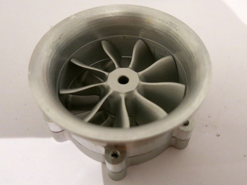

This is done in similar way but not from Aircraft grade aluminium but from cold working steel. Conceptual design… too heavy…
Very fancy parts can be done same way, routed half way from stock then refilled with CA (activated with mild tenside as it is an anaerobe adhesive which needs initators to crystallize on)
The dashes have a width of appr 0.08mm the screwhole is 0.5mm still embedded in CA to be dissolved

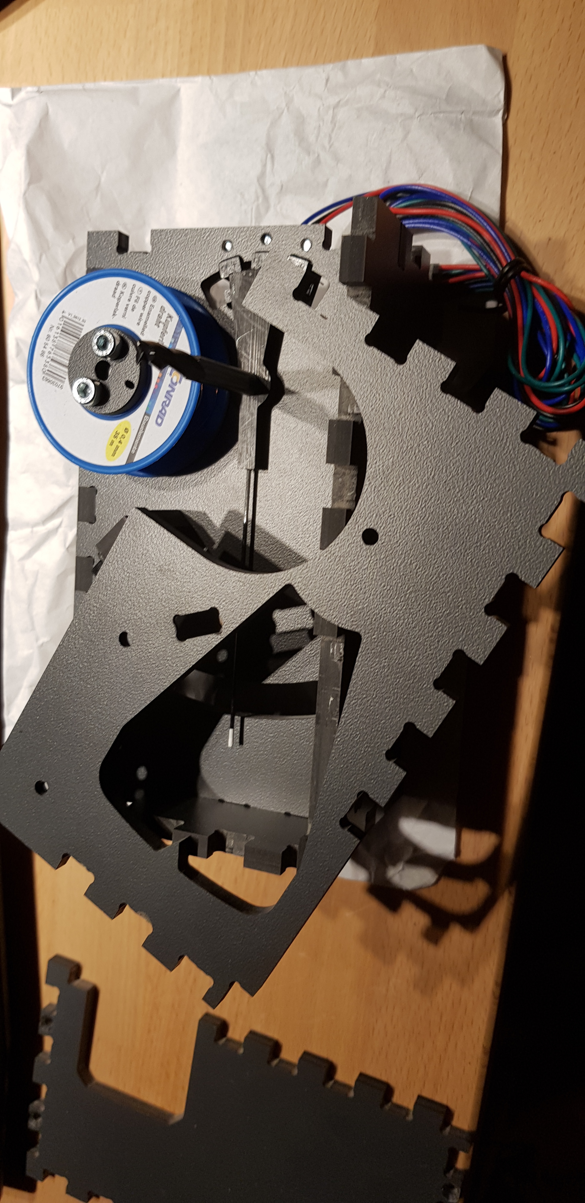

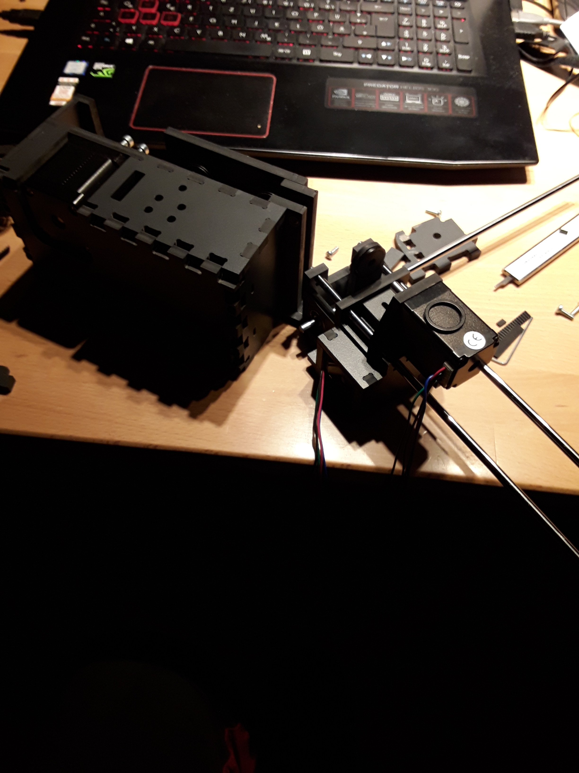

So I started buliding a coil winder…
First part is the wire auto support with someway a constant tension source.
( until now ist just mechanics but the uc boards should arrive by next week)
28mm Axis with the winding stepper motor
Shafts still have to be fitted / trimmed and the locking screw holes to be threaded …
Done…
Functional test with existing electronics and slightly too high current values ( did not want to adjust those)… done…
