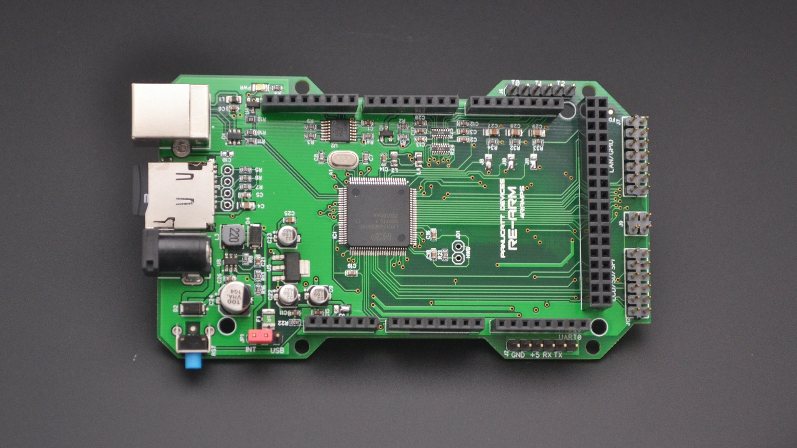

I have found there is a re-ARM project that is interesting - possible to combine RADDS and re-ARM? but I do not think it is possible to buy the re-ARM board yet.
