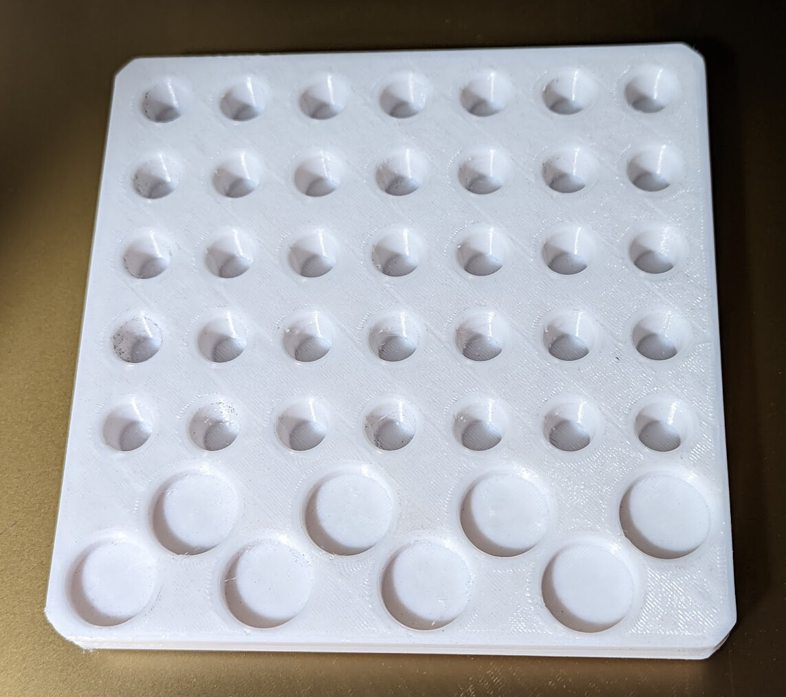

I already had a version of this tray that was 150mm x 160mm, so it wasn’t hard to imagine tweaking it to fit in 150mm x 150mm. I had printed that older tray in PETG, and wrote the collet sizes on the top with sharpie. PETG wicked ink from the sharpie, so I decided to print the new one with PLA to see whether that works better.
I succeeded!
But wow was that a rabbit hole.
Large flat dense objects without an enclosure and with limited bed adhesion warp easily in PLA. Waking up to this was a disappointment:
After several experiments, I determined that overhangs were curling up (regardless of cooling or speed I printed them at), and that “external perimeters first” avoided most of that curling and led to an almost successful part.
There’s no way that magnets in that lifted corner are going to snap into place in a grid. :sob:
Ultimately, I ended up cutting it in half and printing the cut halves on the bed for maximum adhesion, and got only a little lifting at the corners, but enough flatness to glue together.
Part of the rabbit hole was switching to the pre-release of Prusa-Slicer and using the Arachne perimeter engine, and another was that Arachne makes a 0.6mm nozzle make sense, so I swapped nozzles, which led to replacing the entire hot end up to but not including the heat sink and doing re-wiring.
And I still don’t know whether the PLA will work better as a writing surface after I sand/iron it.

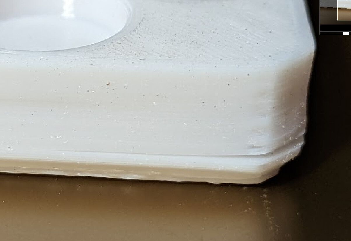

I glued the pieces together with CA glue, and here’s the worst resulting corner from the shrink-induced lift:

I printed two halves and glued them together back to back with CA glue.
It’s just that the corners on the thicker part lifted, and when I glued them together they weren’t quite flat.

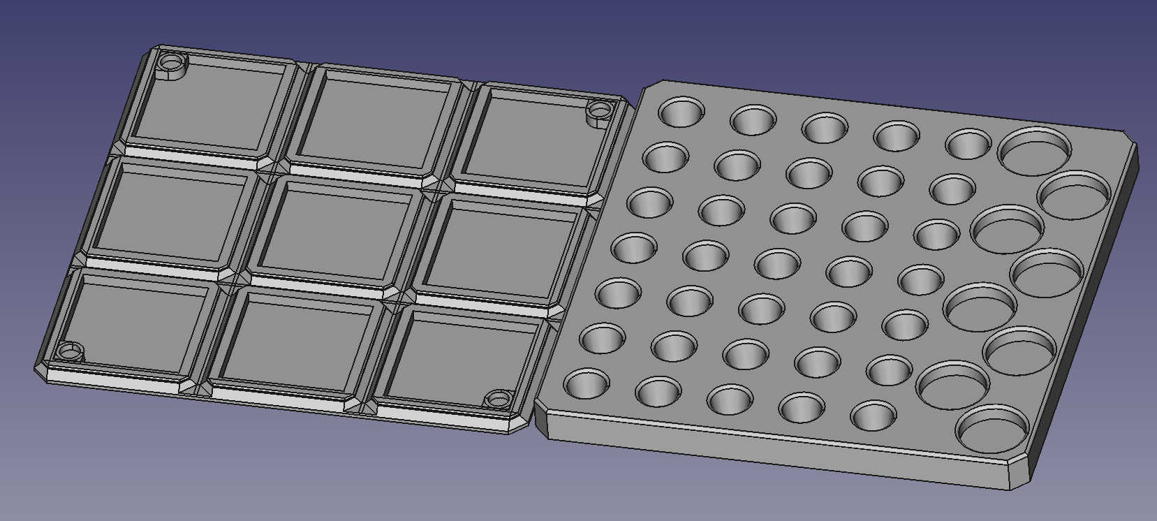

This is what I printed:
The corners of the thicker part pulled up slightly (around 1mm). I glued together the faces that had been on the printer bed. Where the bottom wasn’t flat, there was open space at the corners that I filled by friction welding.
? regarding which comment? I had understood when you said it wasn’t layer issue but was where you split the model. You said you’d split the model IN HALF and those were not halves so I figured it was a repair of one area where you had more bed adhesion issues. I get it that you split the model horizontally.
I did split it horizontally, as shown, in the model.
Splitting it arbitrarily in the middle of the collet holes wouldn’t be valuable; it could only reduce the surface for gluing and result in potential imperfect alignment inside the holes. When I split, I look for splits that will have minimum impact on the part; that’s my idea of being anal about splitting. :smiley:
