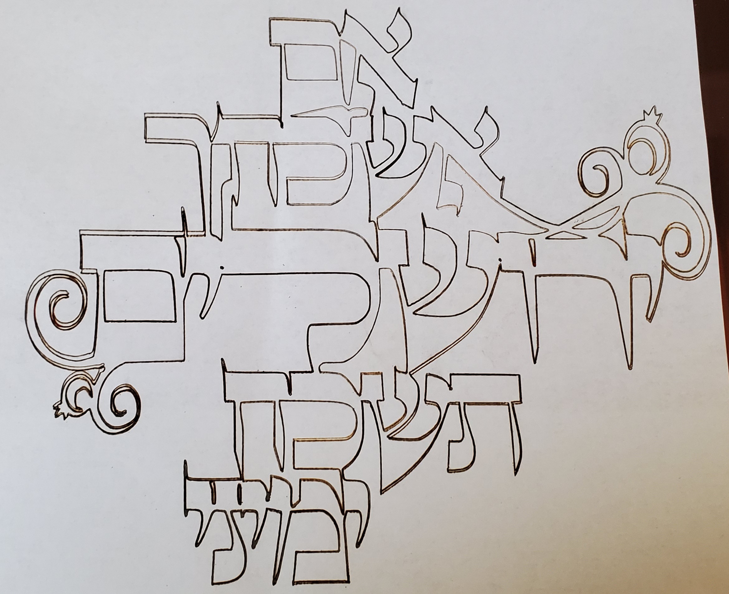

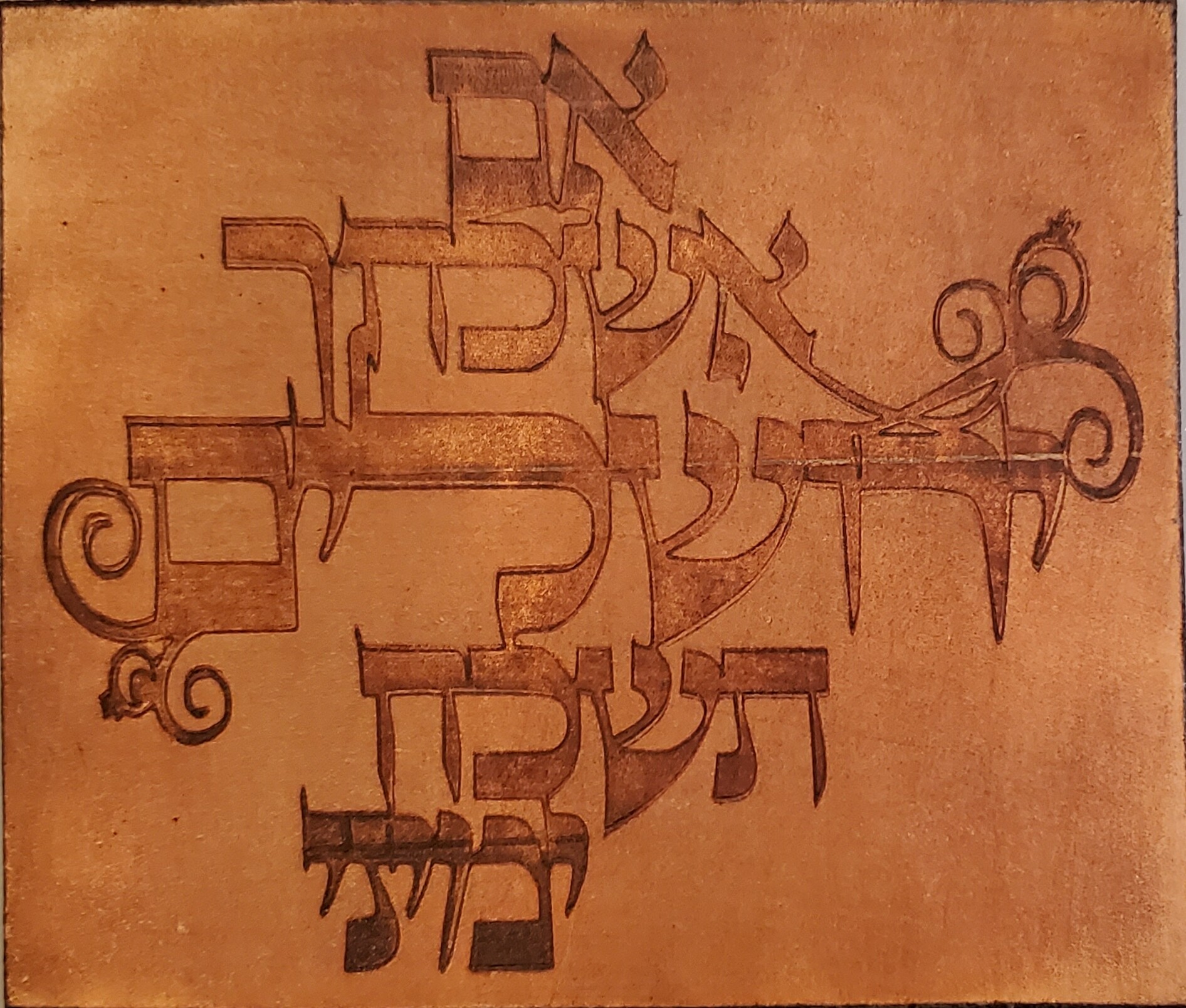

Thank you. I tested again on a piece of leather. The ghosted line is when the laser goes back for a second pass at something (not as in I told k40 whisperer to do two passes, it just does it itself). Is it possible that my stroke width is the issue?
Testing again
Raster engrave: 4mA at 100mm/s
Vector engrave: 4mA at 20mm/s
Vector cut: 4mA at 10mm/s (10 passes), 14mA at 10mm/s (1 pass)
I masked the whole area. Engrave went well enough. I was just testing it out. Even with all those passes, leather still wasn’t cut. Not a big deal. If I remember correctly this is pretty hefty leather (3mm thick I think). I cleaned with soap and water.
If it’s going back for a second pass it’s probably the file. If you post the file some of the K40 whisperer people can take a look.
It appears that you have 2 sets of blue lines in the image. Each blue line is actually composed of two lines that are offset from each other by the width of the lines. I think this is why you get a double cut. I’m not a strong inkscape user so I’m not sure how to tell you to fix it. @Jammy?

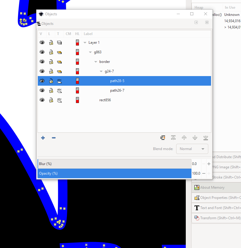

Ok, I think I got it. Had to select the outer line and delete it.
Thank you! I am new to Inkscape. I have illustrator but am more of a photoshop user. I will have to get this all figured out. Does the stroke width make a difference? I increased it so that I could see it more easily.
No, the stroke width doesn’t matter in K40Whisperer.
So I figured out to get inkscape to show me the objects in the file. Not very obvious Object—> Objects.
If the object window shows up on the right side group, click/hold/drag the object window from there into the middle so it’s a free floating window you can resize. Let’s you see all the objects in the file. In this case there was a double set of lines (path28-5) and a single line (path26-7). I deleted path28-5.
@NedMan that fixed it 100%. Thank you!
