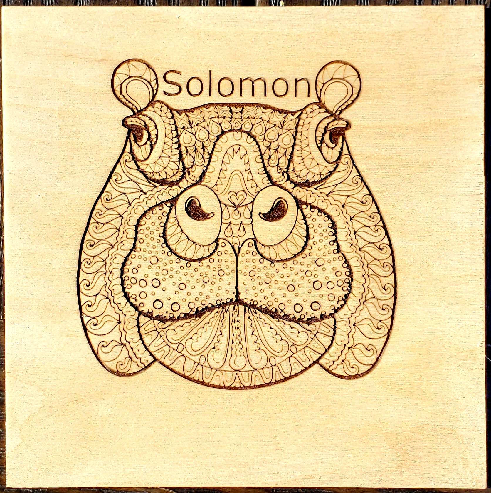

Here is my first complete engraving on Baltic Birch plywood. It is for my son, who loves hippos.
8mA raster engrave at 100mm/s.

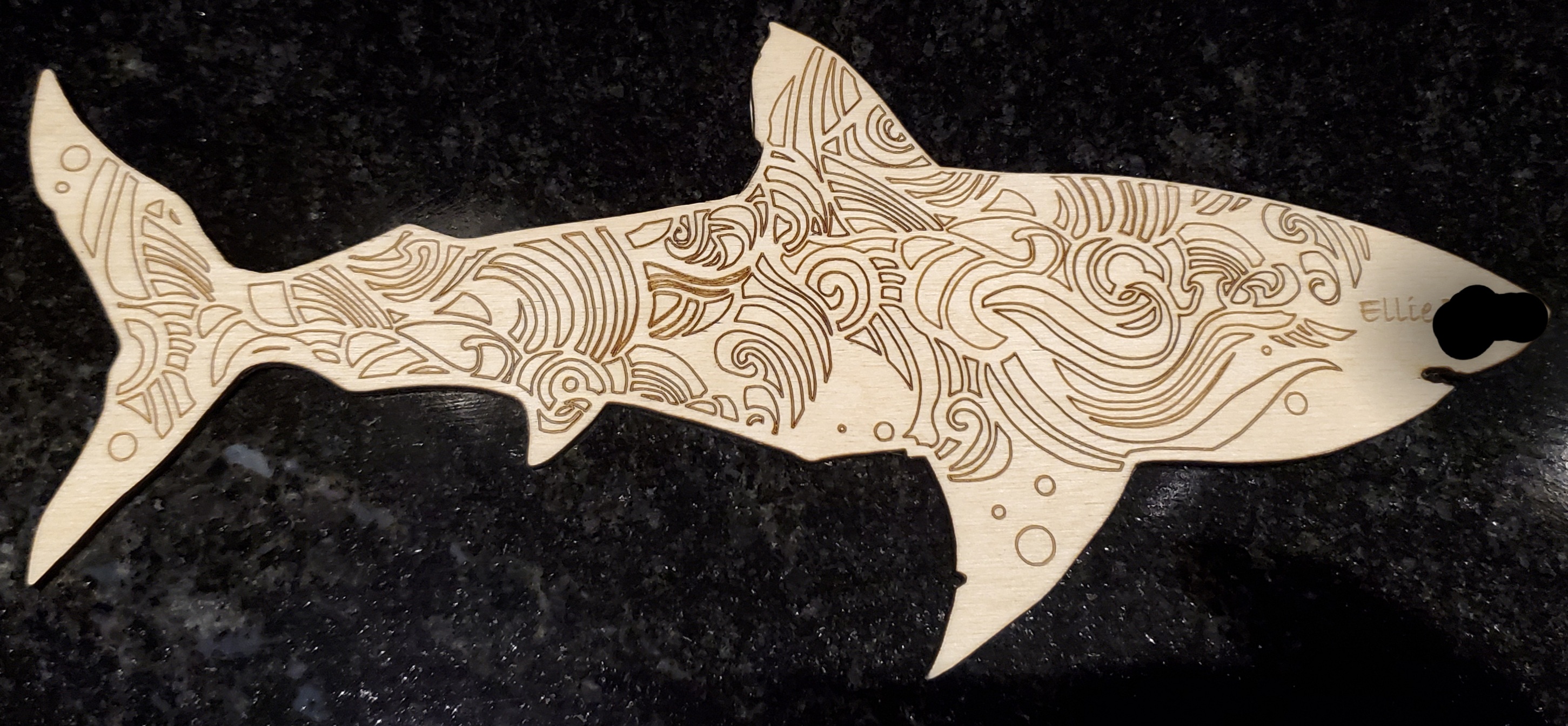

This one is for one of my daughters. I decided to vector cut it at the last minute. I had two spots where it didn’t quite make it all the way through. I should have let it go more but I didn’t realize it wasn’t cut before I took it out. Still turned out ok for my first time cutting plywood with the K40.
Looks nice. Are you getting the cutting done in one pass?
You will find that the glue in common plywood is not easily cut by the laser. Plywood can have voids filled with the glue that doesn’t cut easily. Usually just carefully trace it out from the back with a hobby knife. Get a brown sharpie and you can touch up the uncut area to match the cut area.
The engraving, yes. Cutting, no. I found settings online saying 40% (which is about 10mA for me), 10mm/s and 10 passes. I thought the power was going to be too high. I did 8mA for 10 passes. Not enough. 10mA for 3, still not enough. 14 mA for 3 passes. Almost done except those couple spots.

Is that 1/8" or 1/4" ply?
1/8th. I am guessing my material was above the focal point. I have the stock bed.
Ah, ok then. For 1/8" ply you should be able to to cut it in one pass at like 8ma and 10mm/s when you have the height set right.
To get the best cutting I usually set the height of the piece so the focal point is halfway into the wood.
I do not have an adjustable bed, sadly. Gotta figure that out. I like the idea of the spring adjustable ones.
