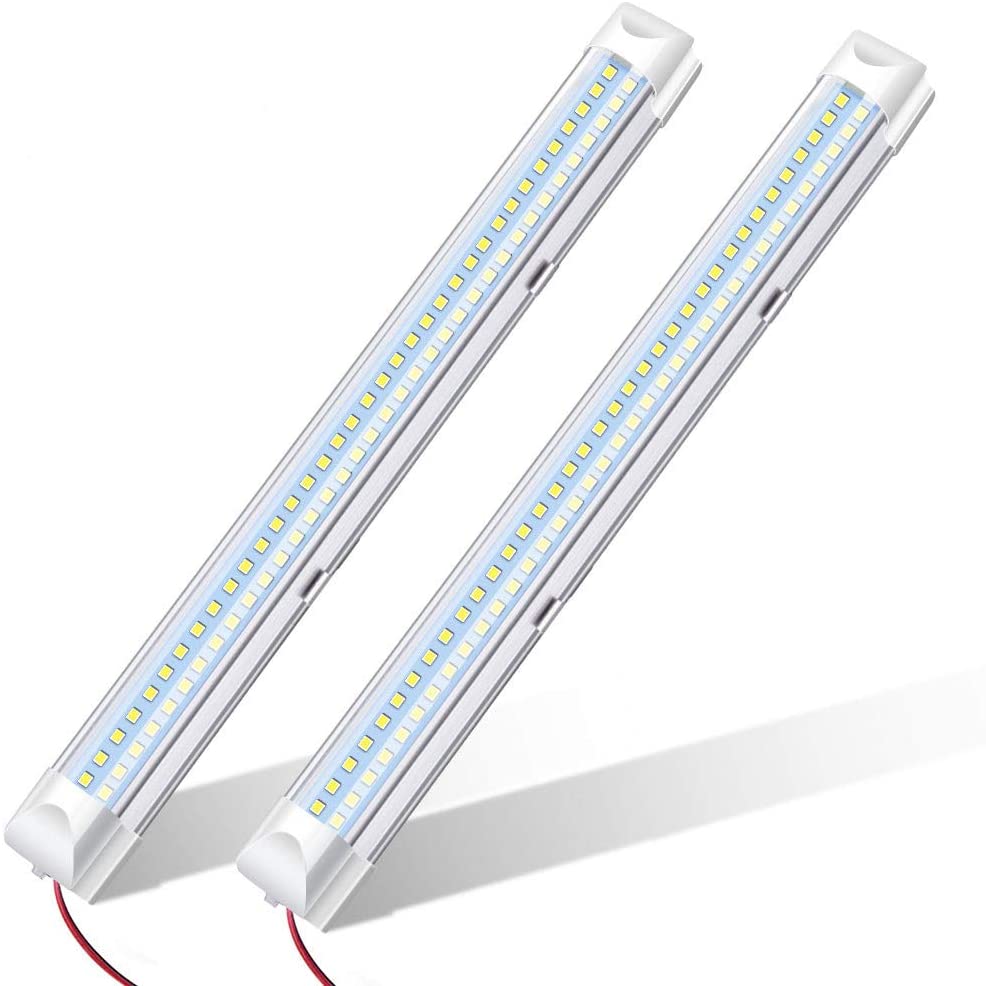

I am thinking about trying to add better LEDs to the interior of the cutting compartment. I need to see what kind of information I can find online about that. I have not messed with LEDs before. The entirety of my electonics experience revolves around amateur radio.
Pretty much any LED light strip will work.
There are many choices on amazon look for ones with the best customer scores and adhesive backing. I use 12v white.
You will need to decide what voltage you want for your accessories as you cant add any more load to your LPS.
I chose 12V for my accessories as most of the less expensive add ons (like gauges) were 12V.
I added a 12V supply (https://amzn.to/2LB4L4C) which are also pretty inexpensive with lots of choices on amazon.

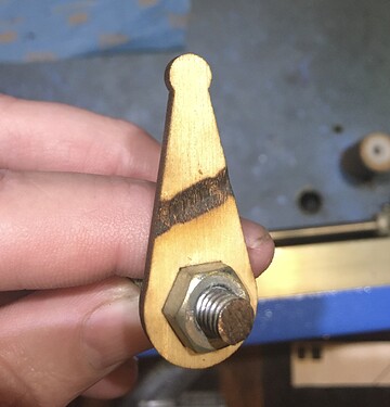

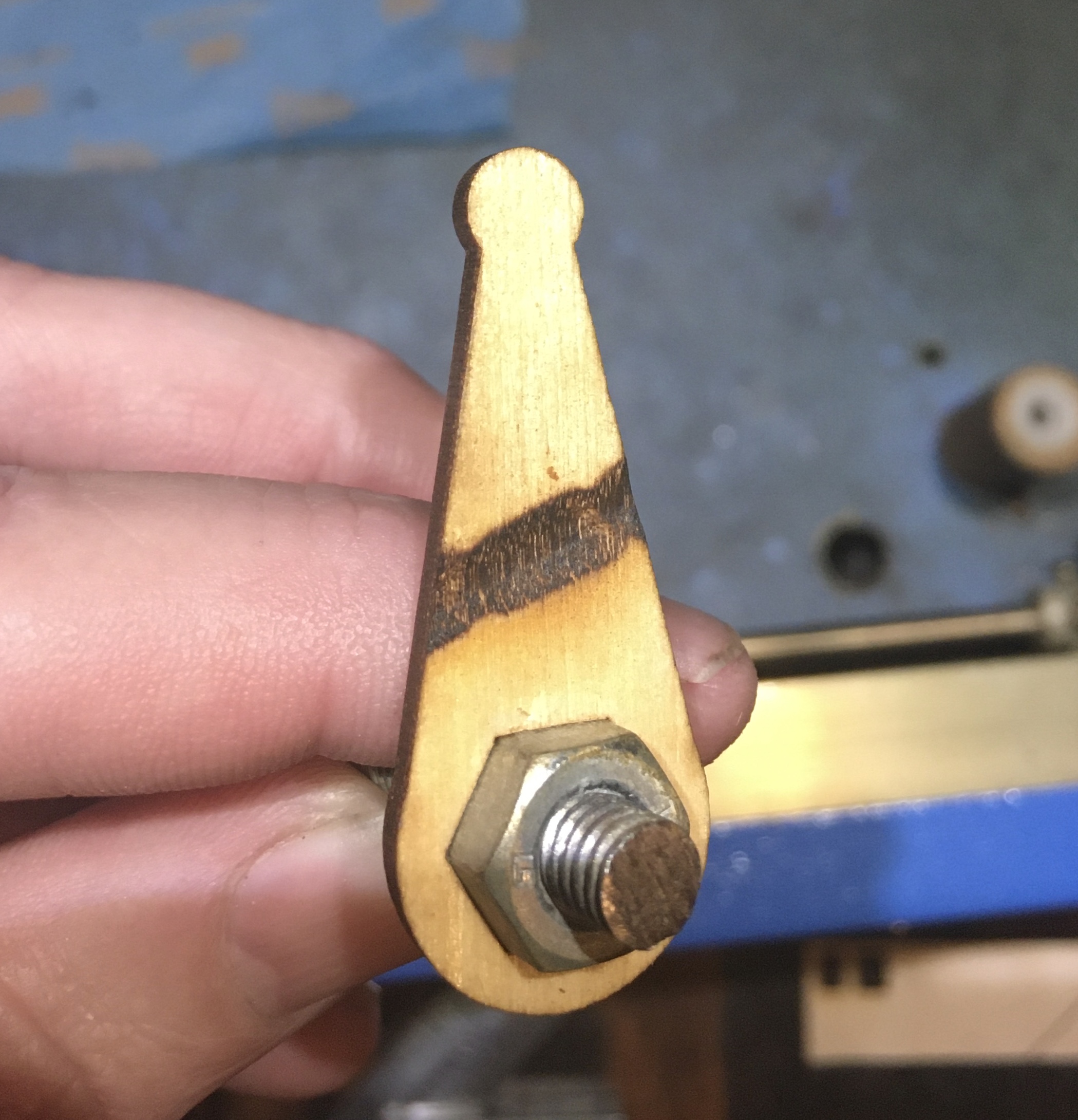

This sits about 1.5" under my bed on one of the supports. Was doing a bunch of deep engraving at high power and didn’t realize that I had miss measured the wood and part of the engraving was off the wood.

Thought of you and your compartment LED’s when this came up this am.
I have used these for other applications.
Thanks for thinking of me! Those things have a ton of LEDs. The one that came in the case seems to be very dim. Are they difficult to wire or is it similar to wiring in the mA or an interlock (in complexity, not the actual wiring)?
Just wire the black to negative and the red to positive 12V supply and then it will be one whenever the machine is powered. If you don’t add a 12V supply you can get 24V LEDs, or you can put two sets of 12V LEDs in series.
