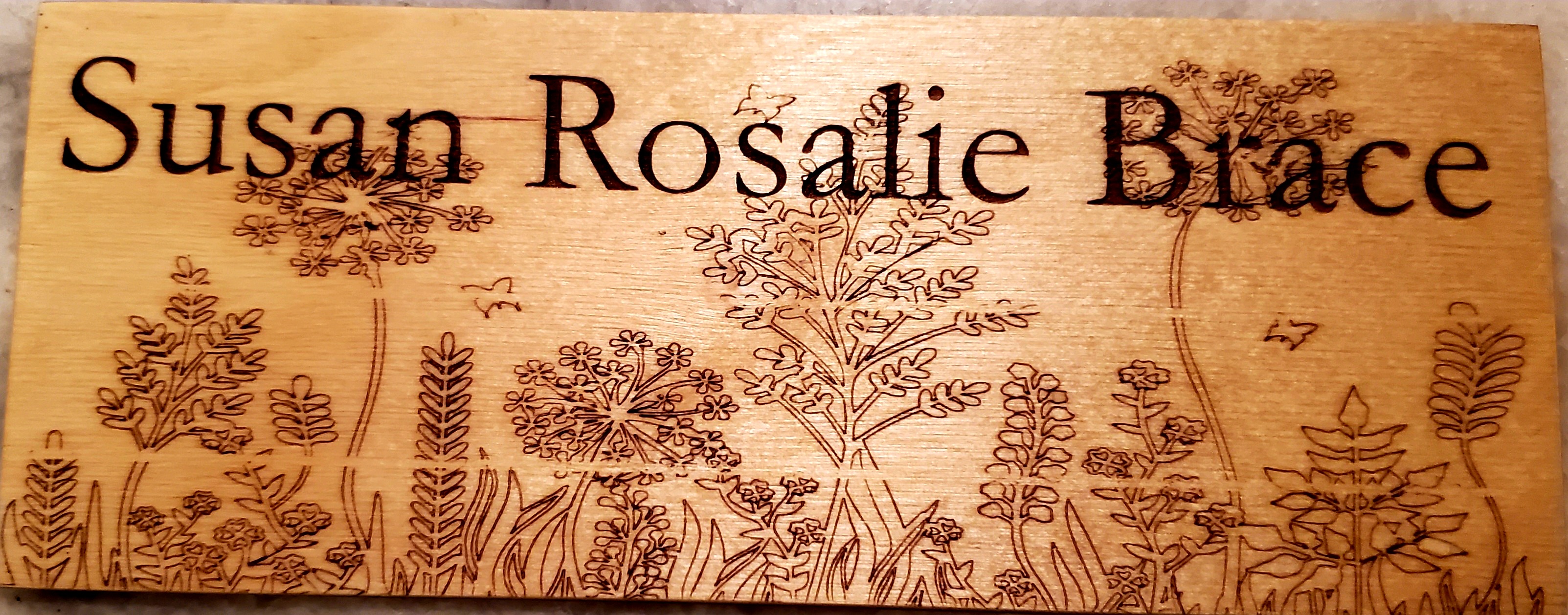

A project for my daughter, Susan.
One pass 3mA vector engrave at 20mm/s
Two passes 3mA raster engrave at 100mm/s
Finished with BLO.

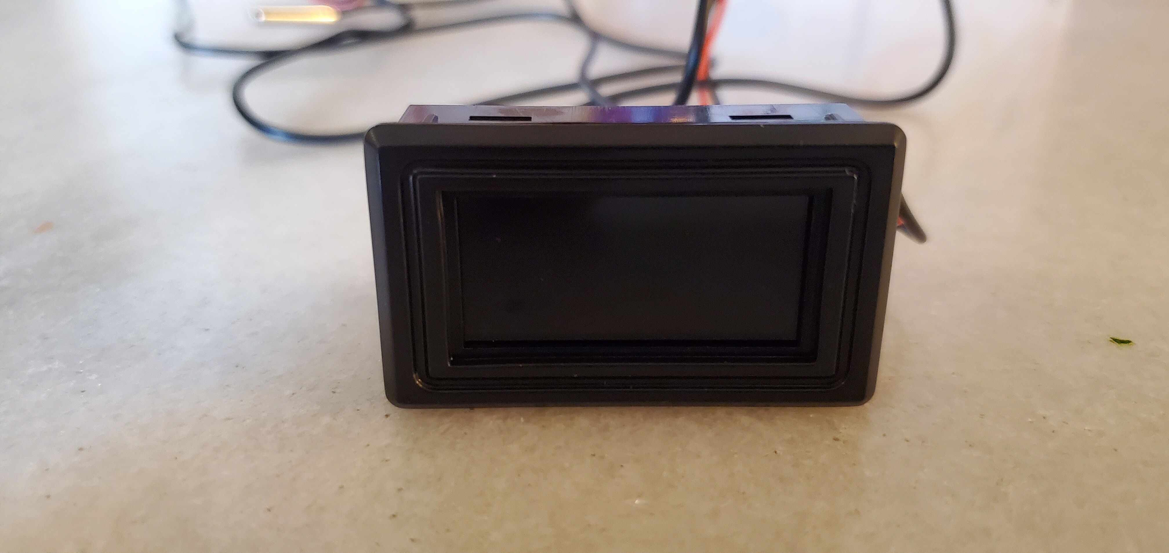

I bought a temp gauge for my coolant. Can I snip the red and black pair and wire them into the psu? Not quite sure how to do it.
That gauge is either 5V or 12V, and your PSU has 5V and 24V available. If the gauge is 5V you are OK to tie it in to the 5V rail of the PSU as it does not draw much current. But if it is 12V you will require a separate power supply for it.
Looking at the picture, it appears to be connected to the 5V lines that would connect from a PC power supply, the yellow line is the 12V from a PC power supply.
Can you point us to the specs for that temp meter?
With more information we can be more specific.
I would not load down the 5V of the LPS any more, it is already running at a marginal level.
