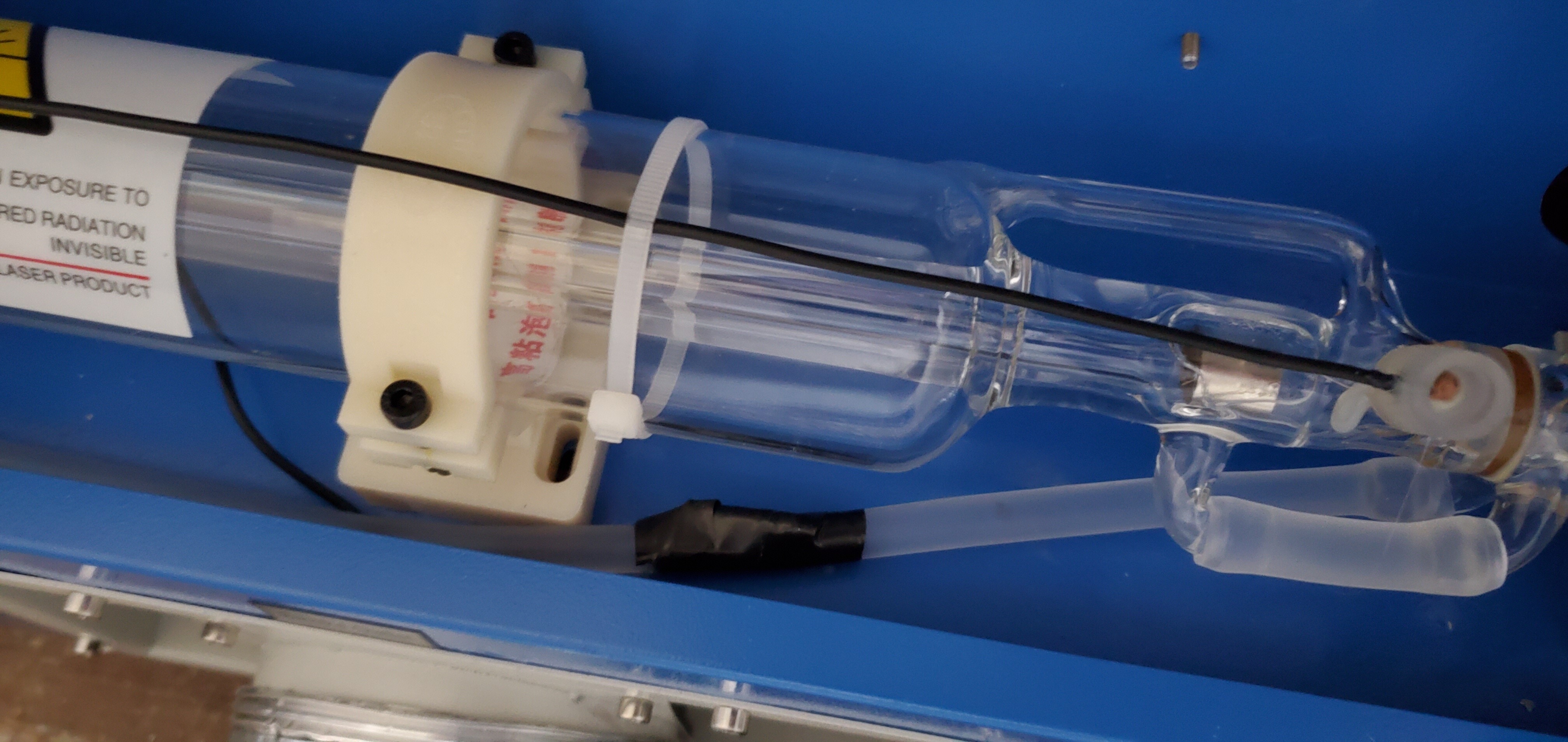

My machine came with a temperature gauge but no indication of what temperature it is displaying. I traded the eye that and discovered that it is attached to the cooling discharge line. Not sure how accurate it is with it being tied to the silicone tube but it’s better than nothing, I guess. So working on putting the sensor in the cooling tote. After two hours at 14mA, my water only went up three degrees C. I check with a temperature probe by hand.
The thermocouple attached to the outlet water hose is typical stock placement in K40s. Seems to reasonably accurate in my experience.

This method seems overly simplistic and not very accurate but then again I have not looked at the thermal conductivity of silicon and done the math. I don’t plan on doing so either cause some things just don’t feel right.
Silicone Heat Resistance
…Silicone has a low thermal conductivity, which means that it transfers heat at a low rate compared to other materials. This low thermal conductivity can also be described as high thermal (heat) resistance. In addition to simply resisting heat, silicone also exhibits thermal stability, or the ability to maintain its properties and structure over a wide temperature range.
… a typical unfilled silicone rubber has a thermal conductivity of approximately 0.2 W/m·K and even a highly filled silicone elastomer can barely exceed 0.4 W/m·K.
This machine has been moved to the garage. I have used these HVAC ducts for years and they have held up mechanically. I cannot advise on levels of contamination as I don’t use the machine that much. This approach eliminated having to do any sheetmetal design.
I like that I can easily remove the corrugated duct and move the machine.
I have the original temp probe on the outlet tubing and one in the bucket. Didn’t think about the thermal conductivity of silicone tubing being that low, but I’m not using silicone tubing personally. I guess it would be better to put it directly against the laser tube?
I have on in the bucket and one on the tube surface but do not remember the delta.
I just was curious about the temp on the tube surface. I planned (but never did) to add a fan to the laser tube compartment.
Your setup would tell us what the temp drop across the water tube is.

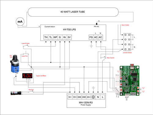

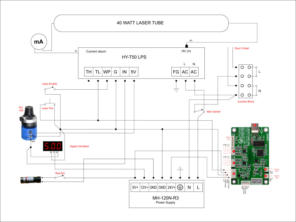

I bought a Mean Well RT-85D today. I will figure out how to install it now. @donkjr or @keen do you guys know of any guides on how to do this properly? I have never messed with this kind of PSU before.

Is this the kind of thing you are trying to do? Just the DC supply part. I think this is a different LPS than yours
See this thread:
