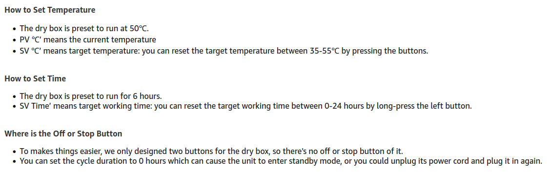

The user interface is primitive at best. On the Amazon page, I see this:

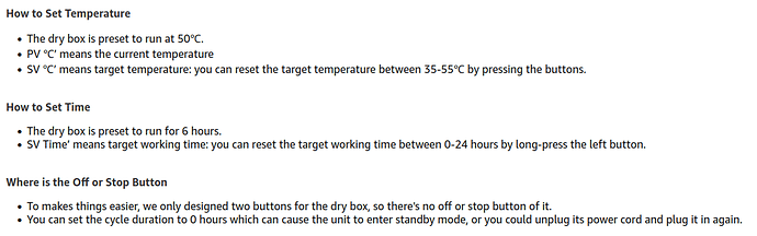

Fixed it for them:
To make things easier for us, we only designed two buttons for the dry box and didn’t bother to put any labels on the buttons or even put instructions on how to use the buttons into the package.
The useless pictographs that ship with the unit don’t actually explain how to use it. There’s a QR code for the full manual, which is a 103MB PDF of… the useless pictographs that ship with the unit. Argh.
Sunlu’s product page says:
Click right bottom [sic] to set heating temp; Press the left bottom [sic] for 3 seconds to set heating time. (PV means the actual heating temp in the dryer box; SV means the temp you set)
The only way to turn it off is to set it to zero hours and wait an indeterminate amount of time, or to unplug it and plug it back in.
Love thing where is says “To make things easier…” when they really mean “cheaper”. :grin:
