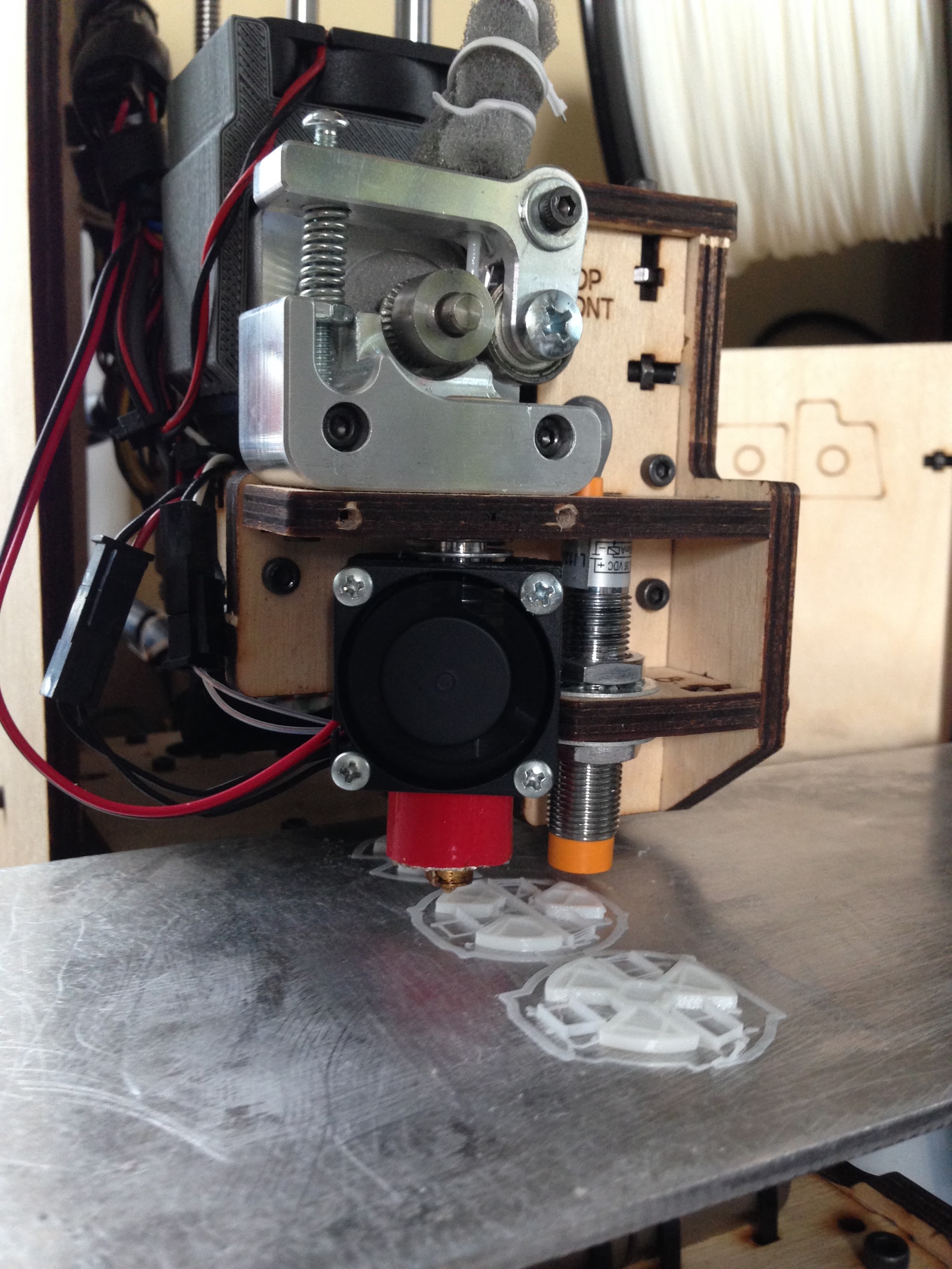

My Printrbot 1405 with metal extruder and new-style Ubis hot end.
My Printrbot 1405 with metal extruder and new-style Ubis hot end. Fancy optional oil dispenser newly added on top of extruder, seems to be doing the trick.

There’s very little oil there, but that occurred to me as well. Dunno. I’ll see how the test prints turn out!
My brother suggested it - says he does a little lubrication of the hot end with every filament change. @Nathan_Ryan want to jump in here?
I have been dipping the tip of my filament in canola oil everytime I change the filament and in 2 weeks had not had any jamming issue.
I’m using canola here. Now my printer smells like french fries, so I guess that’s win-win?
@Andre_Courchesne1 I do the same. I’ve seen the oiling sponges but haven’t used them. Just dip the filament end in veggie oil a couple cm.

Emmett, of thingiverse fame, oils with every print. A little square of paper towel and a zip tie. I saw it on his Printrbot Simple at maker faire :wink: can’t argue with Emmett.
@Dat_Chu Some filaments seem prone to jamming. It seems to be a heat issue, but since I’ve already got multiple fans - on the extruder motor, on the hot end, and directed at the work piece - there didn’t appear to be many other options. A bit of a Hail Mary, if I’m honest - but it worked! So I guess @Brook_Drumm is right to trust Emmett! :slight_smile:
@Branden_Coates I don’t see any problem with layer adhesion at all. It seems like there’s little enough oil involved that the parts aren’t really affected. They’re certainly not greasy to the touch, for example, and I can’t detect any reduction in strength.

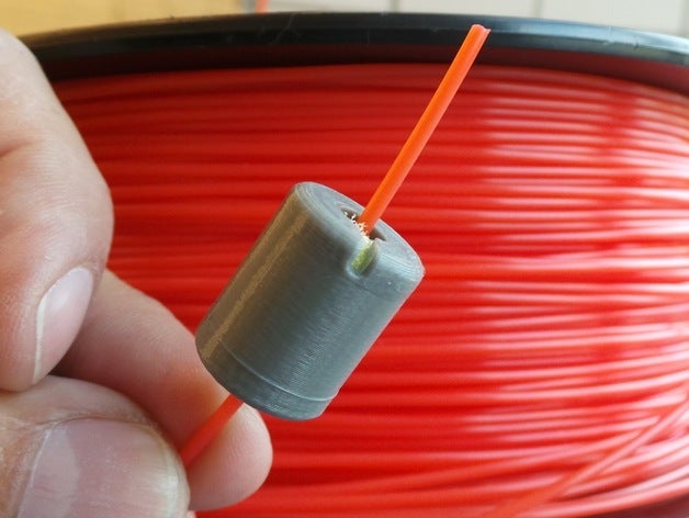

Given the fact that I’ve seen at least three different rolls of filament that exhibited a tendency to jam before I started doing this, and resolved it with a little lubricant, I’d say it’s now going to be part of my normal routine. I printed a little box to hold the foam and thread the filament through. Easy enough to do, with an occasional oil drop, as part of the process of changing filament.

@Dat_Chu They’re small enough to ride on the filament without being attached to anything. Mine floats about the extruder inlet, occasionally resting on it, occasionally bobbing around above it. I can’t find the two part one I printed, but this one actually looks better:
