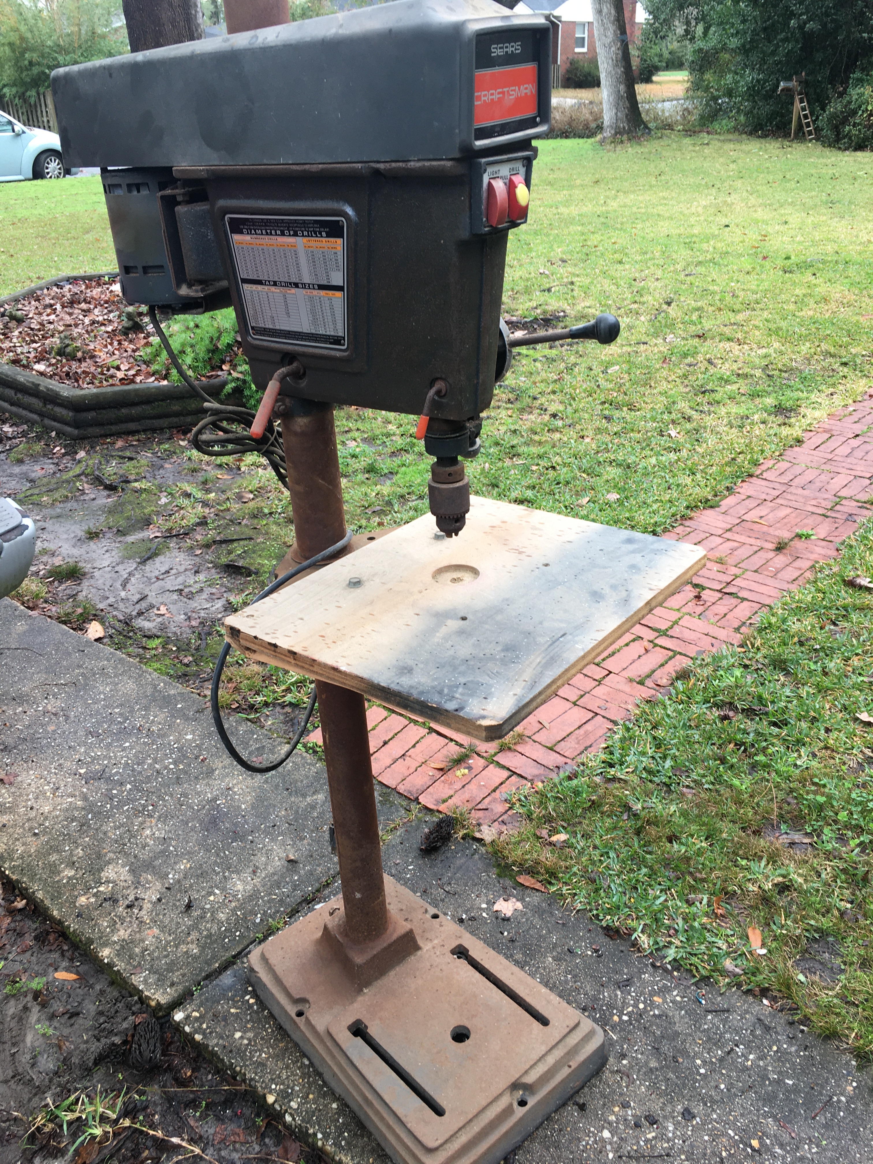

Well not that I needed another tool rescue project but at $20 I couldn’t turn down this drill press I found on Craigslist. It’s a Craftsman 15-1/2" model 113.21371 drill press with a 1/2 hp motor. probably dates to the late 70s. The guy I got it from was cleaning out the garage from his recently deceased father and just wanted the stuff gone. Runs and the bearings seem fine; will need a new belt though.

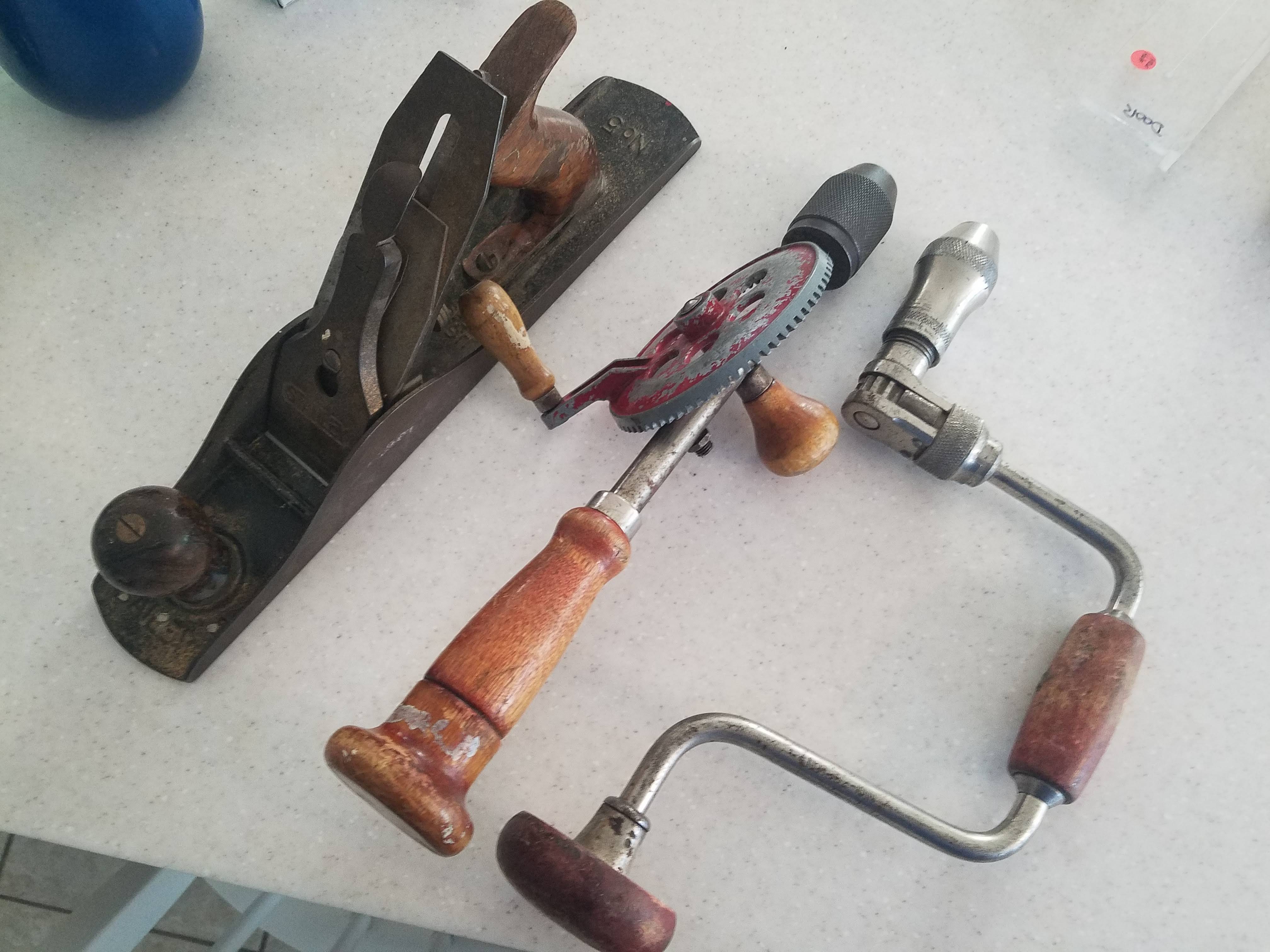

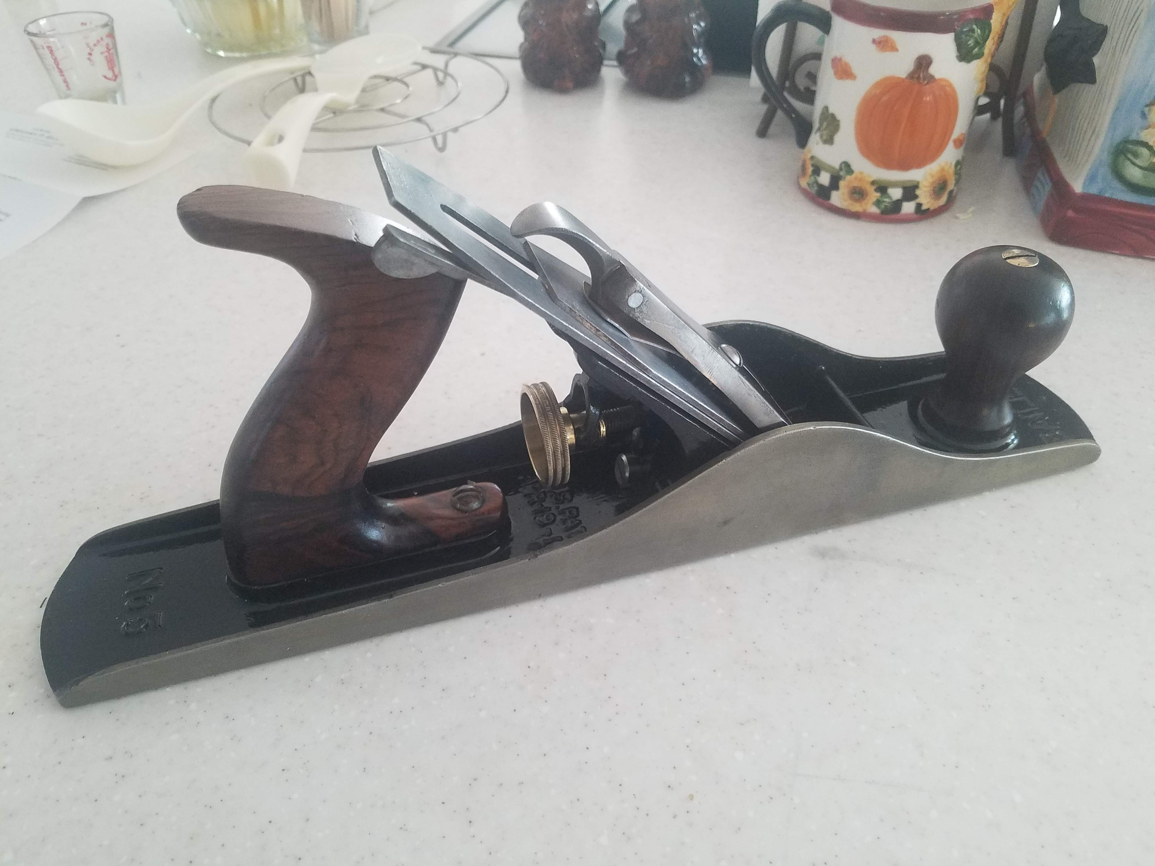

Try vinegar and steel wool first as it can be easier on the surface than the brush.
Recently I have restored planes that way and was happy with the results.
OMG what am I doing telling a chemist what chemical to use…
It’s sad to say,) but nowadays when crafstmen pass their family members do not appreciate their tools and virtually give them away.
Last year I got a set of stanley hand planes for free and a brand new planer for 1/2 its value.
Sad but true…

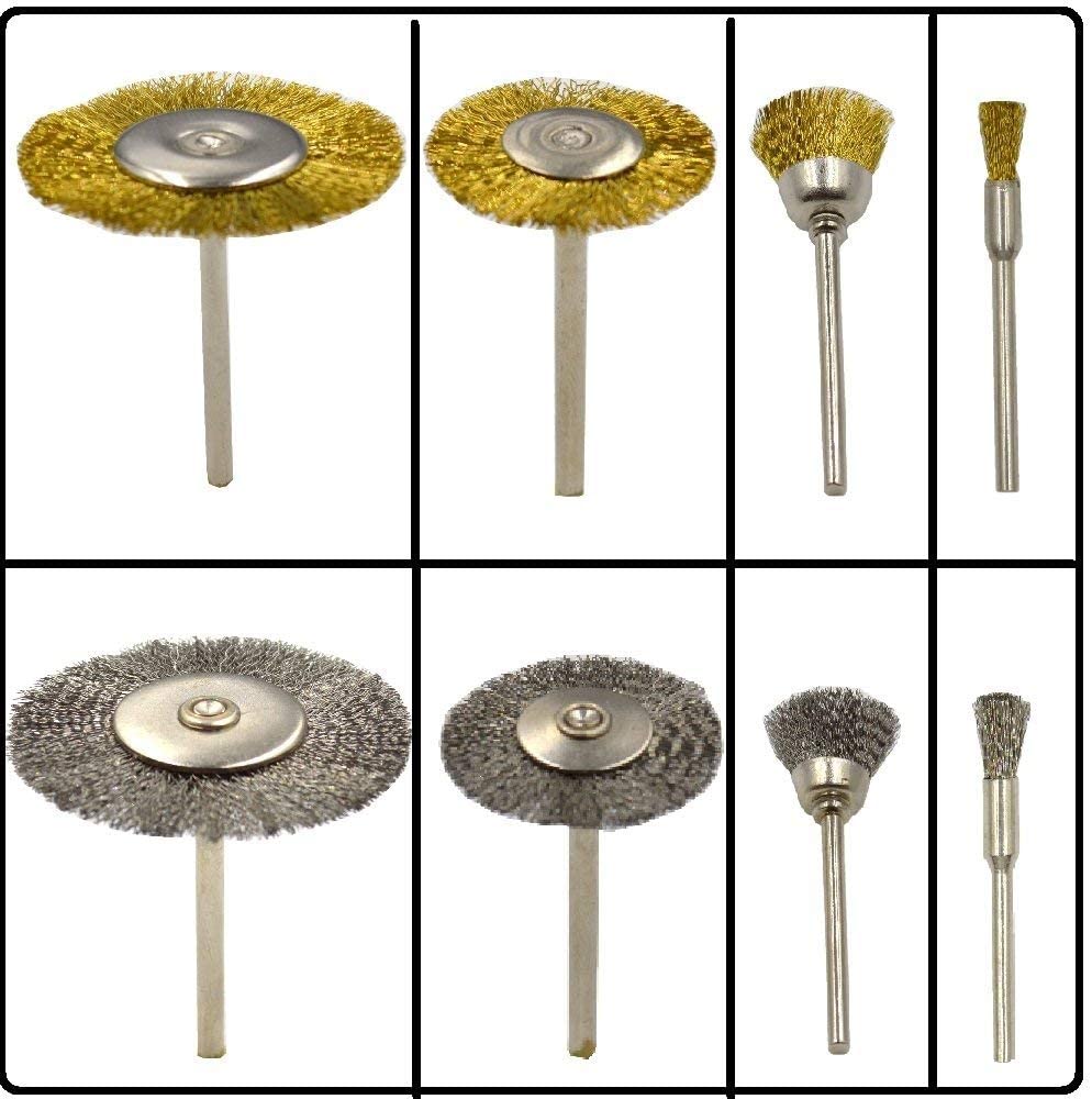

Recently purchased a set of wire bushes for my rotary tool from Amazon. I think these will end up coming in handy for the restoration. Great price with decent quality.

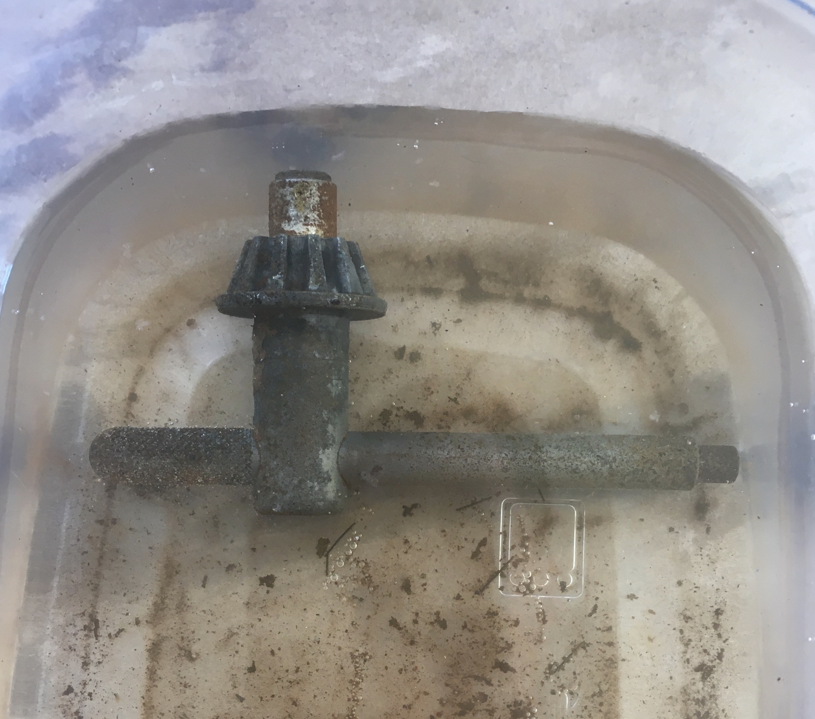

Haven’t been able to really start on the restoration yet, but I did get small piece done. The drill chuck key.
It was fairly rusted but I soaked it in vinegar overnight.
Used wire brushes on my rotary tool to get all the remaining rust off. Left with a uniform gray color.
Needs to be smooth as reasonably possible to help minimize corrosion potential. Did some grinding to get rid of a lot of the pitting, sanded with various grit sandpaper and then buffed with some polishing compound.
Treated it with some gun blue and then some light machine oil to give more corrosion protection. I’m happy with the results.

Just wish my lathe was big enough to mount the stand pole to make it easier to clean up.
Hmmm. I think I have a small motor I could rig up to make a pseudo lathe for sanding and polishing. :thinking:
