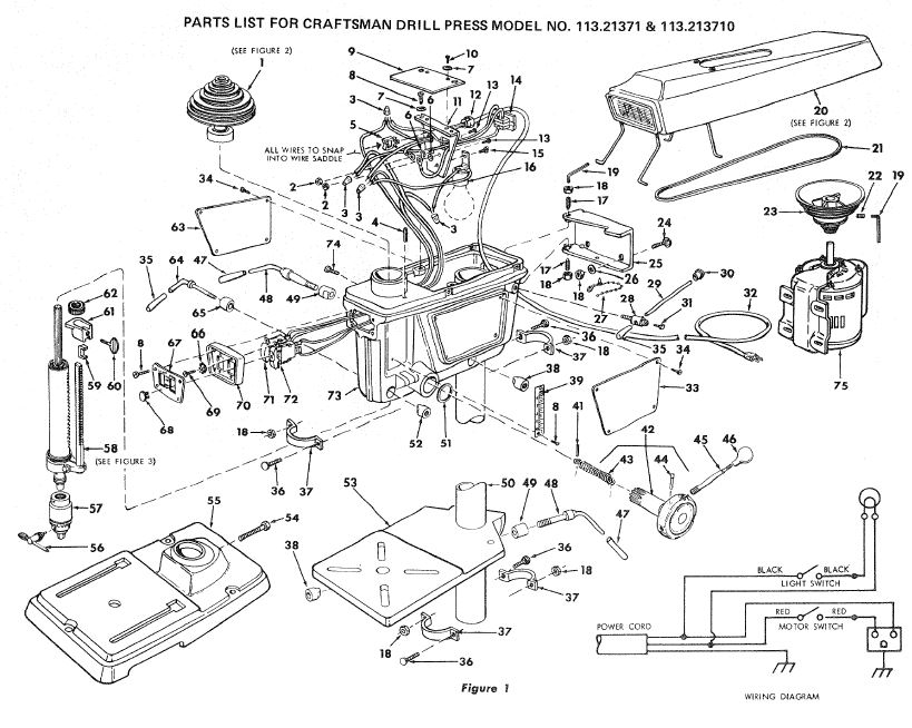

Slowly working on disassembly. Thanks to the internet, and the love people have for vintage Craftsman tools, I was able to find a copy of the original owners manual. Complete with exploded parts diagrams. It’s made the disassembly a lot easier.

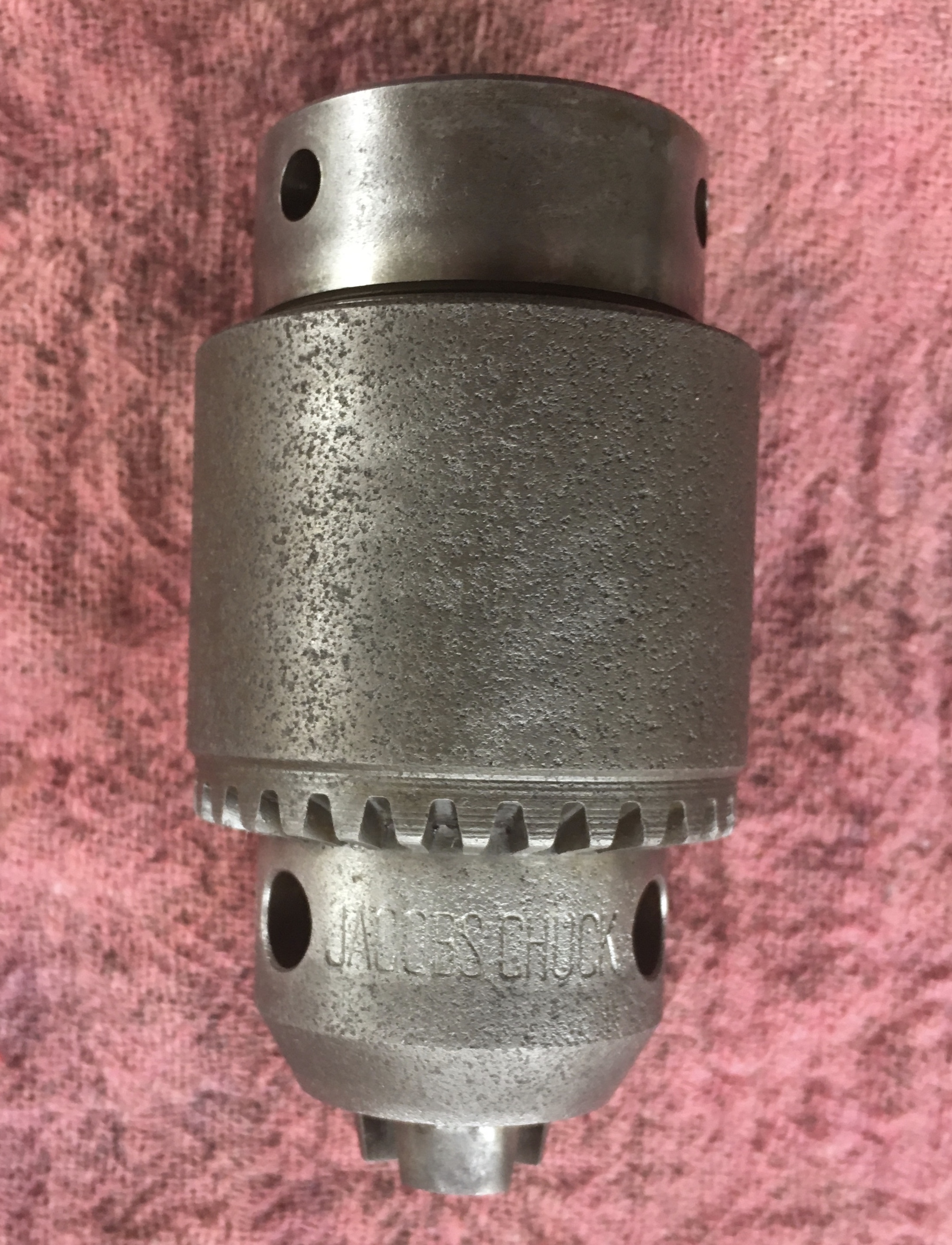

Been slowly working on derusting the parts in batches and went to look at starting the process with the chuck. Sprayed some liquid wrench on it and went and got the chuck key, that I spent time restoring, to see if it would move at all. Lol the key didn’t fit :laughing:
The pilot hole in the side of the chuck is 5/16" while the pilot on the chuck key is 3/8". Should have spent more time looking around that old shop because there had to be another chuck that this key fit. Oh well just another $11 for a new key. :roll_eyes:
Does the tooth profile match? Maybe you can turn the pilot down to size? That might be fun…
Not sure. The chuck is setting in a vinegar bath at the moment. Don’t have a metal lathe currently, on the wish list. Would probably be “fun” to get that mounted in a 3 jaw lathe chuck though :wink:
That’s what 4-jaw chucks are for! There’s enough slop in the teeth that it wouldn’t need indicated in to a tenth…

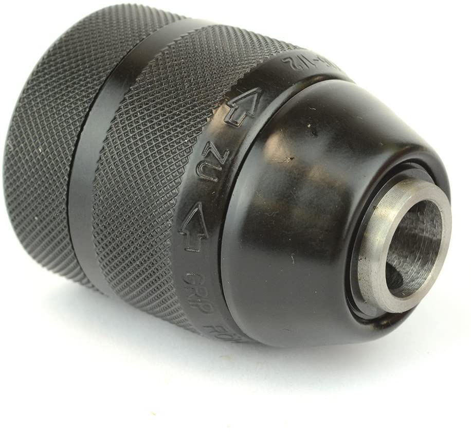

replace the chuck with a keyless chuck, don’t know if you can find one with the right thread.
Hmmm hadn’t considered that, would be a lot nicer. Thanks for the suggestion :slight_smile:

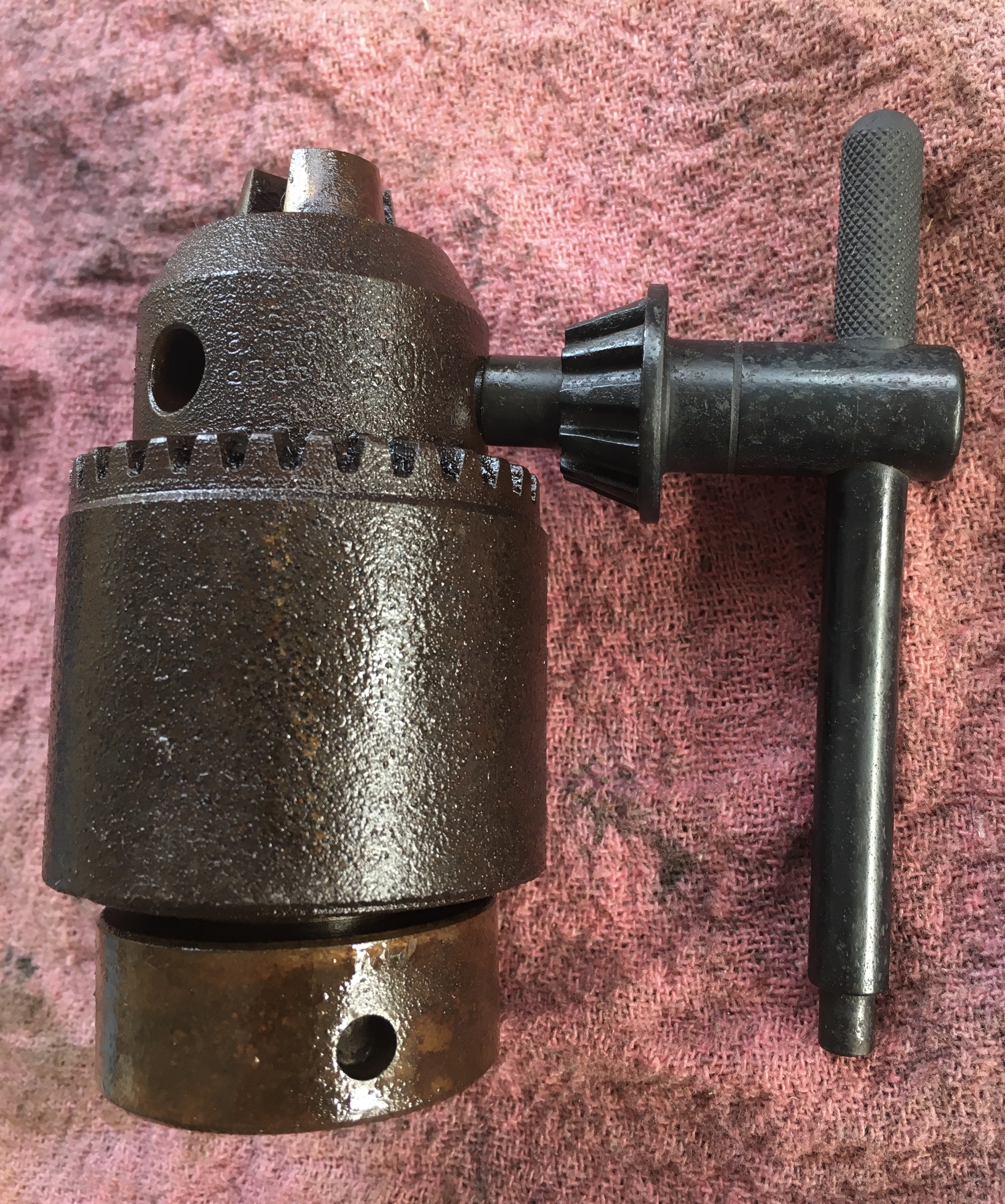

Got it derusted. Hot soapy water scrub down to remove oil. Vinegar bath overnight followed by wire brushes on dremel. Sodium bicarbonate (baking soda) bath to neutralize residual acid, water rinse, dried in toaster oven at 200F to drive off residual water and then oiled. Works just fine,
Still will need a sanding and polish. Would like to take it apart to fully clean and regrease, but I need to see if I know anyone with an arbor press I can use to get the outer collar off

Yes a keyless chuck…

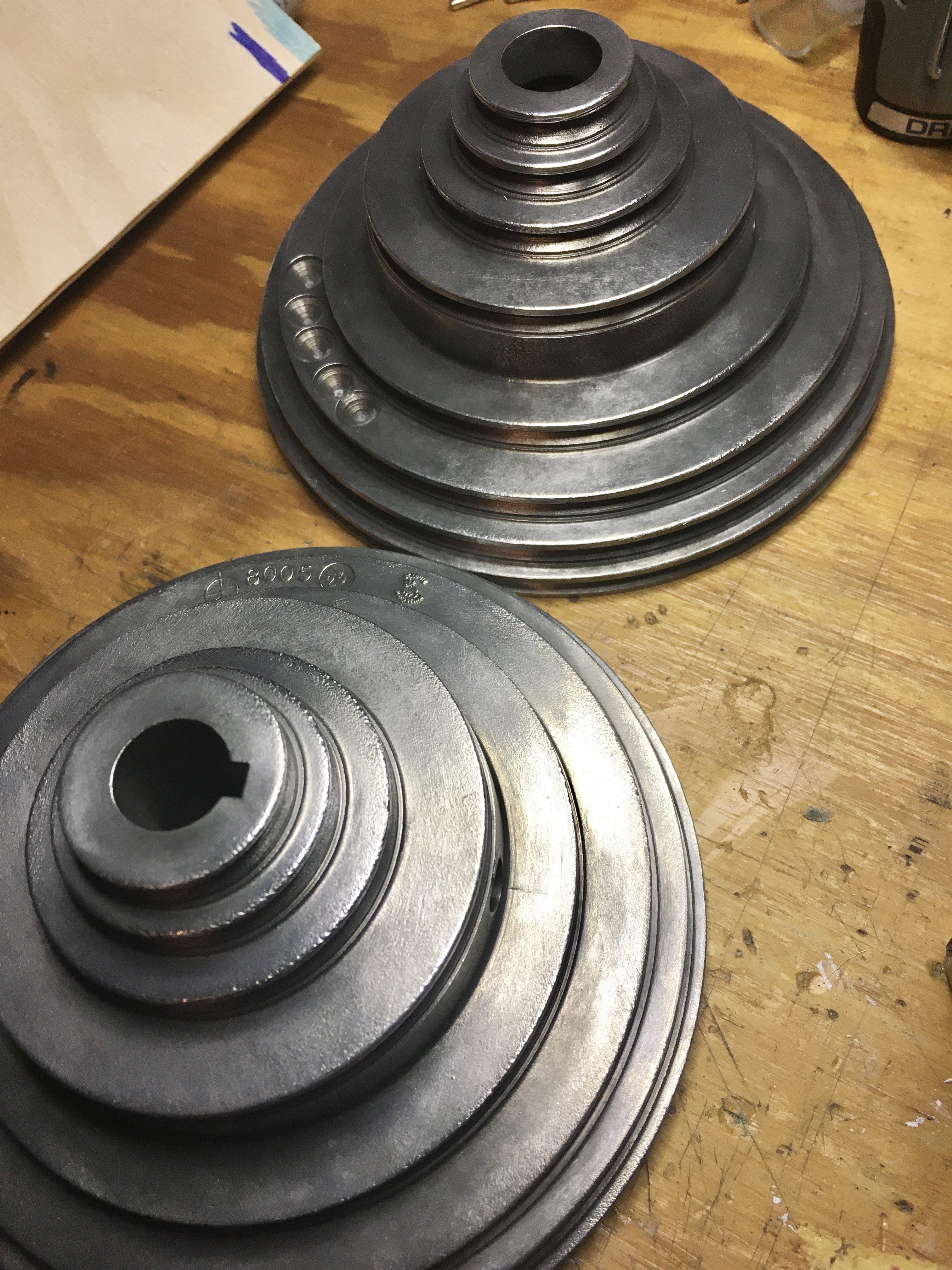

Today’s project ended up being the aluminum drive pulleys. Used wire brass wheels followed by a buffing wheel on my bench grinder to clean up the powdery oxide. Cleaned up nice.
Looking good Ned.
