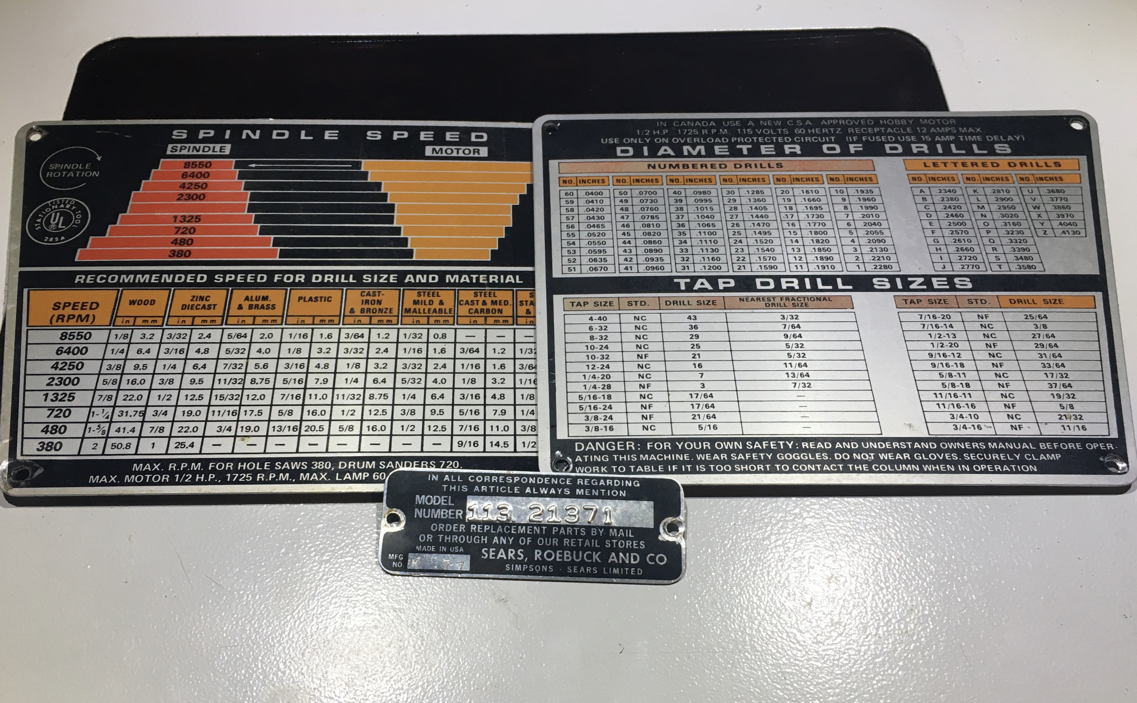

Busy weekend with other things, but got the aluminum info plates off the side and the rear of the head. This is so I can do the derusting on the head. Was kind of a pain in the ass because the plates were blind riveted with hardened steel rivets. None of my drill bits were up to the challenge of drilling them out, so I had to carefully grind them off with my rotary tool and grinding stone bits. But got them off with minimal damage.

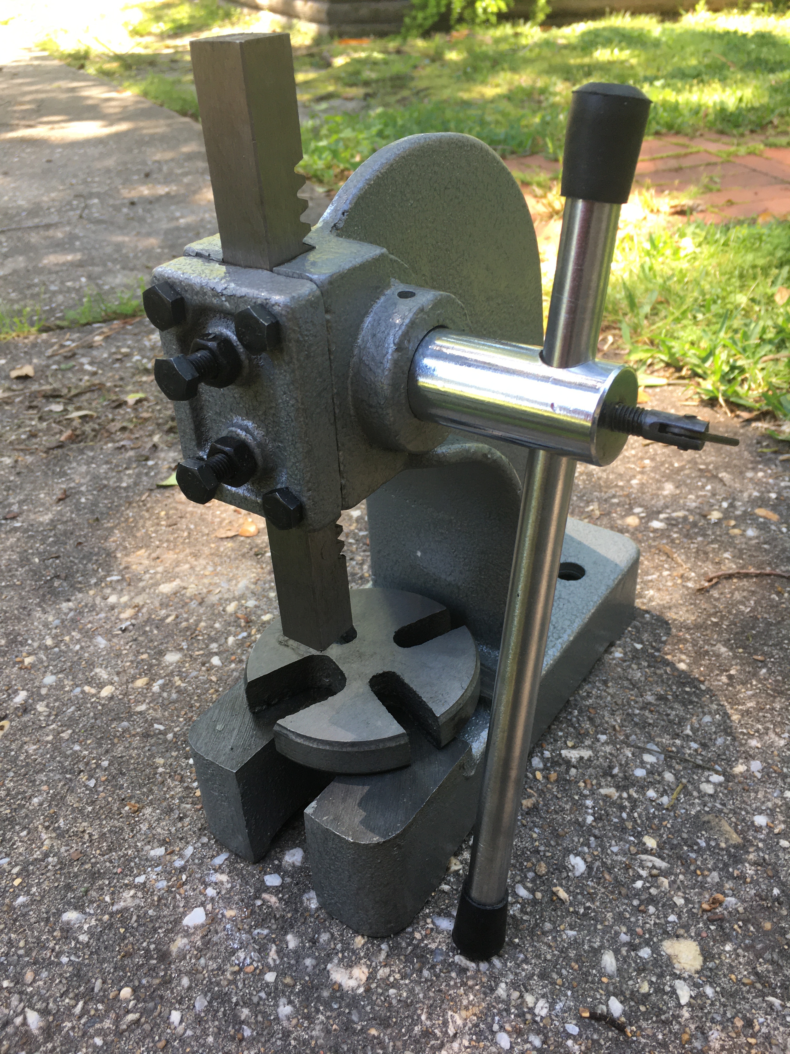

Well it seems I’m back to working on this restoration. Wanted to get / borrow an arbor press to disassemble the chuck. Had a saved craigslist search going and today I scored a basically brand new $60 Harbor Freight 1 ton arbor press for $15.

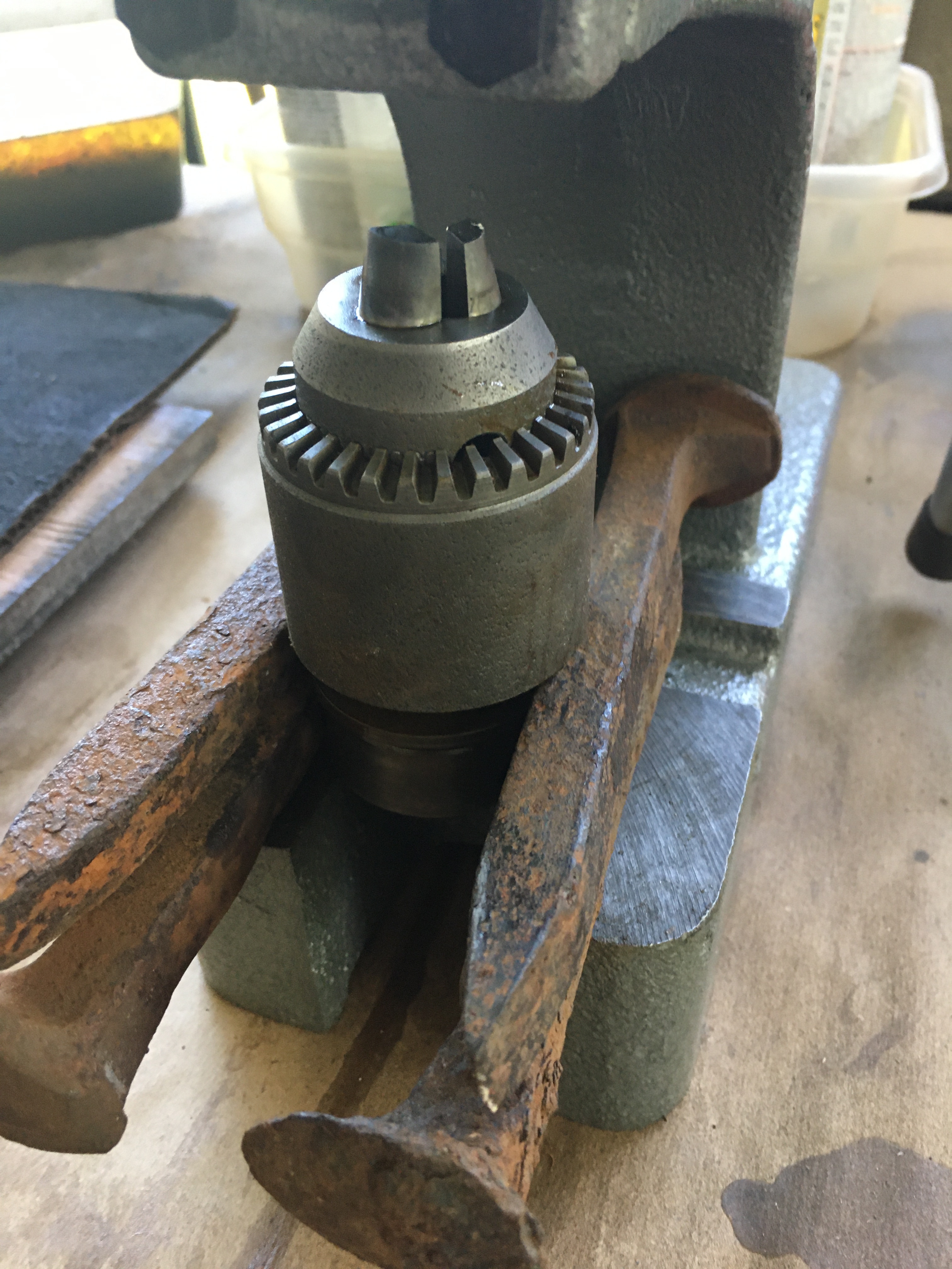

That went fairly easily. The opening in the based of the arbor press was too small to engaged the outer sleeve of the chuck. I didn’t have any pipe big enough to make a collar to press against so I stacked some old railroad spikes I had laying around on each side. Worked like a charm. Made sure to note the order of the 3 jaws because the teeth are slightly staggered so the order matters.

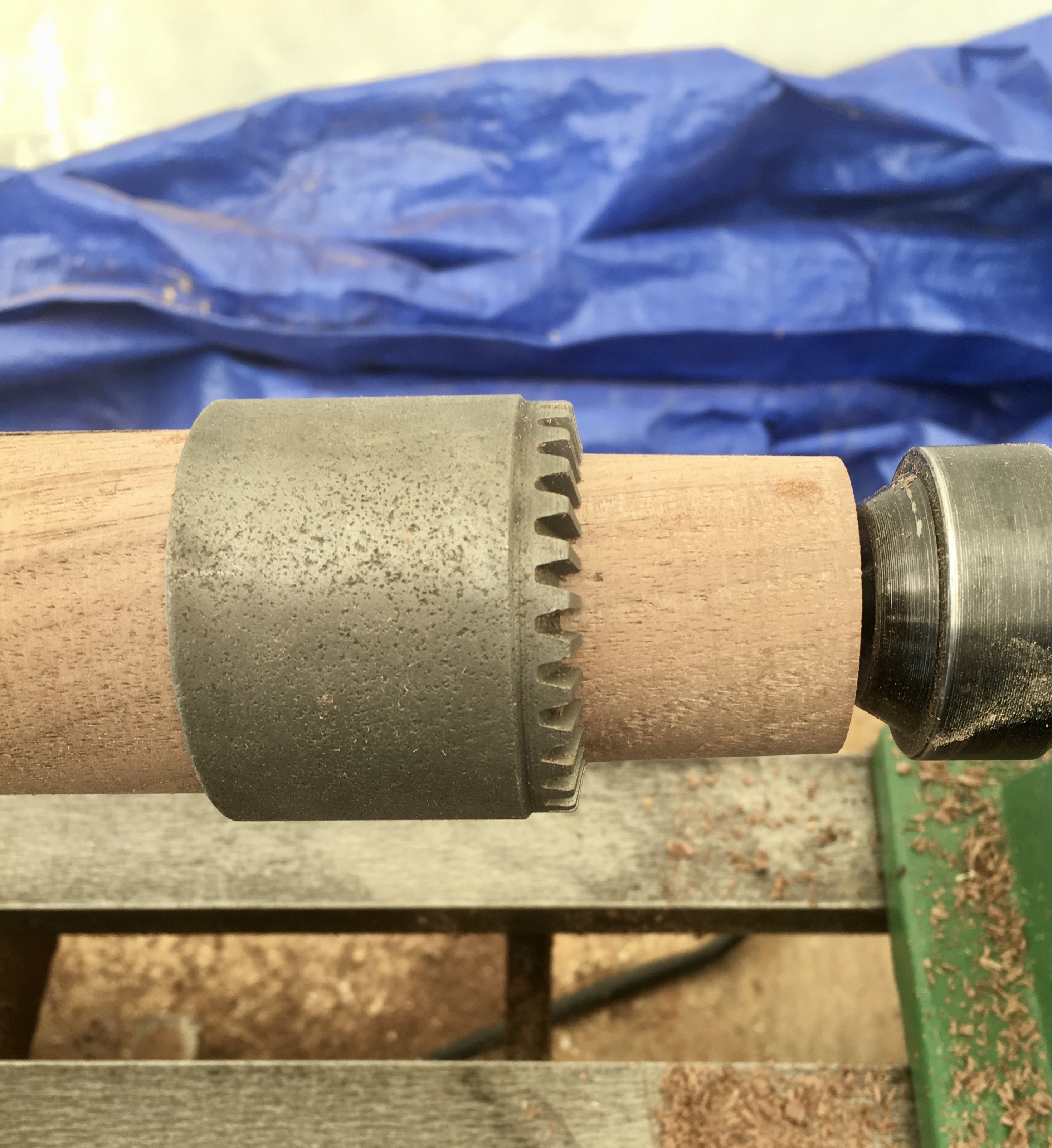

Up next for the chuck was to do some sanding and polishing to get rid of the rust pitting. To do this I create a tapered mandel on my wood lathe from a piece of walnut. The wood was turned to match each piece as I went. Slid the pieces on and then sanded with different grits of emery sandpaper, while it was turning, to remove most of the pitting. Polished with a wheel on my bench grinder.
