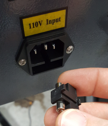

Just got a new K40, I replaced the front panel with a custom version. I removed the power wires to the rocker switch but I marked them before I did so that I made sure I connected them back correctly.
The second I turn on the power to my power strip that the laser is plugged into it pops the fuse.

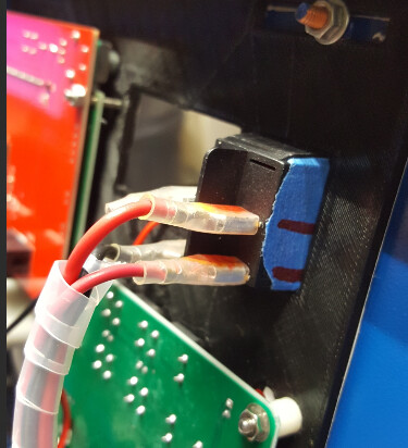

I put a piece of blue tape on the switch before I disconnected any wires and marked the wires and the tape with a red marker.
Its the only thing I can think of that could be the problem and some how I have the wires connected wrong.
Below is a couple images of the connection. Can someone please tell me if this is plugged back in wrong.
When you turn that switch on, it connects black to black and red to red. In its off position, none of the pins are connected.

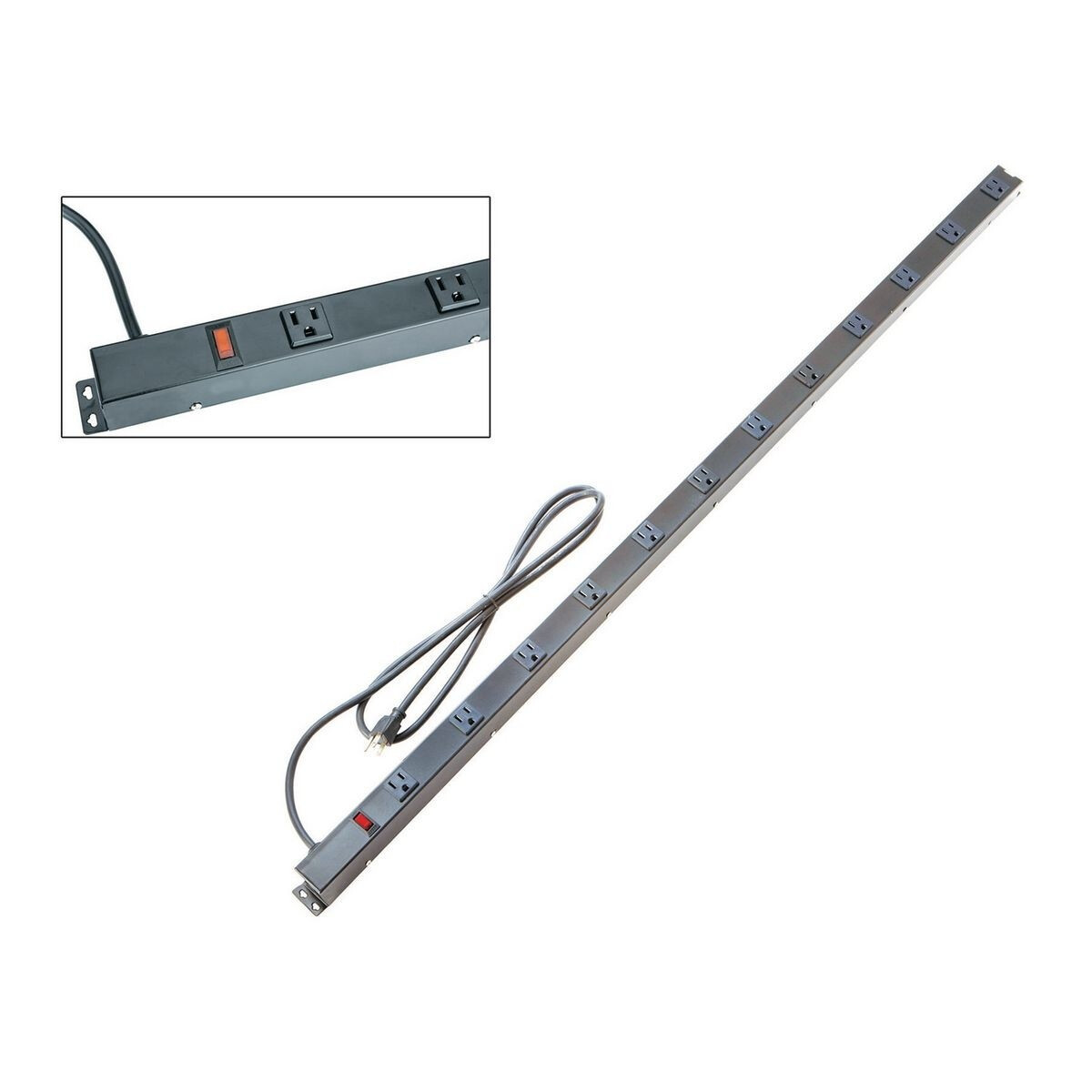

Ok with the switch in the off position it does not blow the fuse. The power strip I am using does not have a breaker built in.
This is the kind of power strip I am using. I have other stuff plugged into it and it does not cause an issue for any of the other devices plugged into it.

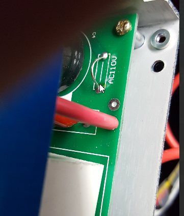

If the Power supply is set for 220v by chance could this cause it to blow the fuse? I have read a few times that people have received units in the US with the PSU with it set to 220v.

Then I would check the lps to see if it has voltage set correctly for your power.
If its set to 220V and I am on 110V will that blow the fuse?
Yes it will.
This power supply does not have a switch it only has a hard jumper soldered into a 110V connection on the PSU board.

Ok I tested the switch and I think its fine. If I hook my leads on the red side both lugs it sounds when in the on position. I then crossed check both the blacks with the top red on and made sure there was no connection there when in the ON position. I then moved to the bottom and test both other black and there was no connection.
So the only time I get the audible tone on my mere is when either both leads are connected to the red side or both are connected to the black.
Do you read a short across any of the black and red wires?
The pair that are on the output of the switch likely read a short?
