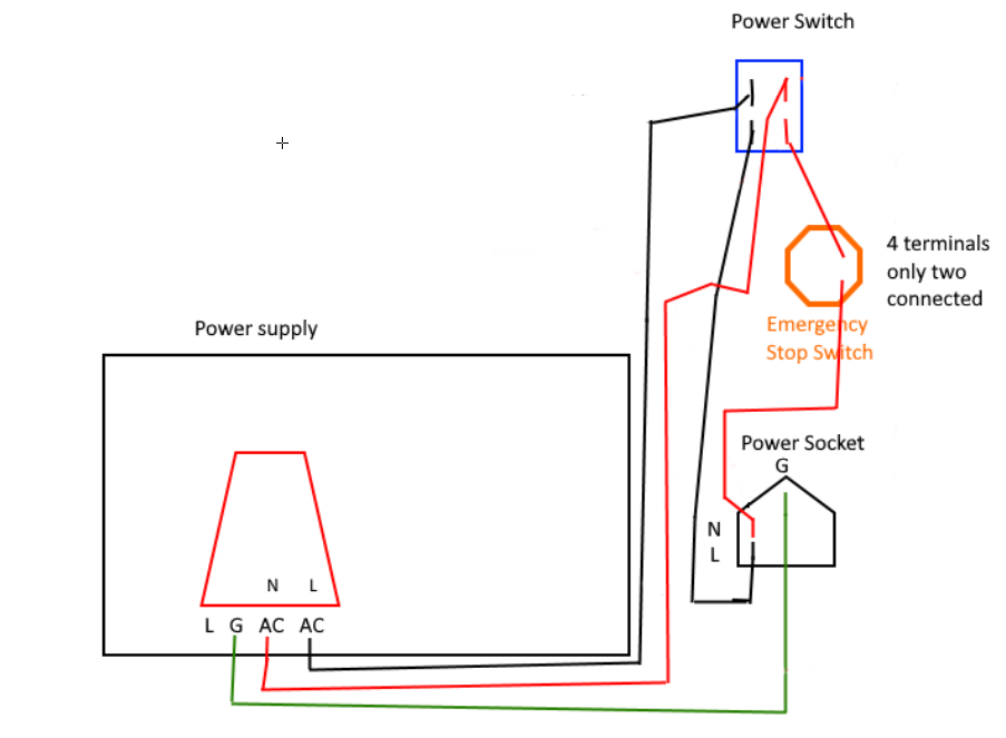

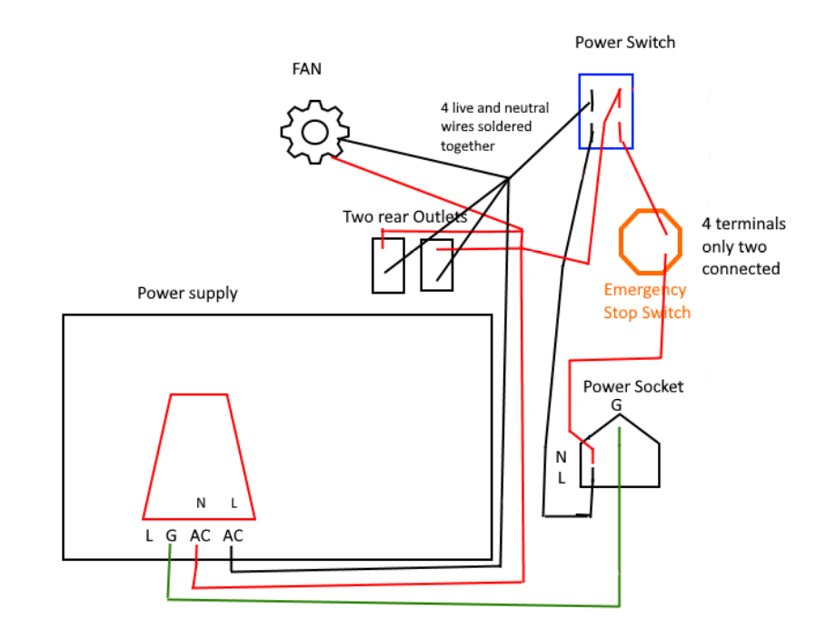

here is a crude drawing of exactly how my unit is wired. I have removed the fan connections and the two auxiliary outlets completely now.
This is how I intend to rewire it now when I get my new power supply tuesday.
Ok exactly the same with the sockets and the fan missing.
I don’t see anything wrong with the before or after.

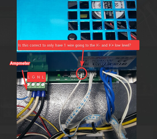

Is it normal to only have 1 wire connected to the K- / K+ Low Level?
Also should there be a jumper over the P+/G in order for the Laser to be able to fire?
Below is a picture of everything that is hooked up to the new LPS.

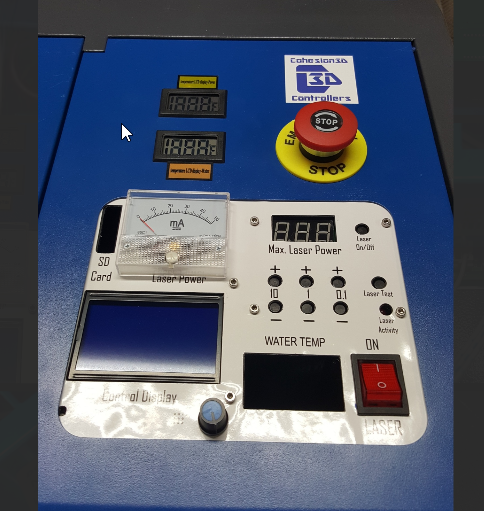

Post picture of your control panel pls.
With the digital control panel, yes.
K- is just another G. K- and G are connected at the power supply and also at the control panel. That’s why they usually don’t bother with hooking up another wire which wouldn’t do anything. There already is one for G.
The person who designed that power supply thought it would be neat to have a two-pin plug for the test fire button. That’s why it is like that.
