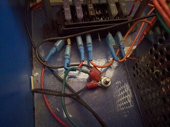

You are talking about the two blues wires going to the ampmeter in my pictures correct?

There is one wire going to the tube (L+) and one wire going back from the tube (L-). This is one loop.
The ammeter is spliced into that wire which comes back from the tube (L-).

@Mameniac This is an analog amp meter which doesn’t have a “shunt resistor”. Instead the current directly flows through the coil (which is some kind of shunt) that megnetically drives the needle. The maximum current of the LPS is around 25mA, which can be handled by the 30mA amp meter.
The very small voltage drop over the amp meter in the high voltage loop can not cause the problems on the low voltage side. But interference from the HV side could make the controller or display crash.
