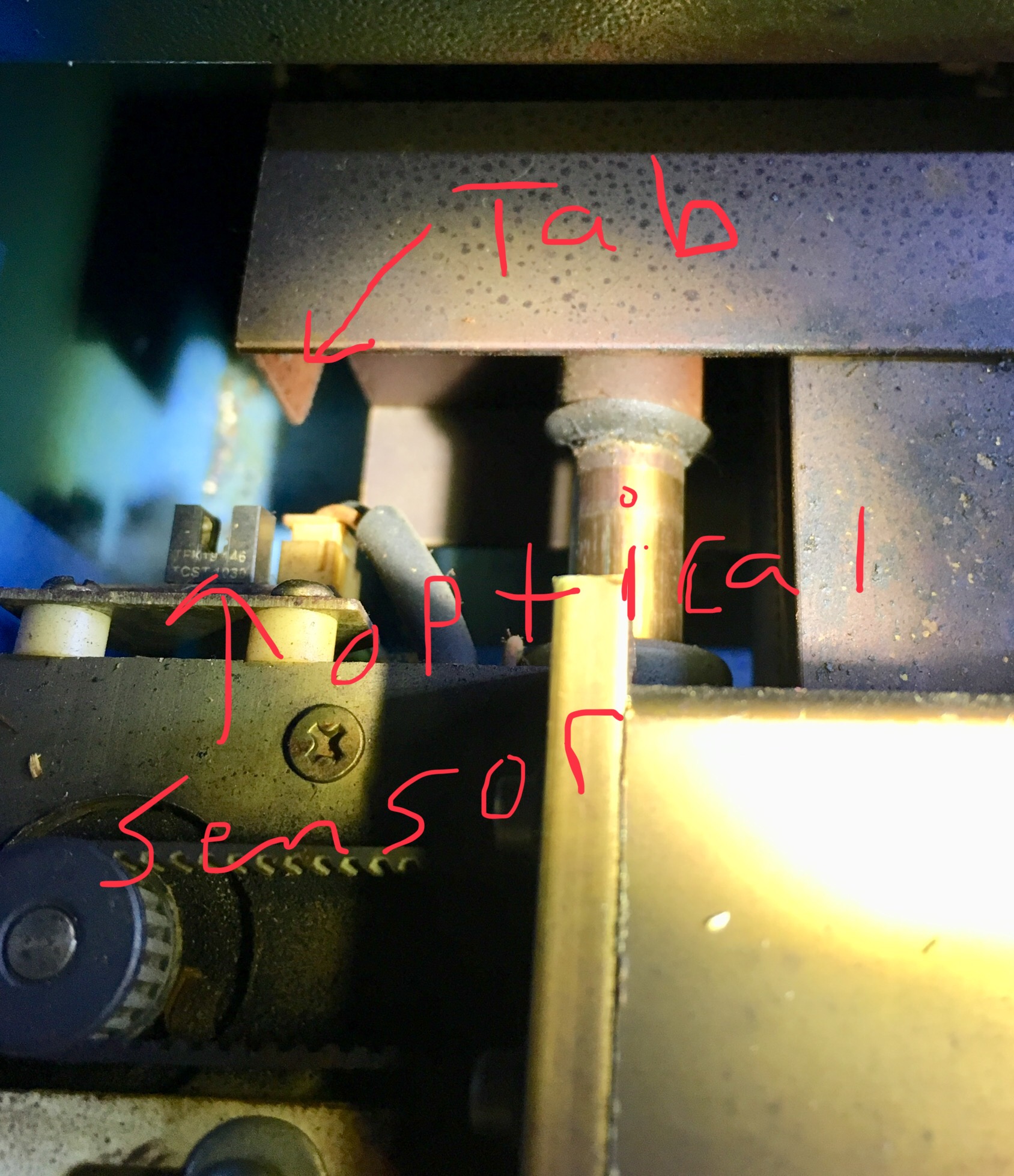

Ok, for homing the K40 uses optical endstops. The optical sensors are black U-shaped pieces where a metal tab slides into the middle of the U-shape at the limit. I’ve included a pic of my y-axis sensor and tab. Make sure nothing is blocking the sensor and make sure the tab is aligned correctly to slide into the middle of the sensor.
Than you Nedman, I find the solution!!!
Under the optical sensor was a wire that controlled both the end stop and the x axis and was ruined. I replaced it and now it works.
