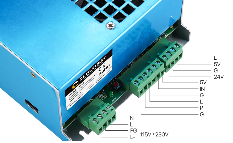

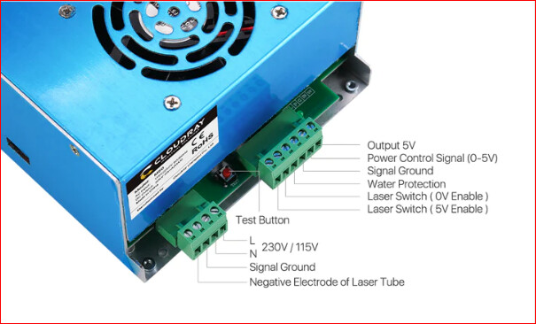

Your LPS picture does not reflect the LPS that is in your drawing??
Do you have this one?

  4. You will note in the “diagram you found” there is a connection between M2 Nano-LO and the LPS-TL. TL = Laser Switch (0V Enable) OR L on your supply.

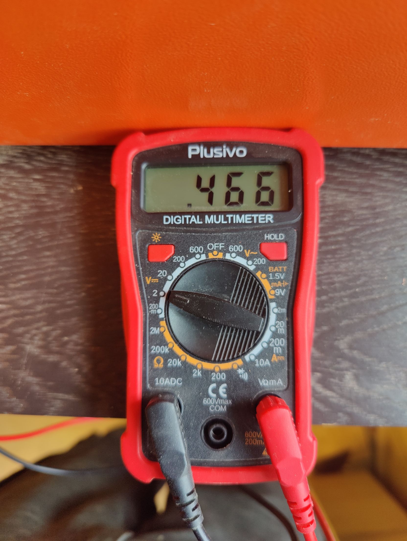

Post a picture of your DVM please
Measure the voltage between the ground and the IN pin.
Hopefully I understand correctly.
Did you measure like this?
  • The black lead is on ground
  • The red lead on “IN”??
When the pot is at its max IN should be 5V.

the voltage between the G and P is ~4,66V
the voltage between G and IN is ~4,66V
With the pot turned all the way counterclockwise, I got ~0V.
As I turn the pot clockwise, the voltage gradually increases until ~4,66V

Meter reading:
  • I am surprised by the meter’s display.
  • On the 2v scale, it reads .466. I would expect the decimal place to be one more to the right or the meter to max out if the voltage is 4.6V. Perhaps the voltage is really .46? 4.6V is abnormally low.
  • What does it read if you put it on the 20 scale?
