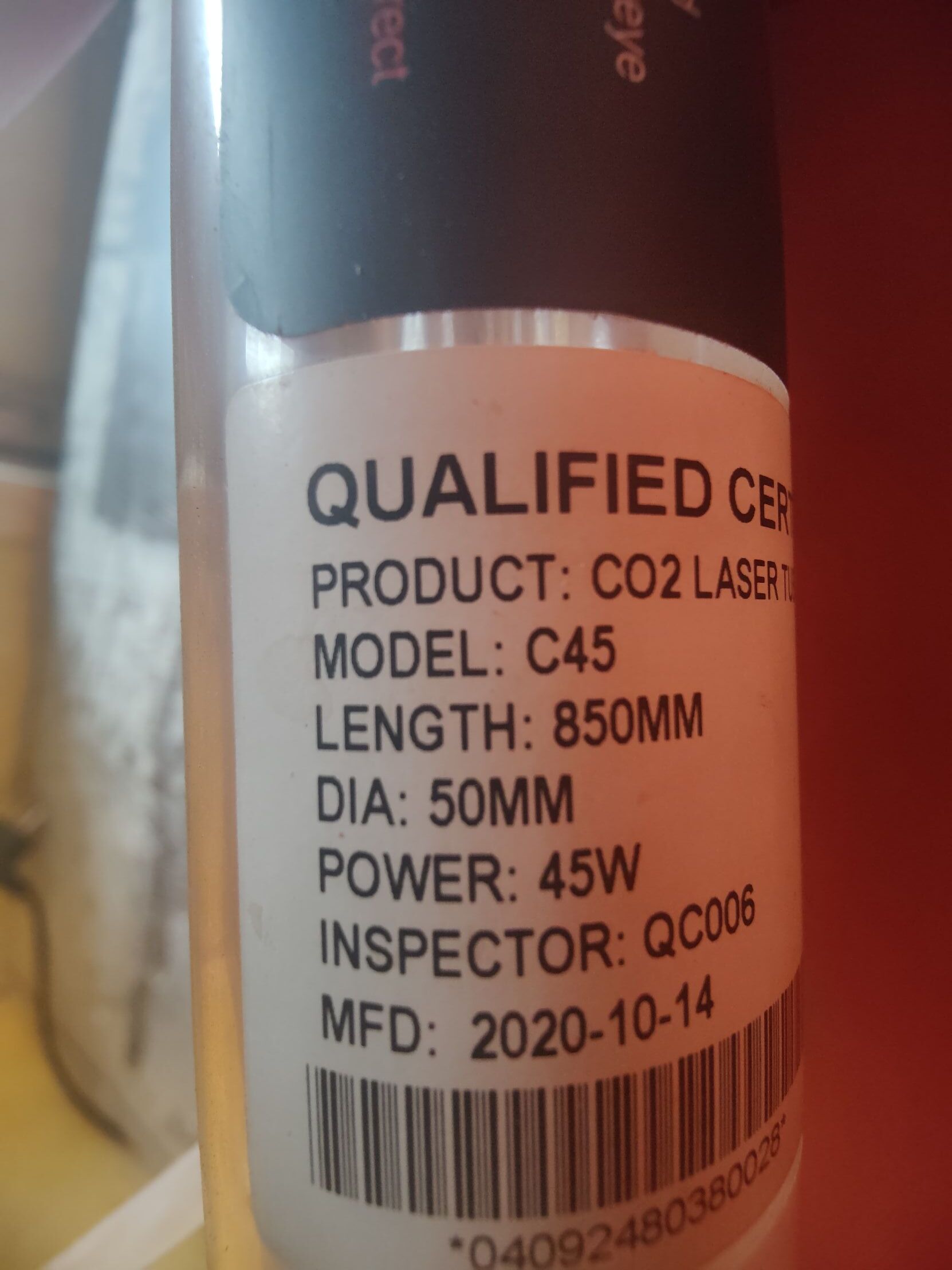

50W LPS is bad, from what it seems. I plugged back in for a fast test of my old 40W LPS and G-5V reeds 5V. And when I press the test button on the 40W LPS laser fires.
How bad would it be if I use my 50W laser tube with an old 40W LPS?
You can use your 40w tube with the 50w supply just keep your current in the range for that tube.
Cloudray should replace your LPS.
Nice.
On what I should keep eye for current?
Just to be sure.
Tube what I have now in machine.
Old LPS
You generally want to run tubes under their max current anyway for improved lifetime.
Just use an analog ammeter to stay within the current limit for sure, as we recommend in the K40 Intro linked at the top.
