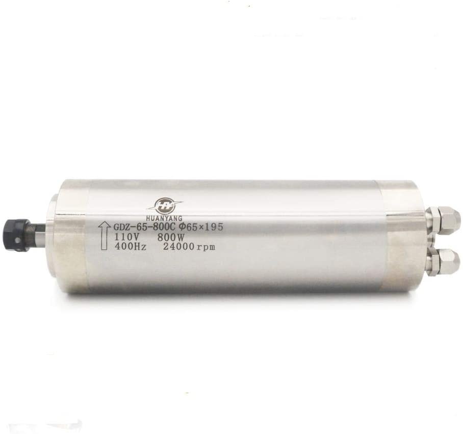

R7 is typically an 800W 65mm water-cooled AC spindle.
Spindle brand is unknown but is 800 W, 65 X 195 mm, 110v. It is the one that came with the R7 kit from Hobby-Fab.
I don’t have an R7, but I think that this is an example of the type of spindle and would probably work with the same VFD. (My recollection from reading the Hobby-Fab site was that it was a three-phase and shipped with a VFD.)
(This is not an endorsement of this particular unit or vendor, just a link for disambiguation.)
