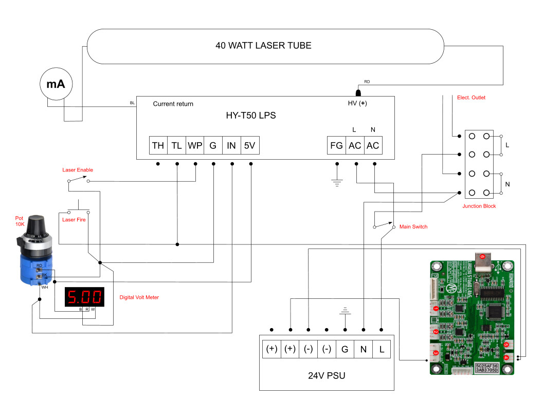

I made this wiring diagram by looking and searching on the web. When I try to raster engrave on rubber, the laser doesn’t seem to have enough power. It barely touched the material (Pot was set to 10ma manually). Not sure what I’m doing wrong.

Not sure what its wrong. Here is a copy of my diagram. Can you please take a look? Do you see anything wrong?
(Tube, LPS, PSU, Pot, Switches, M2 Nano board, Laser Tube, Digital Voltmeter are brand new).
I will take a look. Nice drawing BTW.

I don’t see anything obvious wrong with your diagram.
Since your machine is engraving but at too low of power I would assume:
  • the controller wiring is good

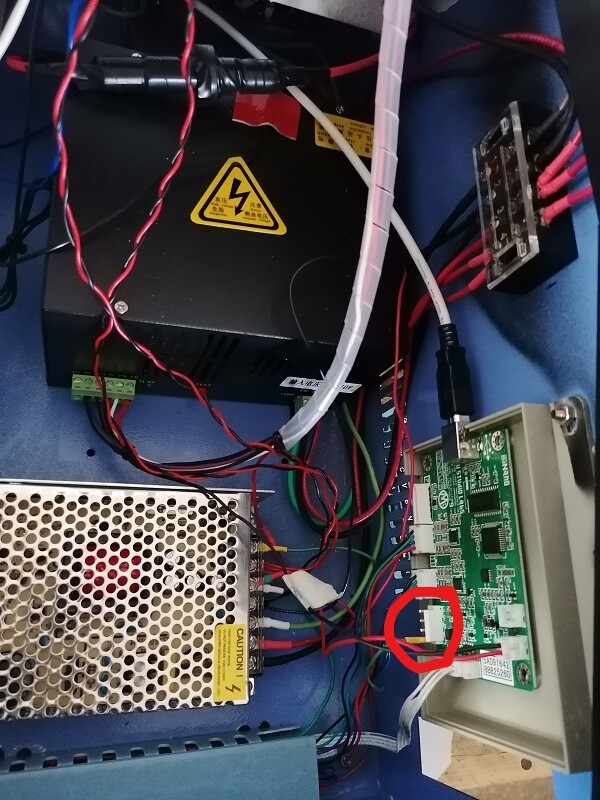

These are some pictures of my temporary panel and new parts.
IMG_20210114_125949

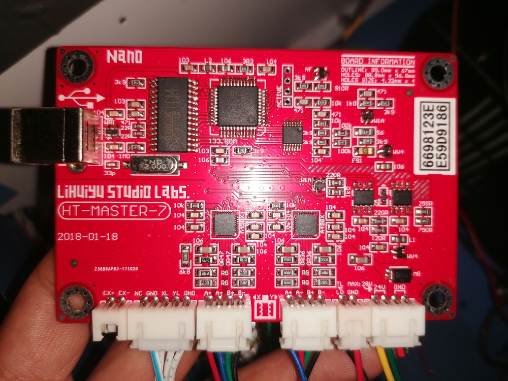

I purchased two M2 Nano boards from Cloudray just in case. The board that came with my K40 was a weird model. Thanks for the comment.

Action #2: Then I would change this wiring (picture attached):
  • Move the LPS-TL to the M2Nano-LO on connector #3 in the drawing
  • Connect LPS-Grnd to M2Nan-GND on connector #3
The above wiring changes are mostly to insure consistency with my experience.

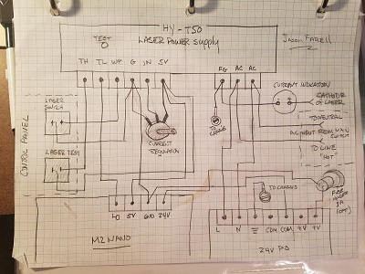

Hello Don, This is the schematic I was referring to.
SCHEMAT

I tried to do a test, but the computer was not recognizing my K40 (Tried different usb ports, replaced the Nano board with the other one I bought, but same results).
Do I need to send 5V from LPS to connector #3?
I’m stuck on action #2.
What do you think I should do?
The 5V supply is what powers the processor on the board as well as the limit switches. The 24V powers the stepper motors only. If you don’t supply 5V, it won’t function.

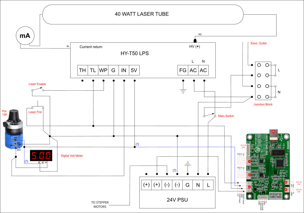

When I drew the conversion diagram above we did not know the 5V capacity for this style LPS. Most of these use a LM7805 which can source 1A, we assumed that was the capacity.
I looked around again and this time found a spec: 5V@ 20MA
https://www.amazon.com/Engraving-Cutting-Temperature-Relative-Humidity/dp/B08PD941Q9/ref=sr_1_6?dchild=1&keywords=Hy-T50&qid=1610720450&sr=8-6
It may be that my original drawing was flawed, or at best marginal. I am pretty sure it worked but I would not chance it. Poor supply capacity can cause a myriad of headaches.
I seriously doubt 20ma is enough to run the Nano properly.

Where does the wire (TO STEPPER MOTORS) go. Its at the bottom of your diagram and comes from -24V.
