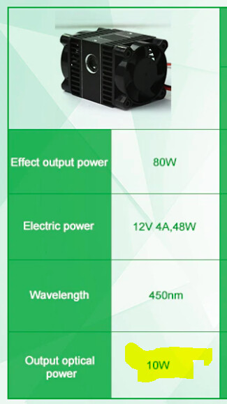

Anyone know what is it’s optical output is?

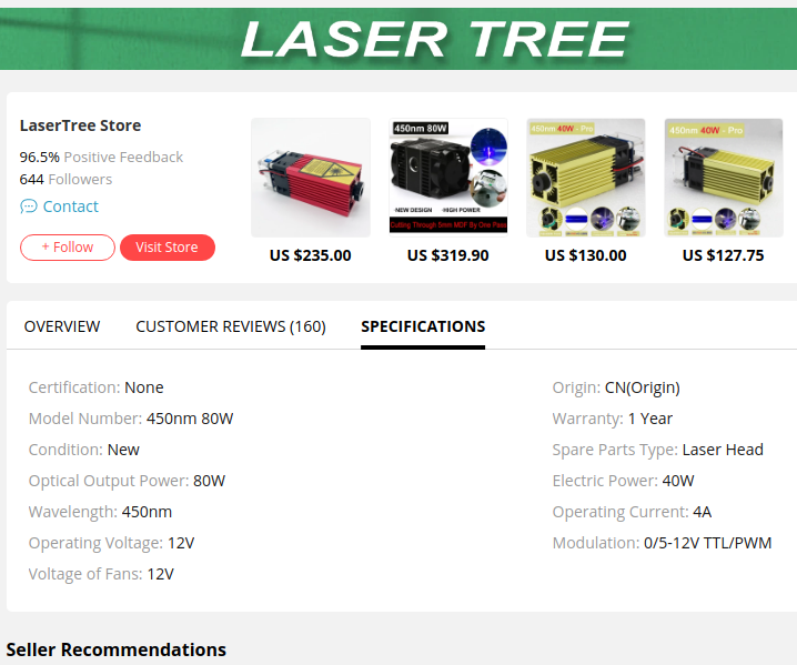

it is listed right on the Specifications section of the link you provided…
Optical Output Power: 80W
believing it is another story.
10W seems likely closer to reality. :relaxed:
that’s funny, the same page shows 80W for output optical power.
Hint: Don’t buy from people who sell over-unity devices… :rofl:
Maybe it’s actually more like 8W?
Heh and they provide a power measurement.

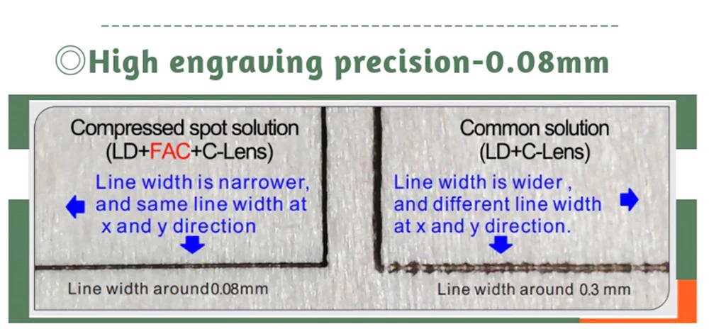

I wonder if they rotated the diodes 90 deg to each other or try to align the oval diode output. I’m not a fan of how the diodes etch or cut tighter lines along one axis than the other axis. Better for rastering when you plan for it but vectors can look funny because of the oval ‘dot’.
They have a graphic claimiung a square dot and that it is due to “FAC” but I didn’t see where they spelled that out.
Thx, I see that they spec’ed it having a balanced dot shape. I’m guessing the FAC is the combiner lens. Looking to be an impressive laser diode package.

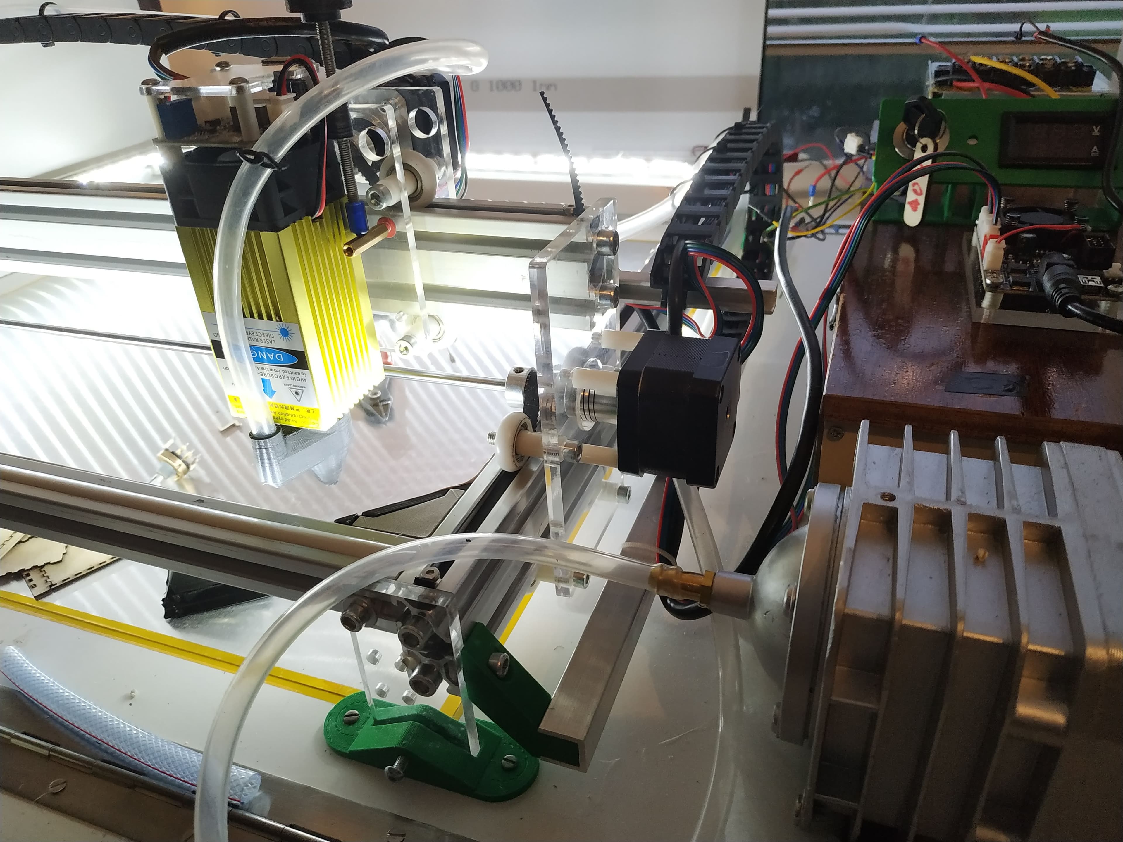

With decent air assist it will cut plywood, I’ve done 5mm ply in extremis, I regularly do 2mm model ply cuts in 2 passes with minimal scoring. By ‘decent air assist’ I mean a high-pressure/flow pond airpump and a small nozzle right above the focus. I don’t have a good photo of this so here is the render of the part I designed and printed:

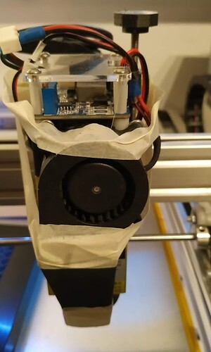

When I made the sign shown in the previous posting my ‘air assist’ looked like this:
(that’s a 40x20 radial fan and a simple cone nozzle, lots of masking tape, and pathetically low pressure / airflow)

The pump is the largest I can afford, a bigger pump would be better.
The nozzle is on my own design and on my cults page here (free download)
With this set-up and focussed it cuts 2mm ply in 2 passes at 12.5mm/s. The only reason it needs 2 passes is so that the focus can be moved down for the second pass. The first pass does most of the heavy work, the second pass clears and separates the cut.
