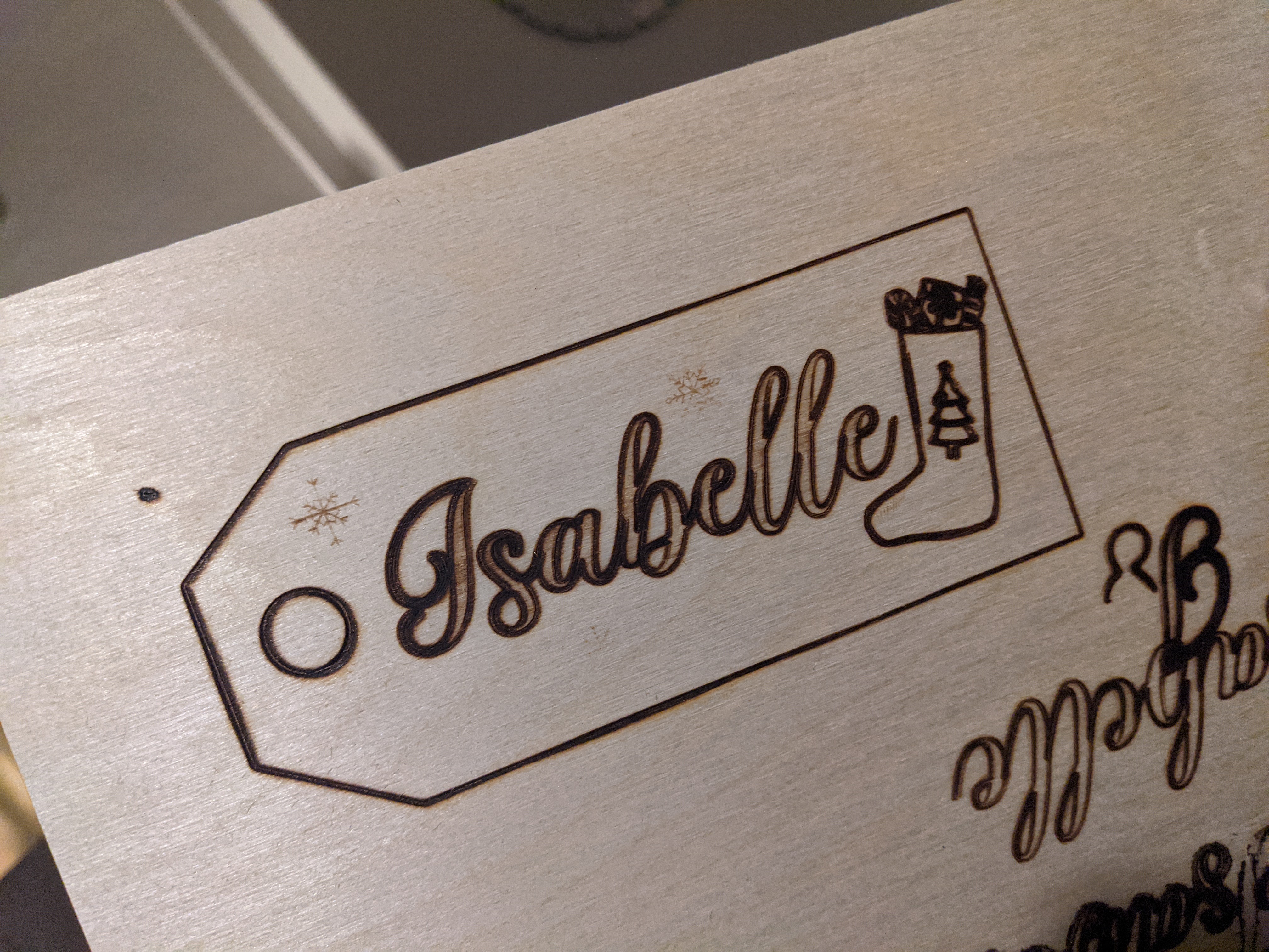

Hello - after lots of research and planning I finally bought my K40 laser this week - before switching it on I got an electrician to check it was grounded and wired safely - figured out how to install the air assist and got a new honeycomb bed … I got to switch it on for the first time tonight and it’s not quite got the power yet, it may be my focal length + alignment, which I’m going to start fresh with tomorrow - pretty tired right now after figuring all this out today! The worrying thing is I had it on 8mm/s @ 80% power and it just made a slight burn outline :confused: the raster engrave could only achieve a shaded look, and again the was 35mm/s @ 70% power - I’ve definitely got something wrong, and experienced laser master advice would be really appreciated! I really want to make laser cut jewellery to sell in my business and was so excited to get the machine, but that seems a long way off at the moment :frowning: … I’ll try and take pictures of my set up … thanks so much in advance if anyone can help, Donna x
Not knowing what the orginal image is supposed to look like I see the following:
  • Change in line width from left to right.
  • Uneven shading
I would start by doing a complete optical alignment. Seldom do these machines work as expected without an alignment.
Post pictures of the beam burn at each mirror, then we can advise from there.

Yes the left side seems darker, and the line width it quite thick,

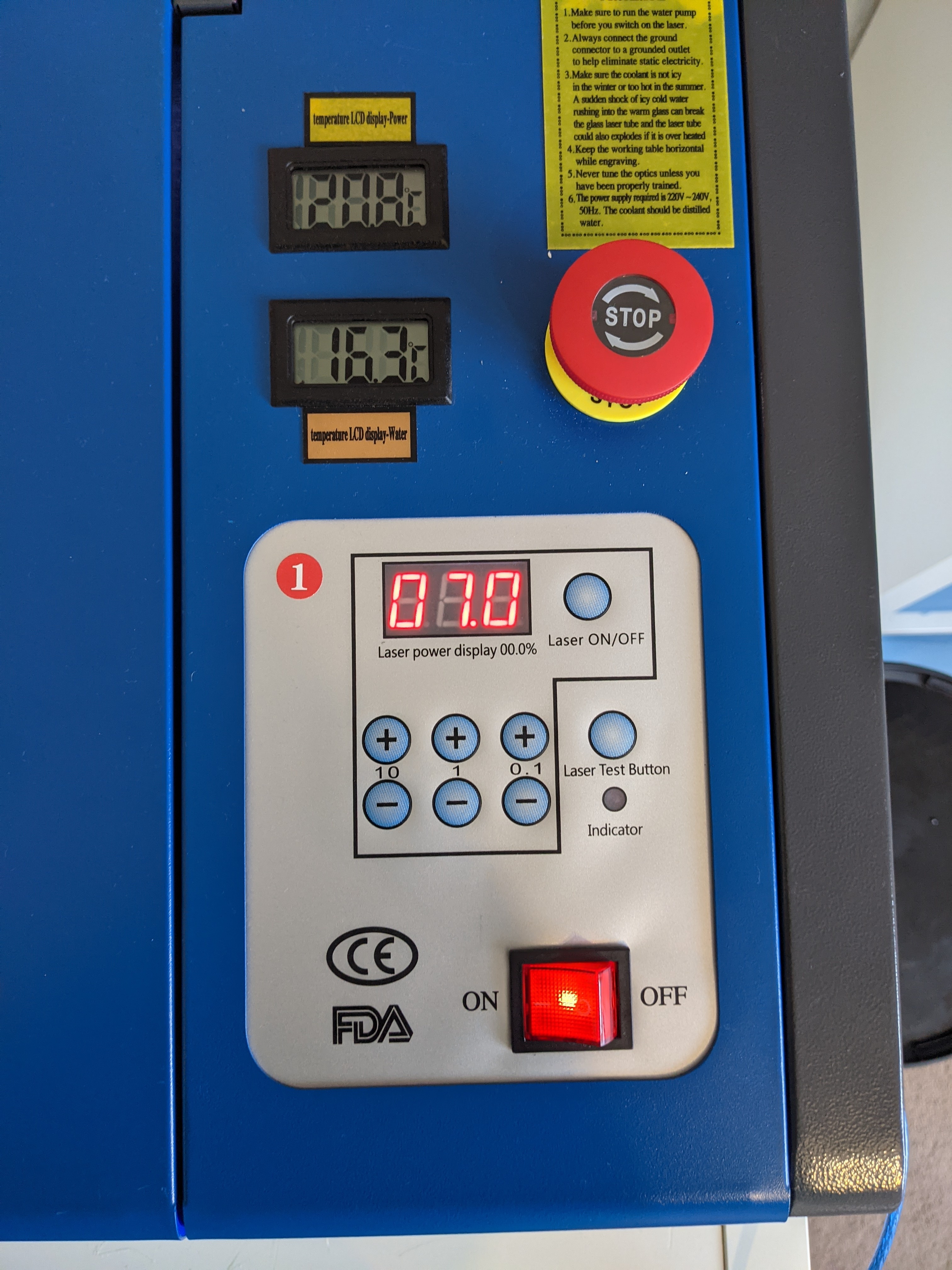

Hi, thank you for all this info :slight_smile: … no sadly I don’t have the analogue Amp meter, its the digital power percentage - I’m trying to not take it over 85% power to try and preserve the CO2 on the tube longer :confused:

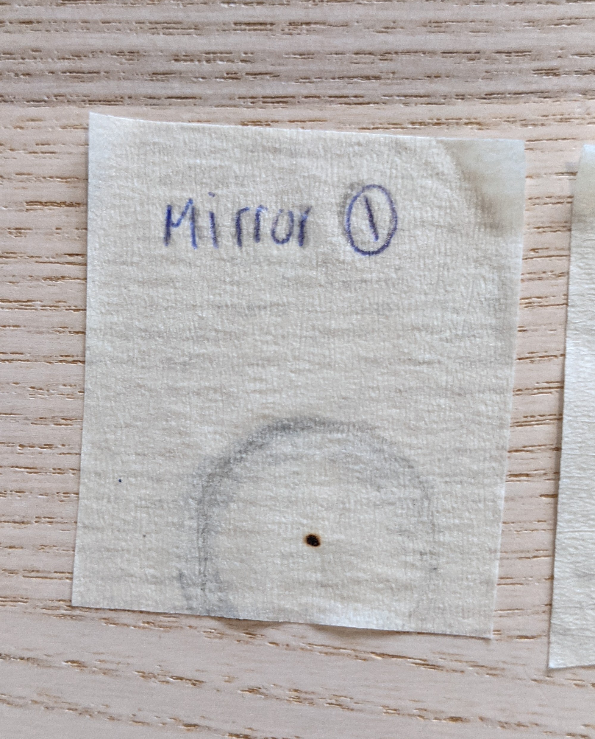

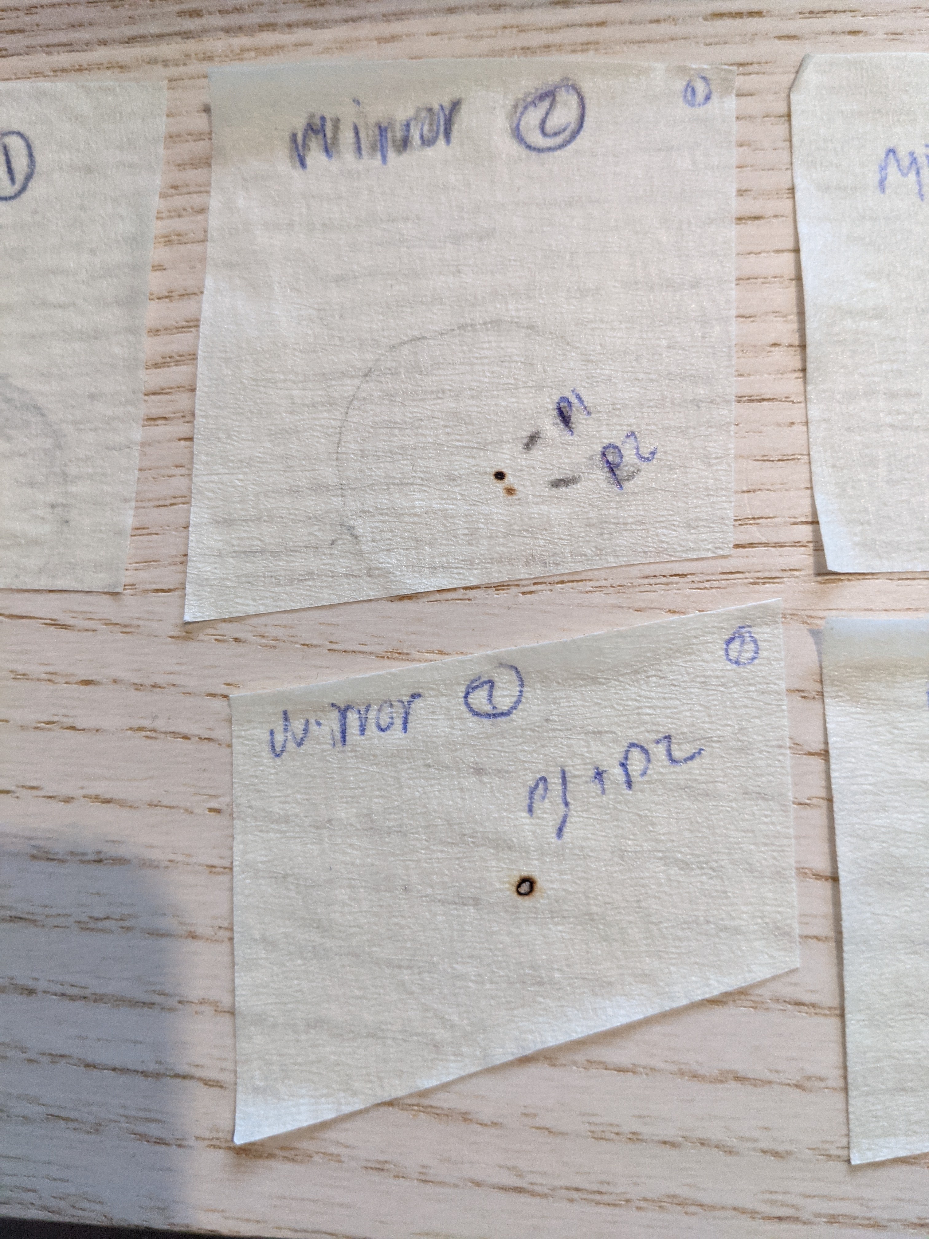

Hi guys - I’ve just done the test shots - was this the right way to start?
Settings + Mirror 1
PXL_20211123_112141409|375x500
Mirrir
The digital meter doesn’t measure power at all, and how the numbers it shows relate to current flowing through the tube can be different not only from one machine to another, but also can change over the lifetime of the tube. An analog meter is very inexpensive, just a few dollars.
It’s sad that manufacturers persist on selling units without them, often even representing “digital” as better. :frowning:
For mirror 3, what you really want to do is make sure that the beam is centered in the nozzle. You can remove the nozzle, put tape on the bottom of the down tube under mirror 3, and shoot a test. Mark the edges of the tube on the tape so you can see whether the beam is centered when you remove the tape to look at it. Ultimately you want the beam centered in the middle of the tube regardless of the position of the laser head. If the beam isn’t centered in the nozzle, it will be bouncing off the edges of the nozzle opening and will make quite the mess.
Your test shots do demonstrate that the mirrors aren’t yet aligned. This confirms the most likely diagnosis!

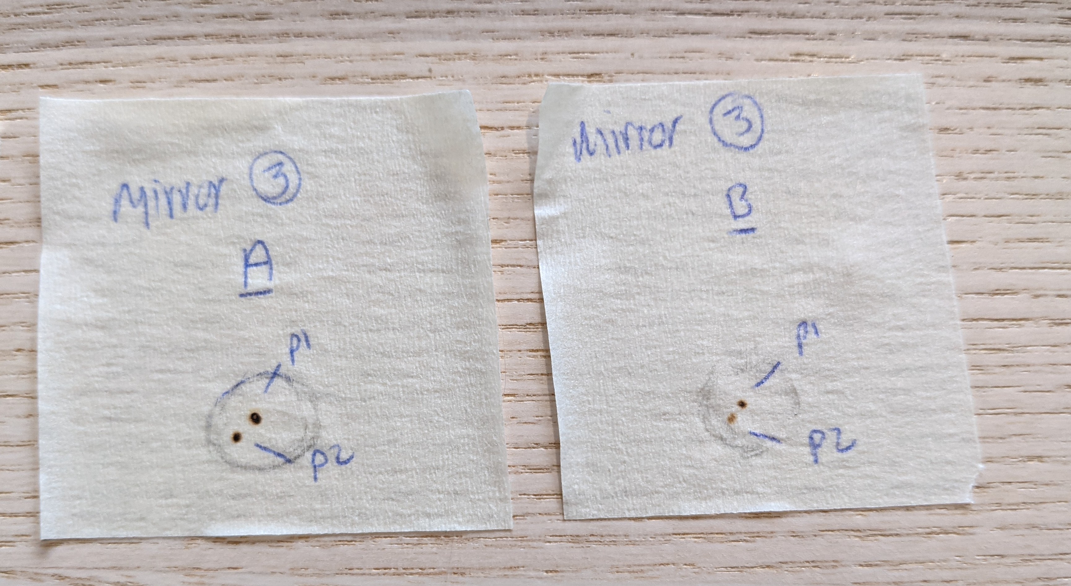

Thank you - will try the tape under the laser head now :slight_smile: … I’ve had a little weird thing happen tho - I’ve aligned mirror 1 + 2 (to the Y axis and mirrors, both make fits into of each other) but when I fire to mirror 3 on position 2 (top right corner) it’s making a double dot? Is this reflecting off the rim of the lens opening? Thanks again for helping! X
Stopped the double dot - but now the cut has a haze around it! I’ve ordered sone new lenses which should arrive tomorrow - I think I may need to raise the laser up a little because after I aligned mirror 1+2, mirror 3 dot was nearly at the top rim! The dot under the laser head was centred - abit confused about what’s happening tho! I hope I can figure it out eventually!
Glad you’re working out your alignment issues but you should not be running the laser at more than 40% on the digitial setting without knowing what the real power level is. I’ve seen people burn out their laser tube in less than a year thinking they were only running at less than full power when anything over 45% on their machine was 24mA.
Please read through all of the K40 Intro at the top of this page, one section specifically mentioned not setting the digital power meter over 40-50% because it can over drive your laser tube. In the Don’t section here:
That’s really good to know - I’m hoping to run it at the lowest power possible that achieves a nice cut etc, but right now not even full power cuts 3mm balsa wood :confused: I’ve ordered some new lenses and laser head with built in air assist … will try again tomorrow!
Until you install an analog milli-ampere meter or directly measure with a multi-meter, it is highly recommended you set the power level to the minimum possible to do your mirror testing and lens calibrations( ramp testing ). Remember, setting that digital display to anything over 40% is likely over driving the laser power supply and the laser tube and these cheap laser cutters are not designed to last long when that is done. Hence the many recommendations to use an analog meter and never drive the machine over 18mA(this would be your 100% level ).

One more thing, I see you are using tape in front of your mirrors to determine the laser alignment and while you will find people saying to use tape, do not use tape unless you put something behind it so that any burn-through does not splatter molten glue onto your mirrors. Far better to use paper which has no glue on the back and at worst will put a little ash on the mirror which could be blown off with compressed air.
The other thing I noticed was the markings on the tape shown in the pictures are not burning through the tape. Is this because you have lowered the power level to the point it only marks or are you still setting the output to 80% or so?

I am a little disheartened tonight, really want to get it working properly and finally make something nice! I was aligning the mirrors for a good couple of hours but it seems like they’re worse now! Mirror 1+2 are aligned but having real issues with mirror 3 - I can’t get the dots to sit on top of each other in all 4 corners of the laser bed - I’ll have to do some more research :confused:
