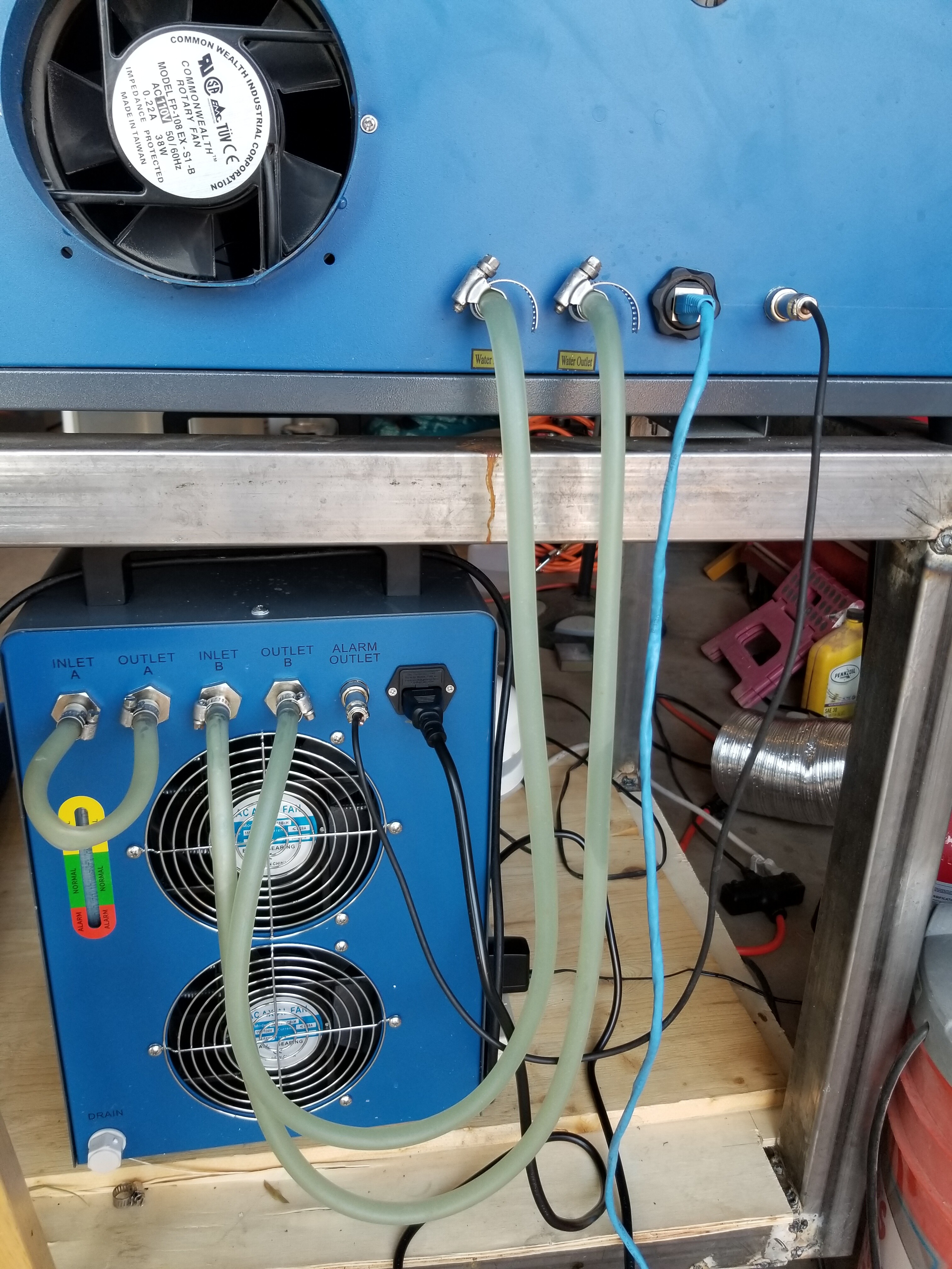

I have a 5202 chiller which has a pair of connection for two machines at the same time.
I use only one to the machine, so added a copper loop and put it in a beer cooler water and ice. The distilled water goes through the copper tubing (heat exchanger) back into the machine and through the tube and back into the chiller.
In the picture you can see the ‘loop’ of tubing, this is where I attached it to the beer cooler loop…
:smiley_cat:
Ah, so you are using the A side with the water ice to help chill the B side inside the chiller?
They are just ‘series’ linked. All the 5202 was doing at the time was pumping water and controlling the error input to the Ruida for water protection.
So I guess ‘Yes’…
Usually the picture in your head is much more close if I post the picture I want you to see. :crazy_face:
:smiley_cat:
