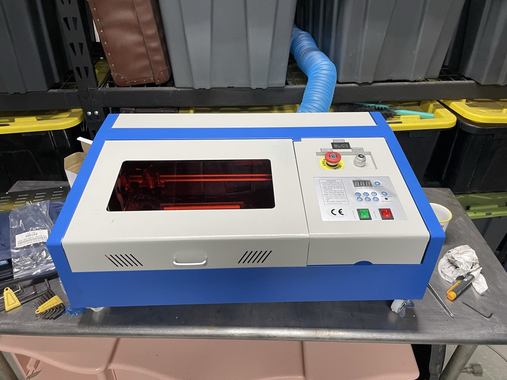

New K40, laser not firing at all
Hi all,
I recently set up my new K40 and got it connected to K40 Whisperer. I haven’t sent it anything to engrave/cut yet, but I’ve noticed that the laser doesn’t fire at all when pressing the laser test button.

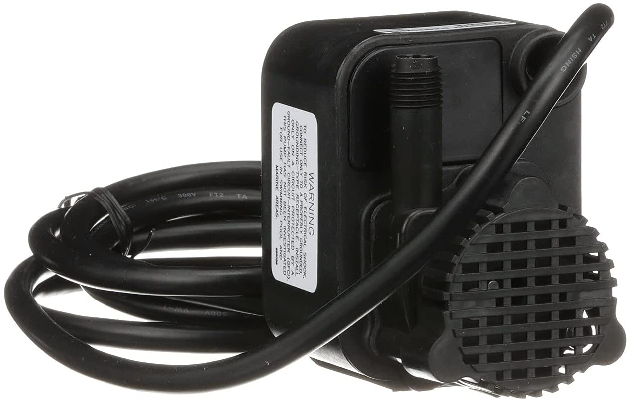

P.S. The pump that comes with this thing sucks. I’d welcome any recommendations for a replacement.
I use a HF 200gph pump, which I do not think they make anymore.
I have seen these pumps recommended by others…
Expensive but supposedly better reliability:

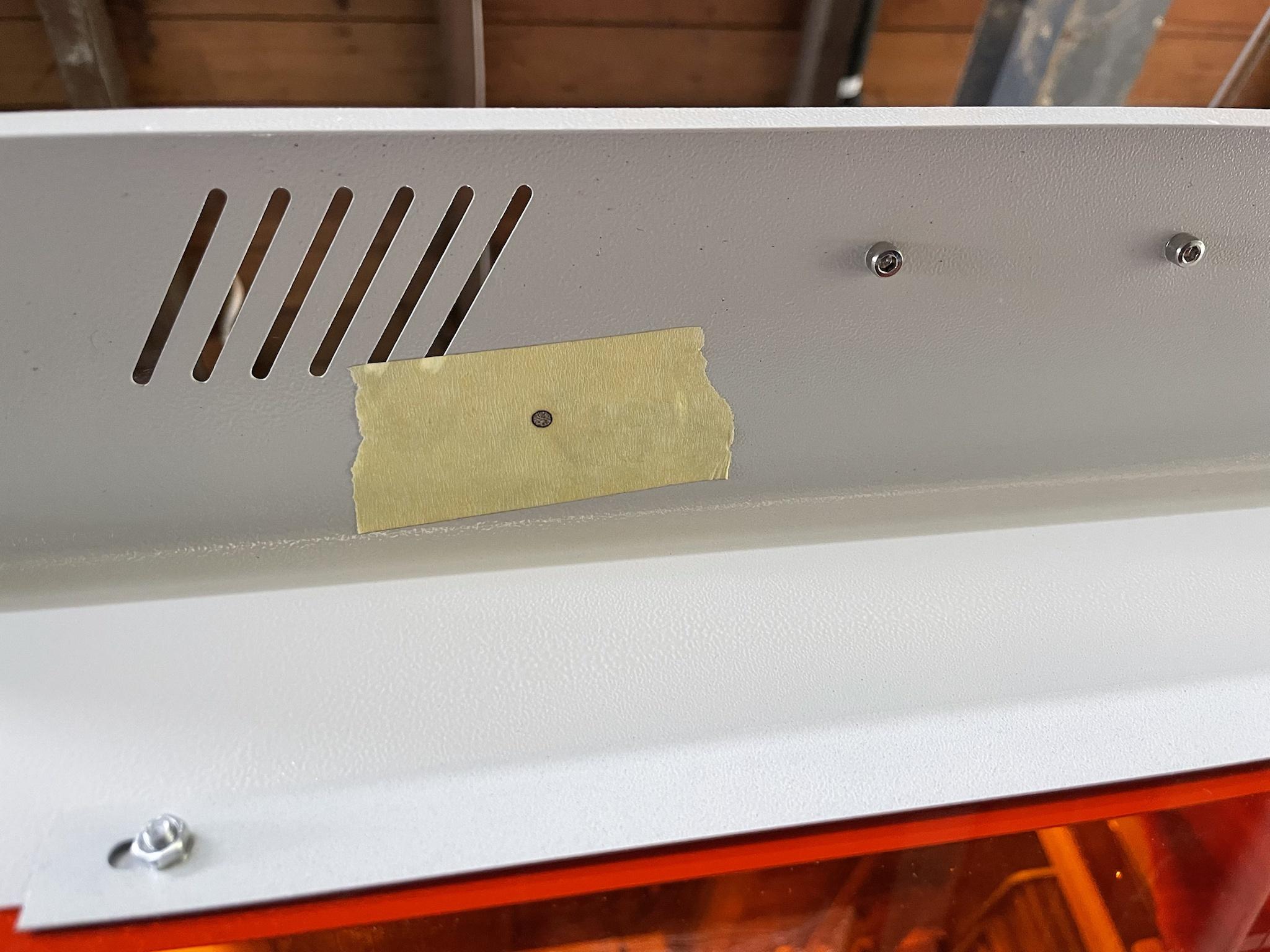

Ok, I’ve got my reservoir cooling working well enough for a test fire. I can confirm that the laser is indeed firing, but the beam isn’t making it into the cutting chamber. I placed a piece of timber under the laser head in the cutting area and it didn’t leave a mark at all.
Here’s a video:
It looks like the first mirror is just badly misaligned. The laser is entering the cutting chamber, but missing the second mirror by a wide margin. The beam is hitting the inside of the front of the lid, half way between the handle and the front air vents.

After an hour or so working on the alignment, it looks like I’m in action!
Thanks everyone for your time and assistance!
