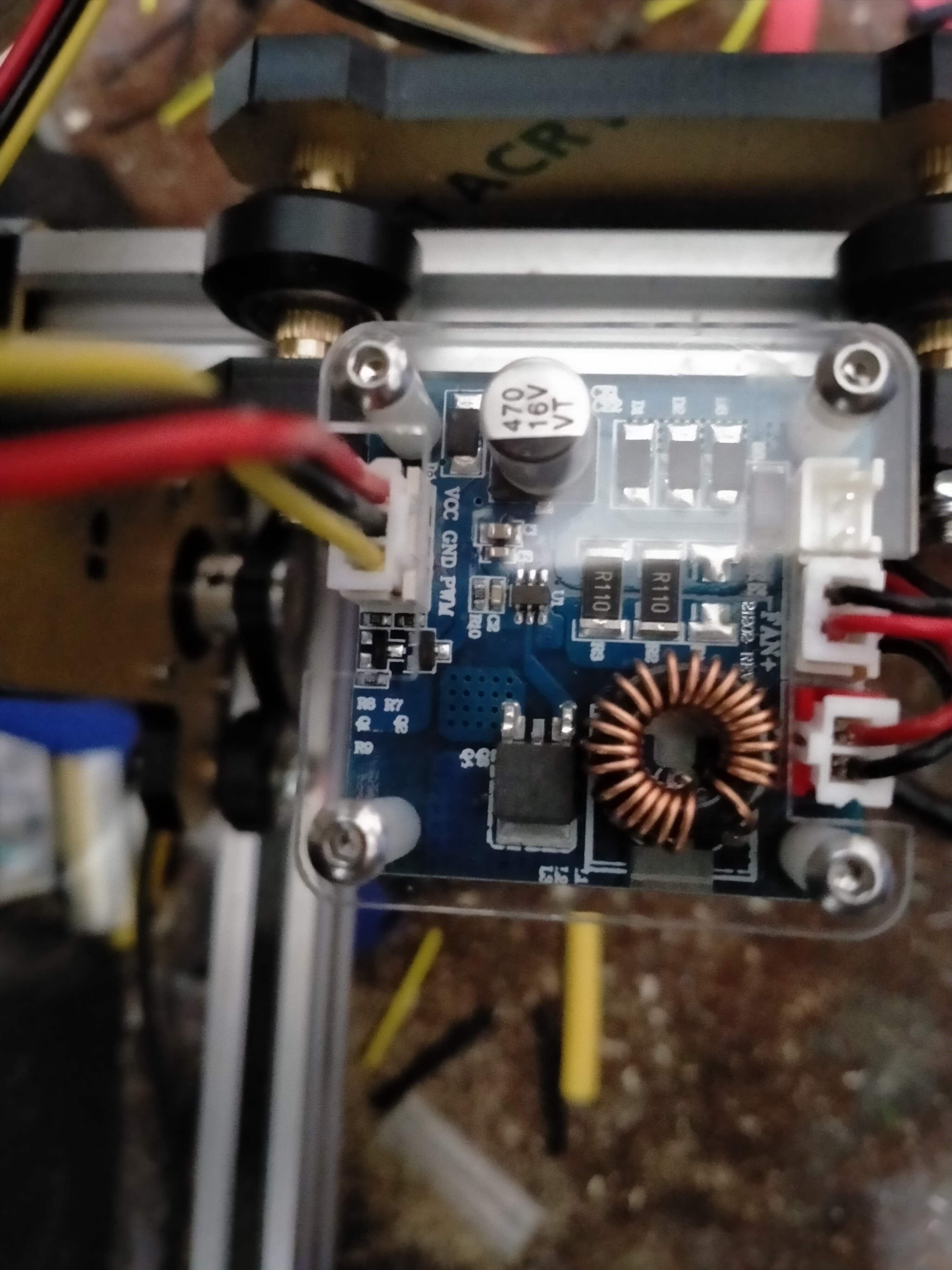

I’m using the unexpected bonus controller that was bundled with the chassis. It is an arduino based x-y controller with an optional laser 3-pin connector which is labelled 12V, GND and PWM. The laser has the same 3-pin connector so I thought it would be plug and play.
After staring at it for ages and finally probing it, I found the problem. PWM and 12V are reversed on the controller. I ran VigoWorks, turned the laser on, and then went probing on the controller with my trusty multimeter. Turned out that the pin labelled PWM was putting out a steady 12V, regardless of the laser setting. Meanwhile the pin marked 12V was producing 0-5V as I turned the laser power up and down. It is as simple as that - I backwards label (though the label IS right according to the colours of the supplied 3-pin lead (R - 12V, Bla - Grnd, Yel - PWM). I simply snapped off sufficient plastic from the female connector on the controller to allow me to reverse the male 3-pin connector, reconnected it and like magic the laser sprang to attention.

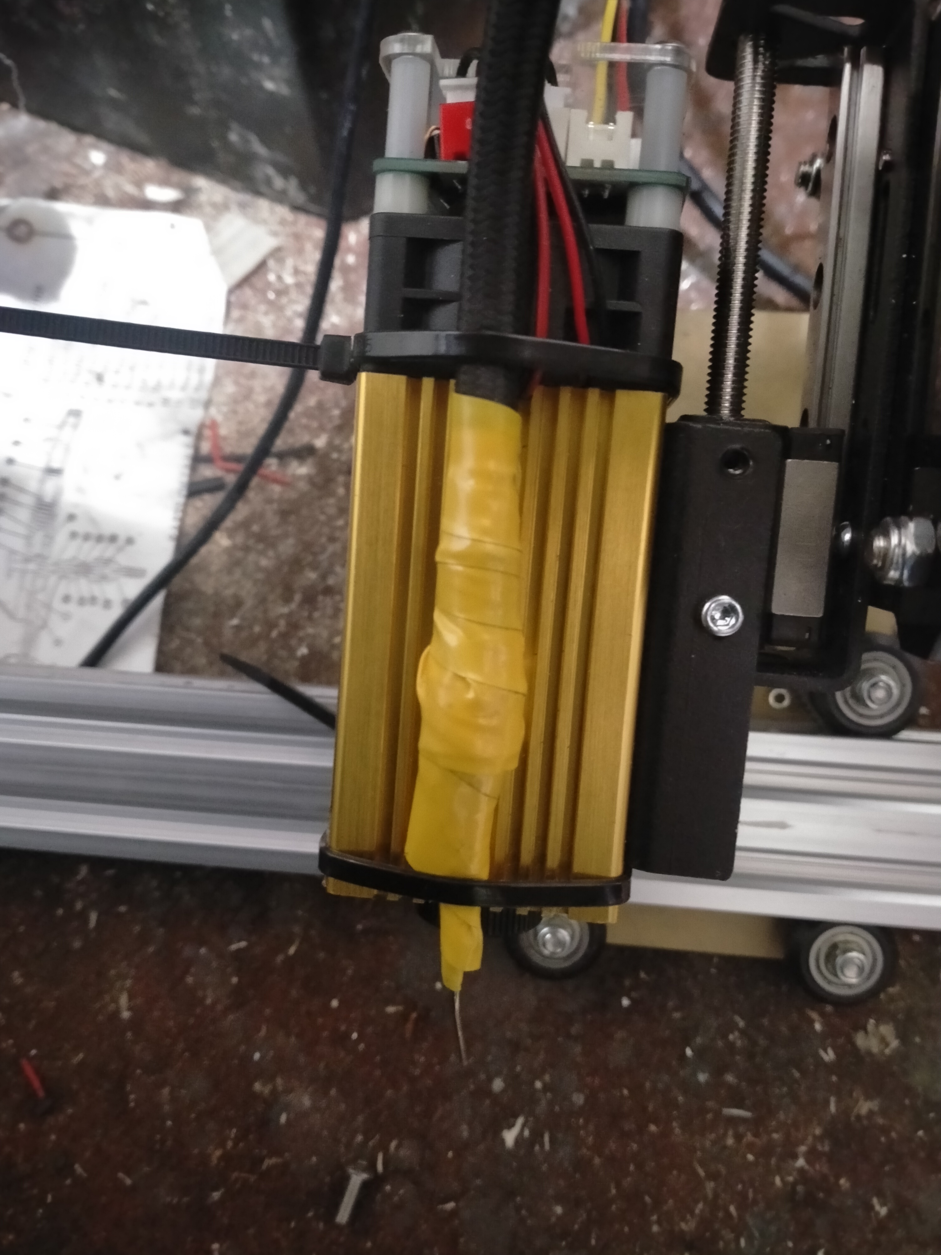

This shows the improvised air assist.

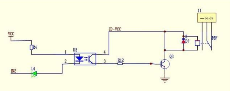

Here’s an example of a relay board that has the ā€œcrowbarā€ diode installed to protect the optocoupler and driver transistor from back-EMF from the coil:
https://www.amazon.com/dp/B0057OC6D8
Here, in the schematic from that page, you can see in red on the right the diode (ā€œD?ā€) that protects the driver transistor (ā€œQ1ā€) and optocoupler (ā€œU3ā€) from back-EMF from the coil.
It doesn’t have protection on the other side because that is application-specific. Some people use two-channel boards for bidirectional motor control of a single DC motor (I don’t like this because then software can connect both sides at once; a short circuit from a software bug) and if it had a crowbar diode, that would be a guaranteed short circuit.
