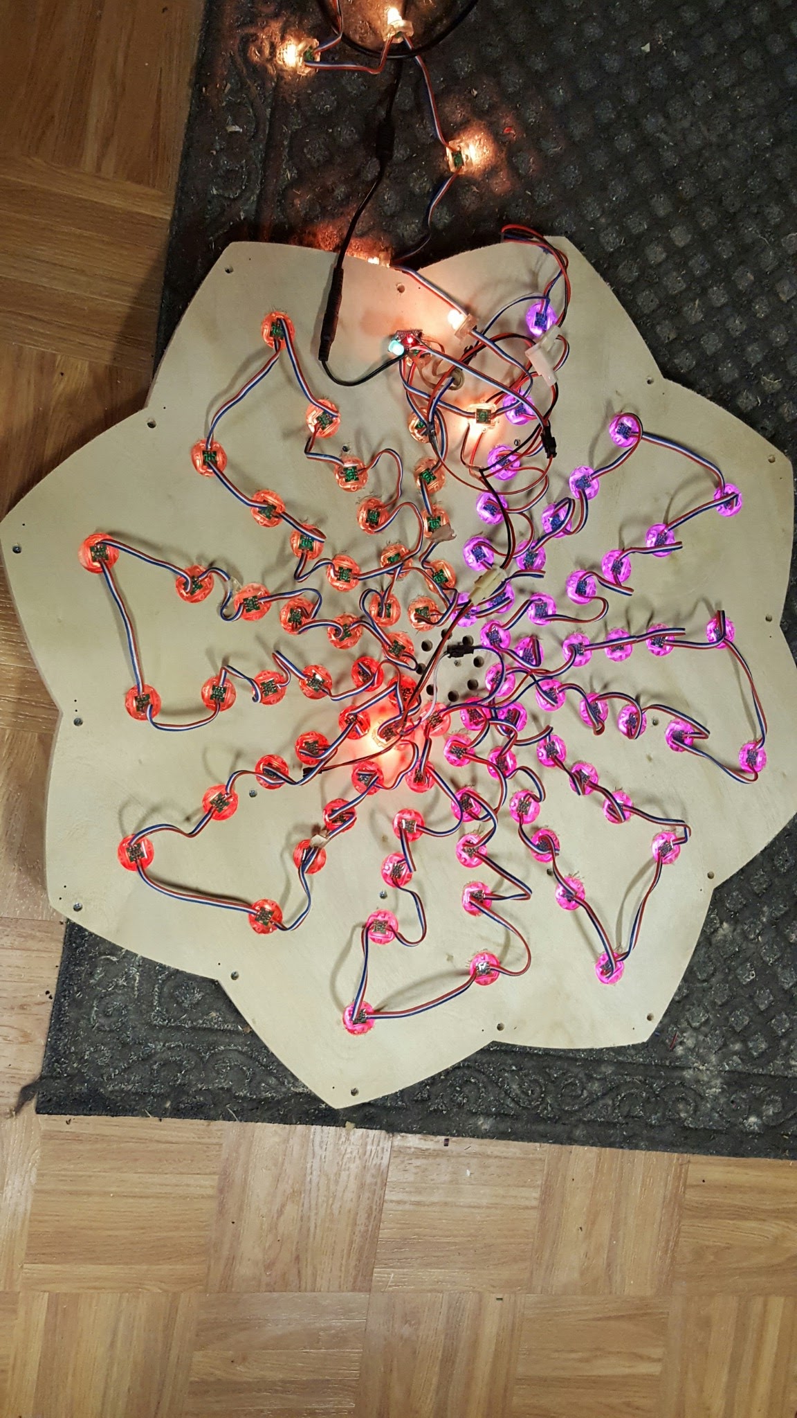

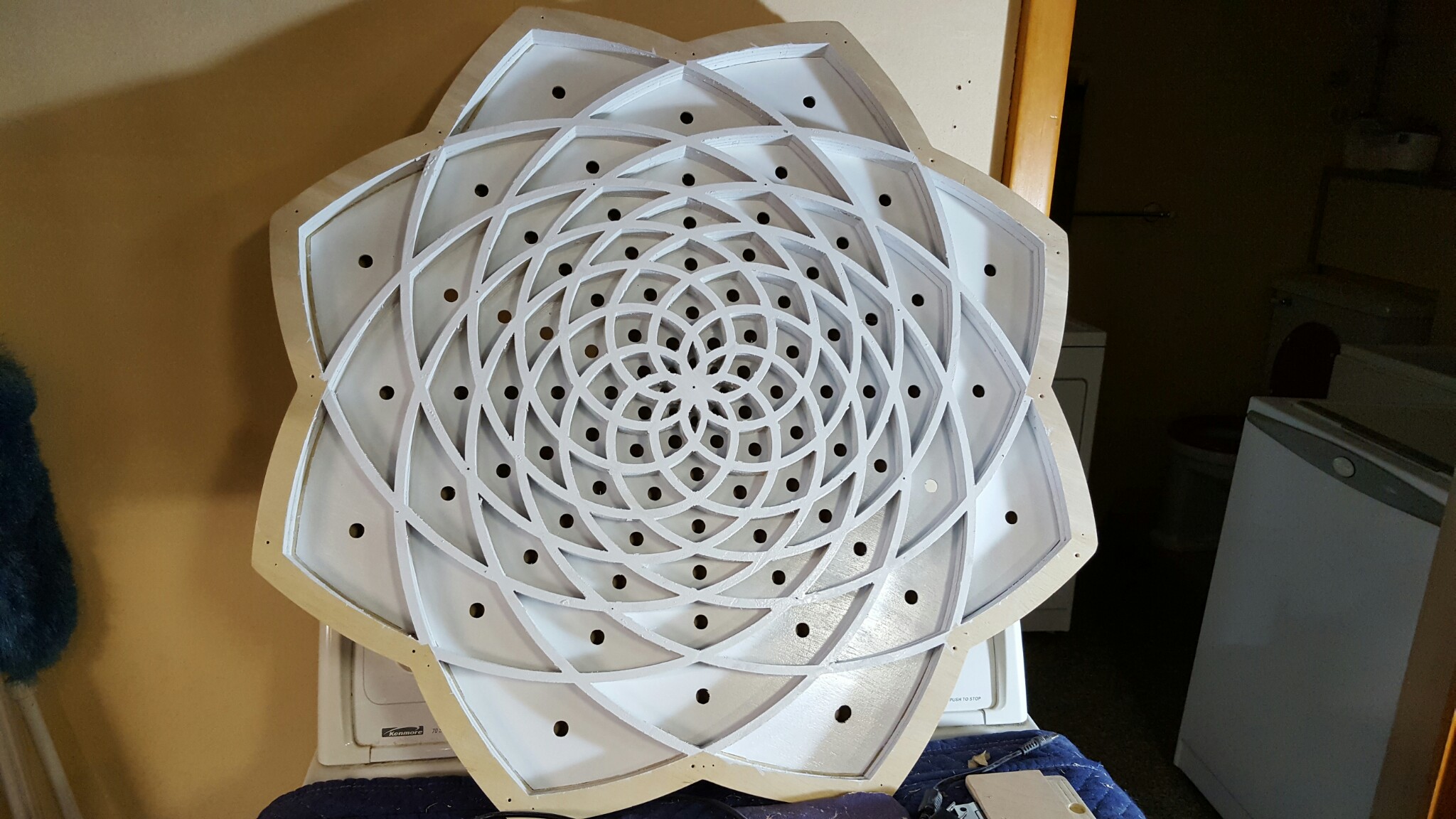

+Ashley M. Kirchner (Norym) here is a picture of some of the insides… All cut on an X-Carve CNC on 1/2" plywood. I don’t share code but would be happy to discuss it or how any patterns were created.
@Ashley_M_Kirchner_No here is the wiring… Minus the center because I had to special order non waterproof ws2811s to fit in there…
So the hearts are an effect of the way you designed the panels… very interesting. Does your code take into account the geometry of your “cells” to create the patterns or did you figure out visually which ones would make a heart shape first?
So that looks like it’s one continuous string, am I seeing that correctly? Yeah I’m curious about the math that goes into this to create those effects.
The pattern is a fibonacci spiral. I saw the hearts in the design and wanted to exploit the them somehow. This pattern just ended up doing so. It’s basically doing a sine wave on each of the individual spirals. Each one is out of phase with the next.
