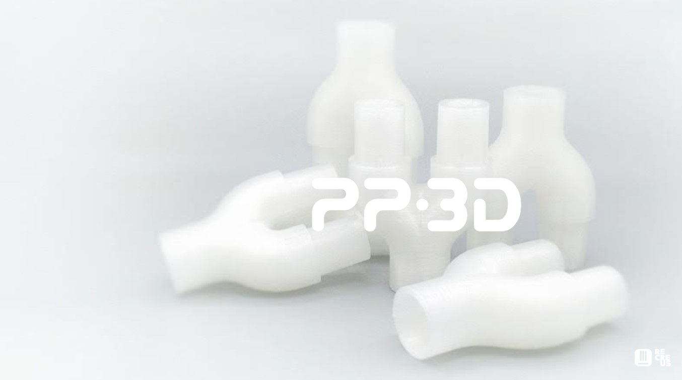

New polypropylene filament — Anyone itching to try out a new "exotic" plastic?
For the primer to be successful, users are advised to wait five minutes after application to allow the primer to dry on the bed. During printing, the bed should be set to 40°C and when the part is finished, cranking it up to 85°C will see the printed part fully released with minimal force required.
