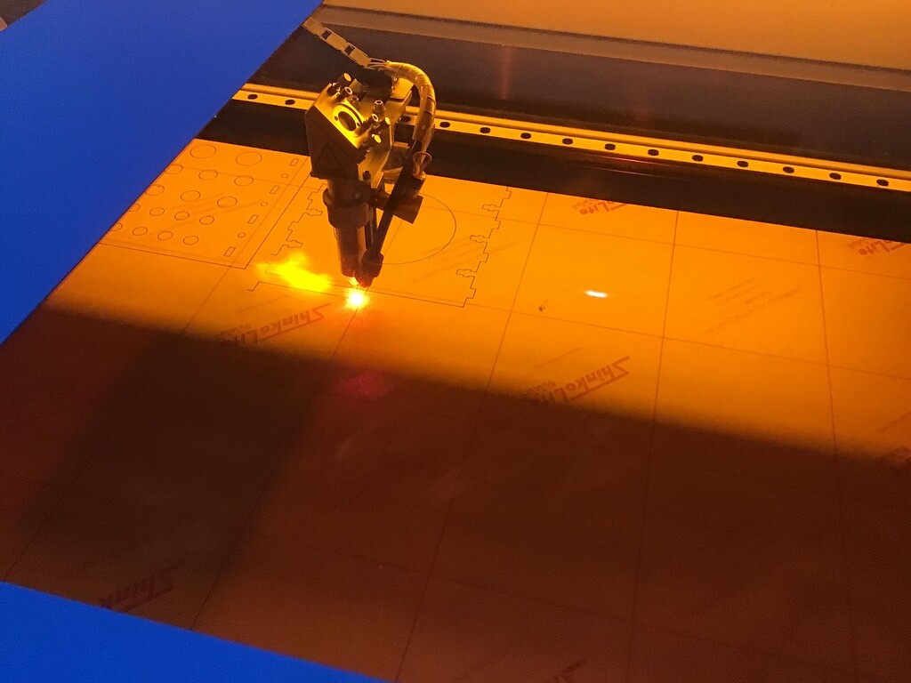

Previously I’ve used Sculpteo for all my laser cutting needs. I’m a twisty puzzle designer, here is my latest design:
And I want to cut 3mm or 1/8" acrylic to make tiles for it. As some of the tiles will be very small I’m afraid they will fall through the support grid Sculpteo uses in their cutters and not make it to me. So I’m looking to do the cutting myself. This is currently the cutter I am looking at:

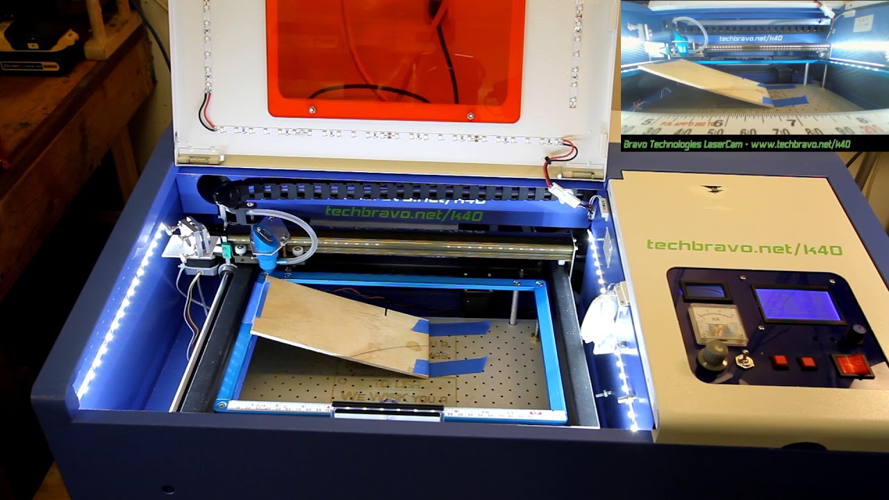

You will need to establish your exact focus point by doing a ramp test for best cutting. Optimum cutting is typically achieved by setting height of your material so that the focus point of the laser beam is halfway into the material being cut.

This is a decent video on doing a ramp test to determine the focus point.

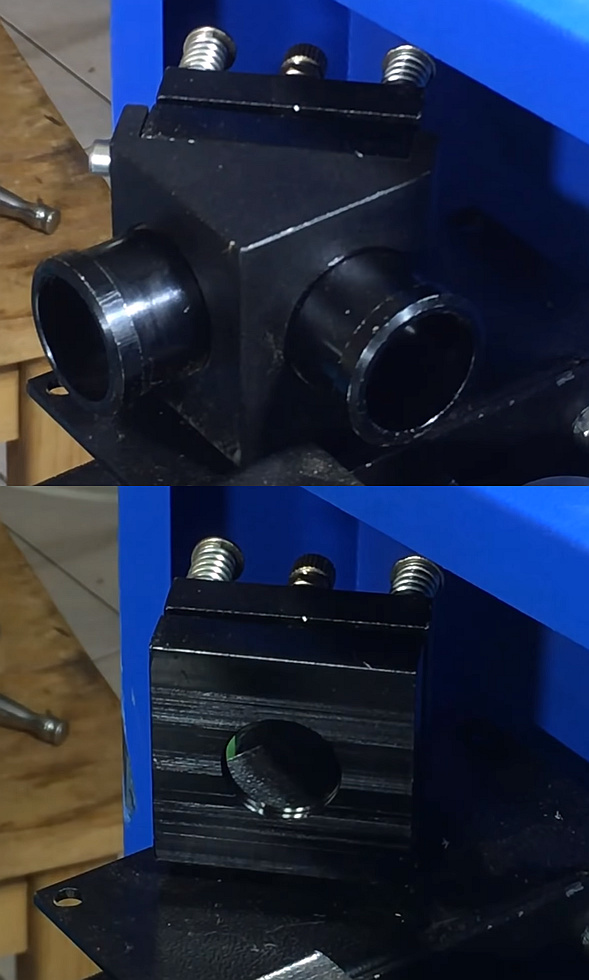

Another question. I’ve been watching this video on mirror alignment:
I notice all his mirrors have these nice protective covers that aid him with the alignment. He tells what you can do if you don’t have these but if you want them, where can you purchase a set of these covers? Here you can see the cover is held onto the mirror mount with a set screw on the left, and the same mirror with the cover removed. So far I haven’t been able to find a set to order.
Thanks,
Carl
Looks like he has a 50w machine. Those have a lot more space than a k40 so there are usually better components. I’m not aware off hand of similar mounts that will fit a K40 but they may exist.
