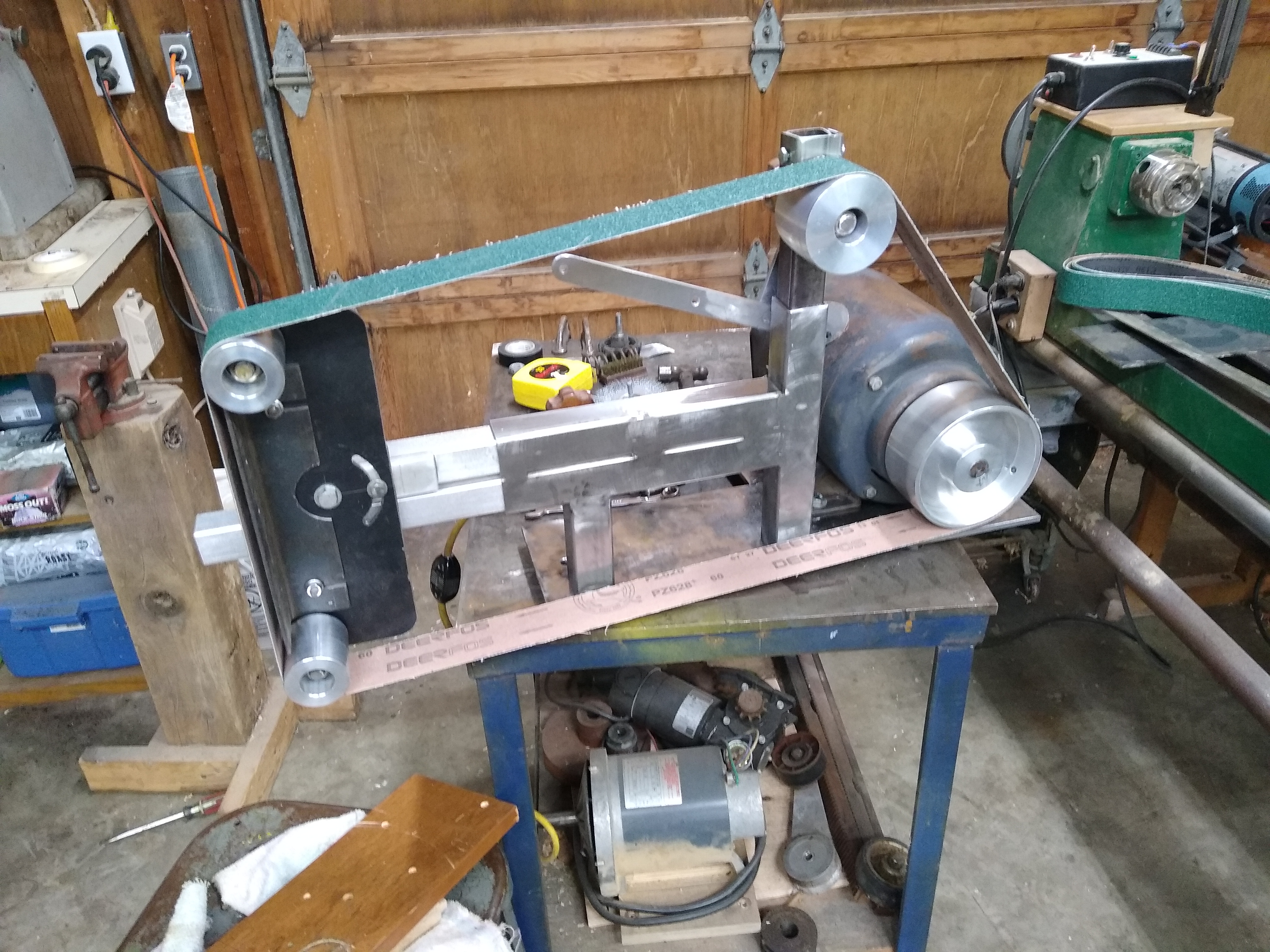

I have been wanting one of these for a while so I decided to build one. My main plan is to try and make some knives but it will also be handy for sharpening and wood working. I will post some new pictures soon. I have the belt tracking but I need to do a few adjustments and then paint everything.

There are a couple of open source grinders out there. I think they both originate from dcknives.com. This is the link to the one I built. http://dcknives.blogspot.com/p/2-x-72-belt-grinder.html Lots of great information on that site.

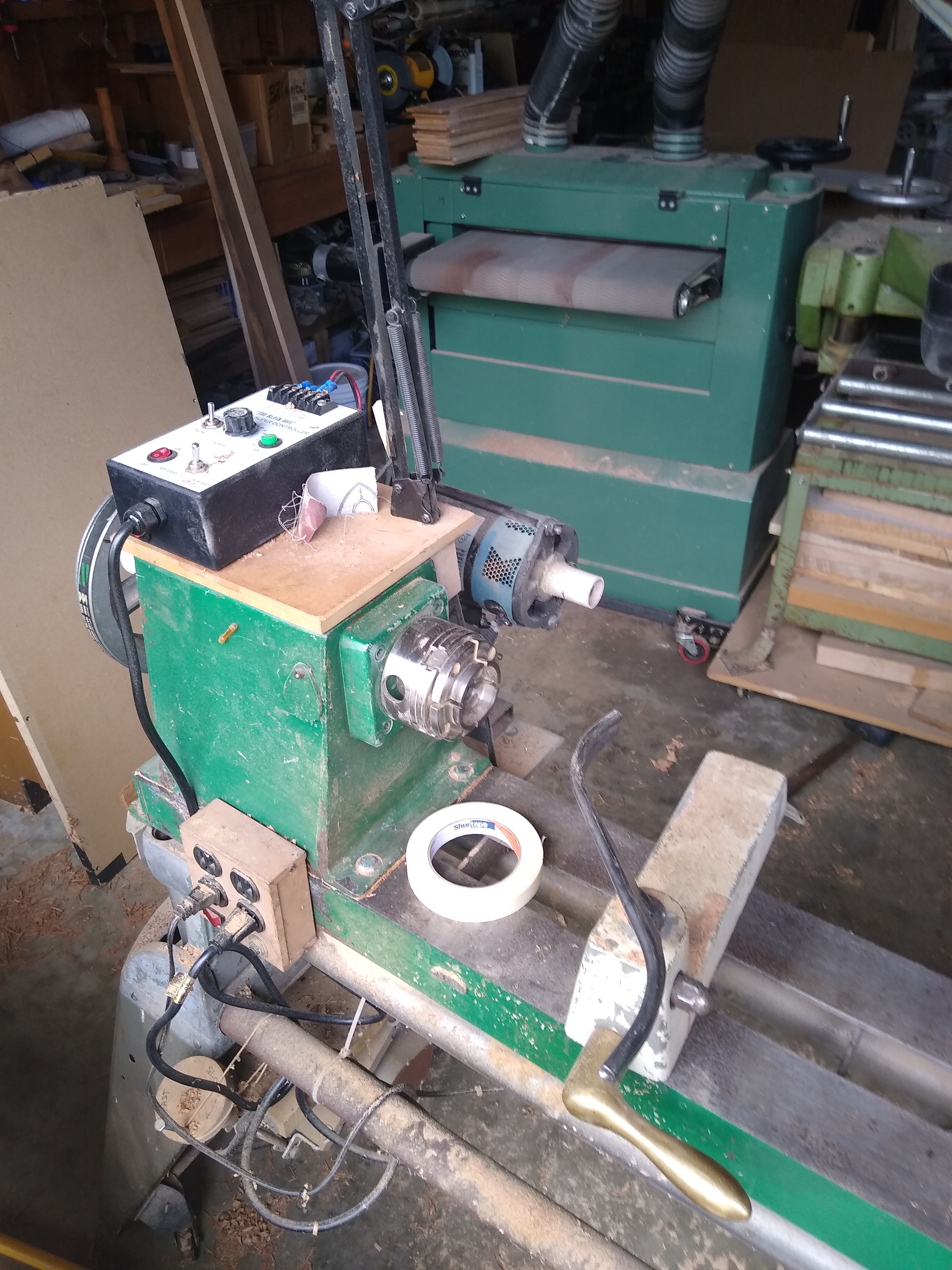

About the treadmill motor. I am a big fan. If you look on the shelf below my grinder in the picture, on the right is a 2.5 hp DC treadmill motor. The gear motor in the middle is also a DC motor used to change the incline. Currently I have a 2 hp DC motor on my lathe.
It is not a very good picture but you can see the control box on top. This is the one I bought https://www.ebay.com/itm/303159304376 I originally modified the control board from the treadmill but it burned out after a few months of use. I am not sure why. I used this Instructable to figure out how to use the existing controller board. It was fairly easy and all I had to buy was a 10k potentiometer.

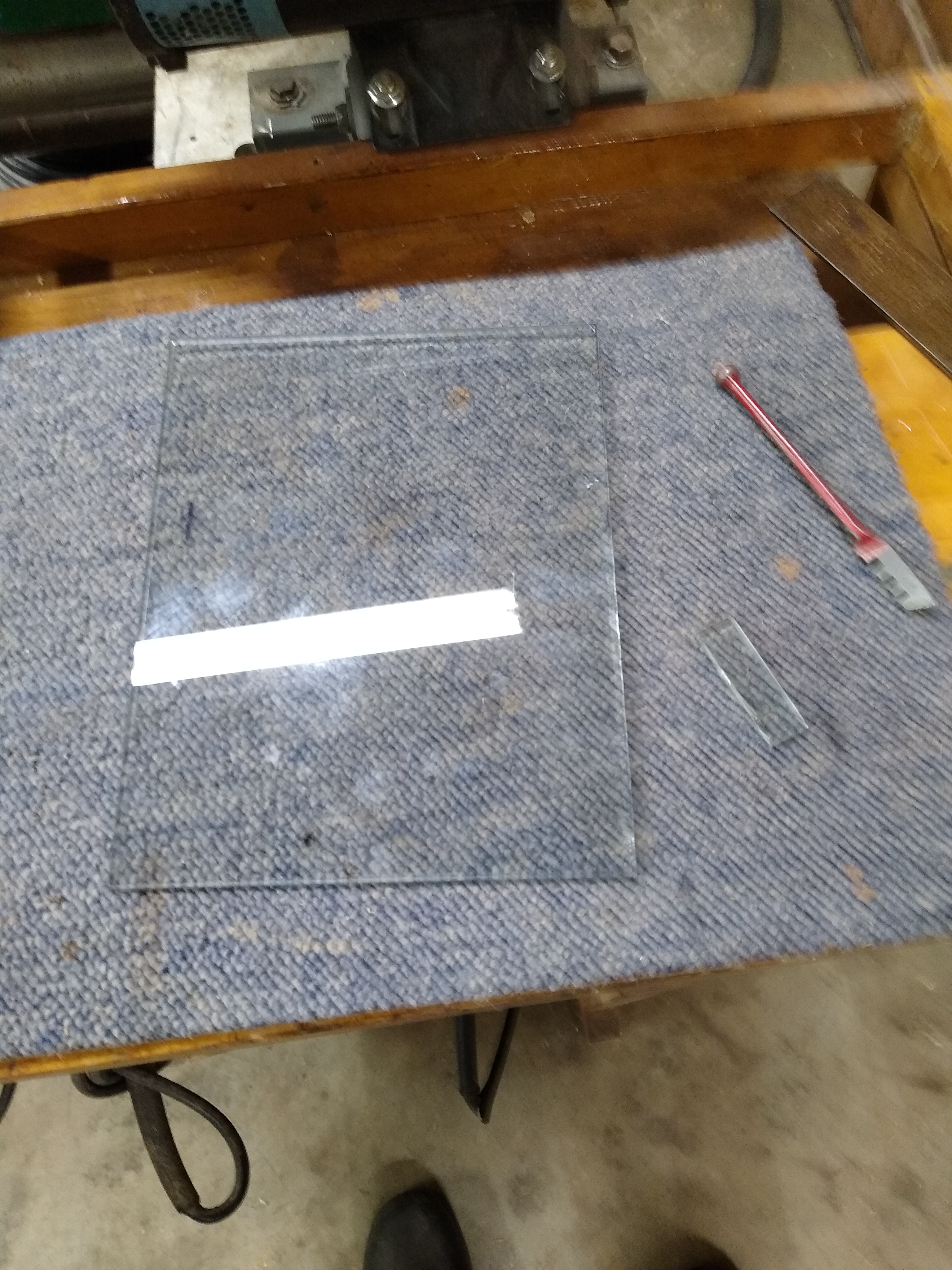

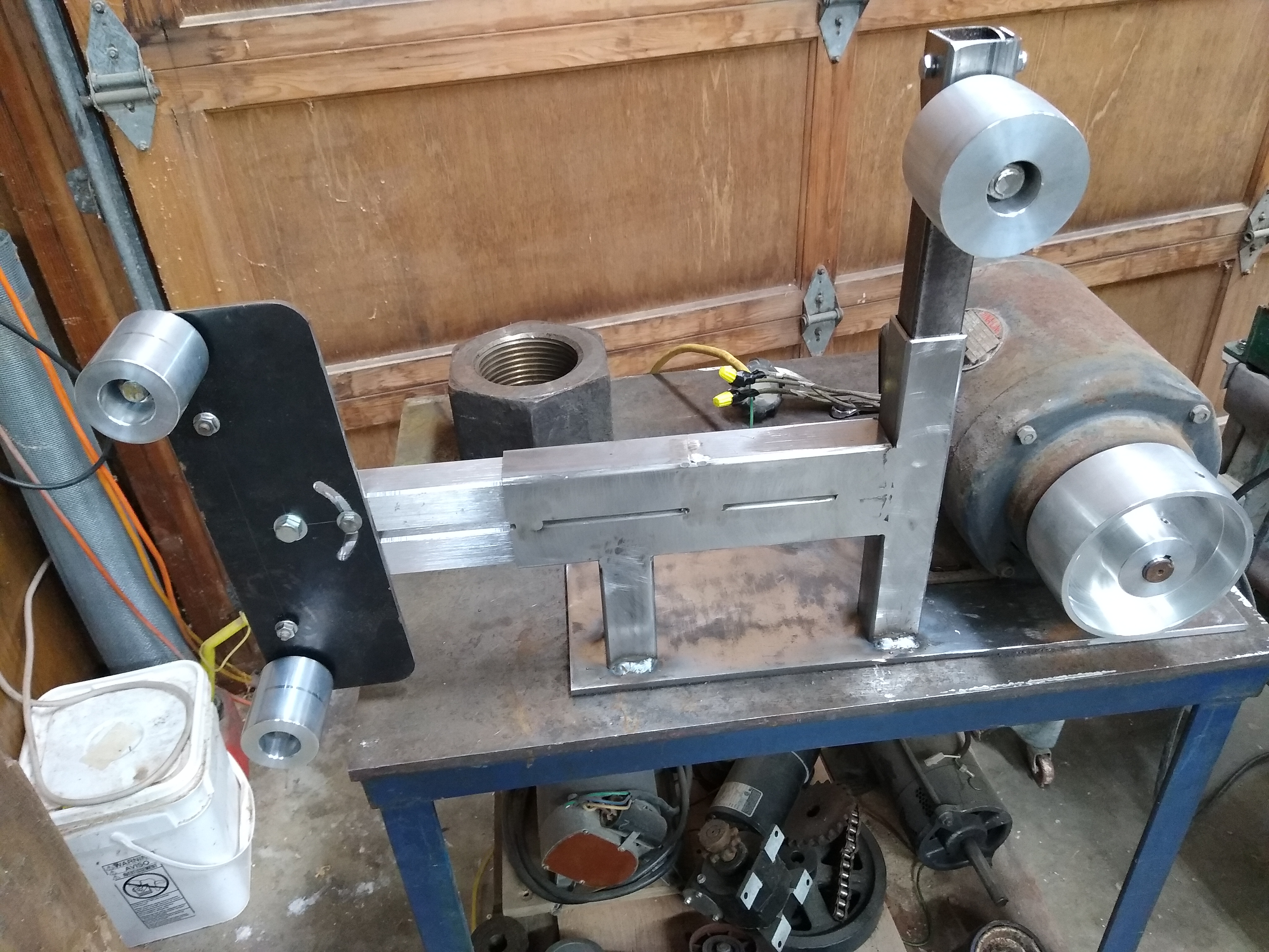

Here are a couple more pictures of the belt grinder. I have just a few more things to add to it. I am going to put a glass platen on it and I need to make a tool rest for it.
I just finished gluing on my glass platen. I could have just bought one from usaknifemaker but I am always looking for a deal. As far as I can tell, it is just borosilicate glass. So I just ordered a glass build plate for an Ender 5 3d printer. I will be able to get 4 platens for the same price. BTW Plans for the design you show are available on this website.
