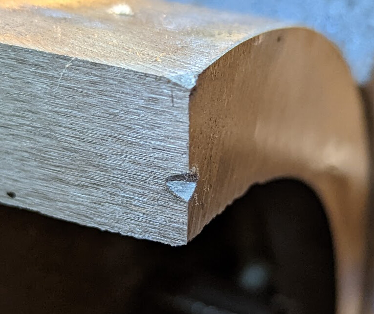

It took some fettling to finish. There was one particular ding on the bottom that particularly needed some work:
A parallel rocked when set across that ding, so I had to file it out without mangling the rest of the bottom.
