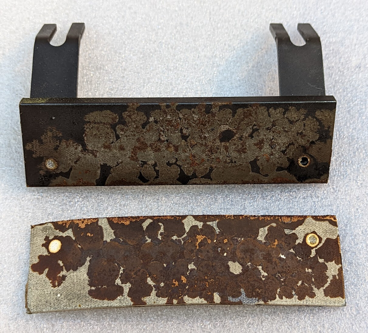

The provided graphite coating was soft, and the adhesive was perished, so it peeled away with almost no effort, revealing significant rust.
It took several skim passes with the face mill before I had a good surface.
Because this was still coated in mill scale, I used regular inserts instead of polished inserts. This didn’t leave as smooth a surface, but that’s probably better for an adhesive holding on to it anyway.
I could have just polished it, since silicone would fill the gaps and make it all smooth, but what’s the point of having a face mill if I don’t use it?

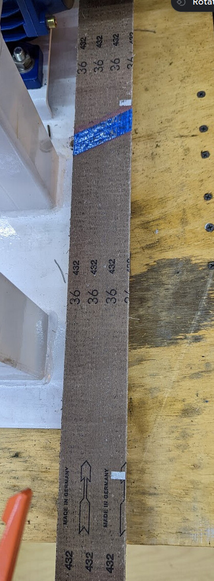

I asked Red Label about their EdgeCore ceramic belts and HSS, and they quickly responded:
We recommend any hardened steels for a minimum to be around the 1500 to 2500 SFPM. However those Ceramic belts should perform the best in the 3600-4500 area, but it can also depend on the grit:
Coarser belts around 36 grit → 4500 SFPM
80 and 120 grit → 3600 SFPM

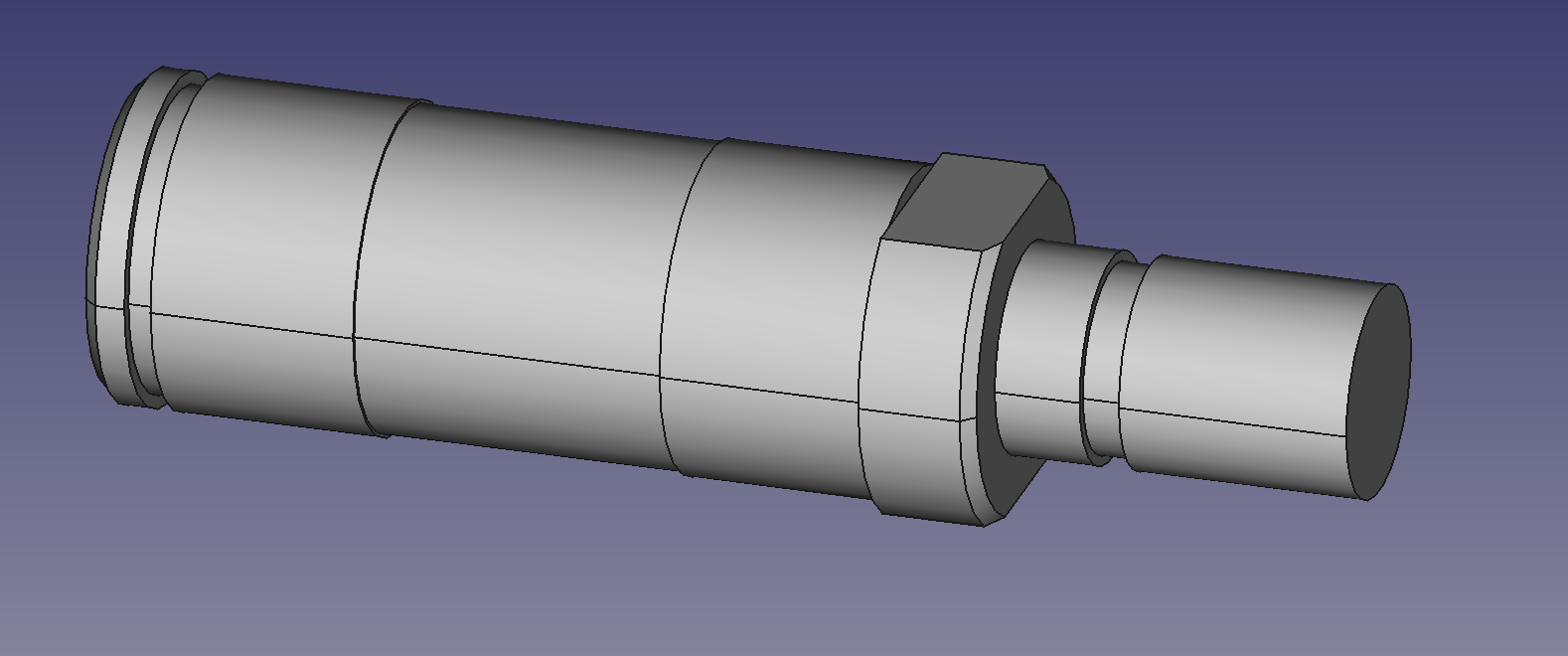

Without modeling the threads, here’s the existing axle:
I would instead make this similar shape:
This ought to be within my abilities to make on the lathe, plus the mill to cut the flats.
It works.
I took a “short cut” of putting the wheel on and scribing the edge of the wheel to know where to put the circlip groove instead of measuring it, not realizing that it was the outer edge of the groove that was critical so that it the circlip would bear against the wheel and keep it from shifting back and forth. (I worked around that with a small spacer.) Other than that mistake, it works well.
I didn’t bother with the narrow section of relief in the axle. I made the non-critical widest dimension wider, 30 mm instead of 27, because it just didn’t matter and why not have more shoulder?
I die-cut the threads in order to not fiddle with change gears. If I had this to do over I might change the change gears and single-point the threads just for the fun of it, but the die worked fine.
Here’s the model and drawing I would start from if I had to do this over again. It has more chamfers in it, and it identifies the critical dimensions.

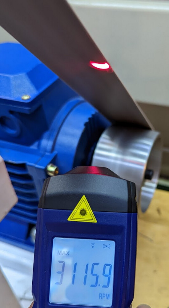

Here is full speed. This is actually reading SFM not RPM:

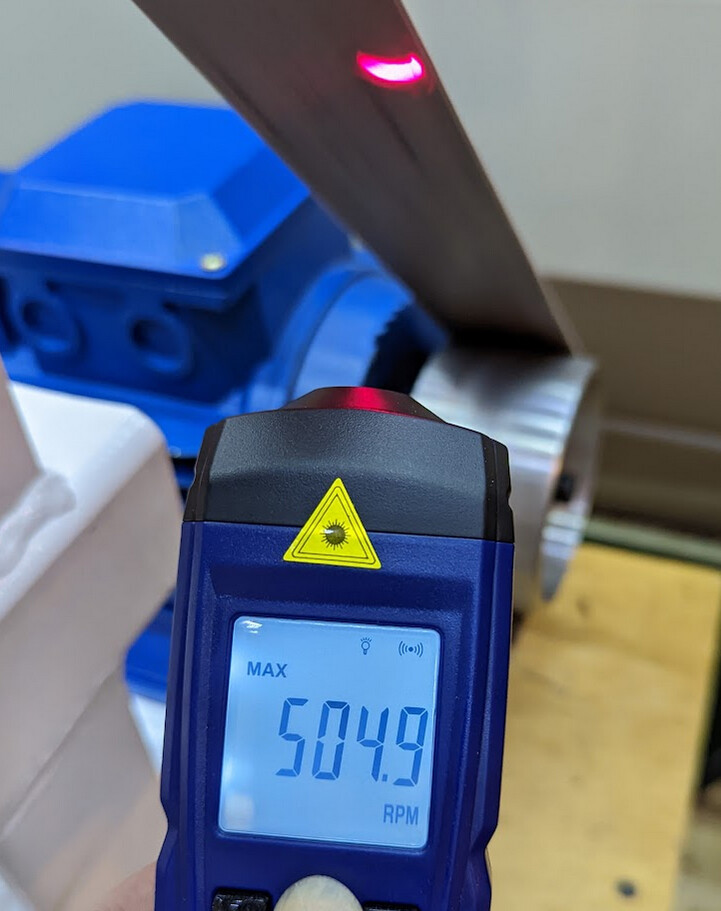

Running more sedately:
