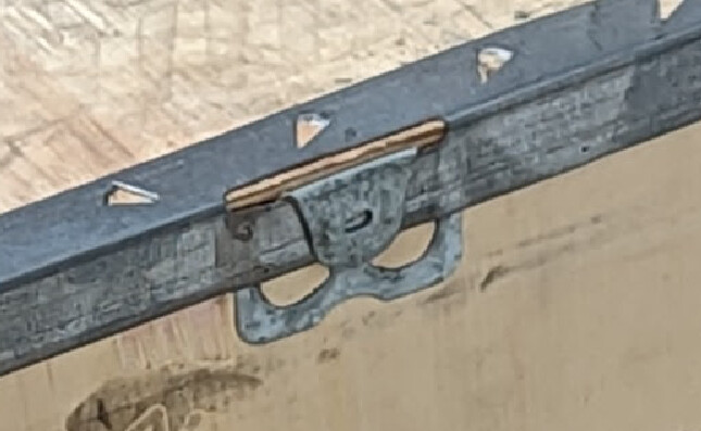

The unit was intact inside the crate, which was sturdy, and used folding metal clips to hold together:

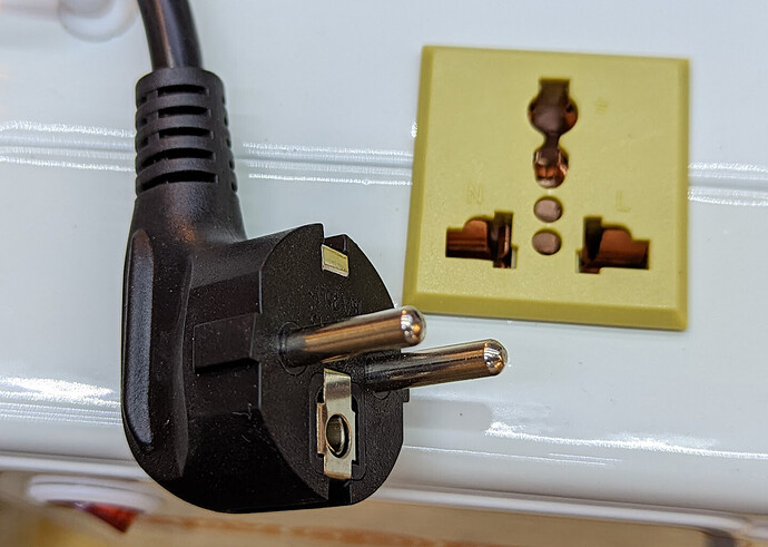

It is advertised as a 120V unit. I was intrigued; I’d expect to want 240V to drive a three-phase VFD. Turns out it ships with a 120-240V transformer in a box. The VFD has a euro-style plug without a ground pin, plugging into a receptacle that supplies a ground but without a pin to connect ground. Not awesome.
I’ll probably eventually run a 240V outlet and wire it directly, including a ground wire. But 12A @ 120V is OK; my shop outlets are 20A.

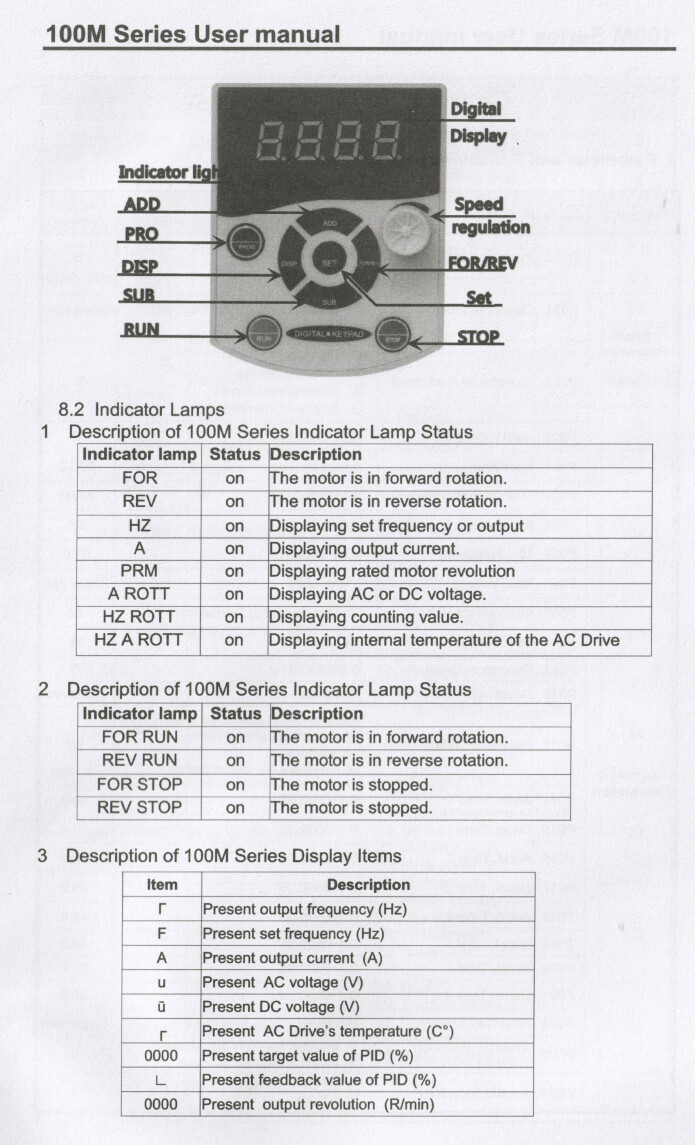

It says to try to keep grinding dust out of the VFD. Well, yeah. Turns out that the VFD has a control panel that can be removed form the case and remoted through an ethernet cable. This means that the VFD can be mounted away from grinding dust, and the mostly-sealed control panel mounted near or on the unit.
The VFD did come pre-programmed correctly for the unit, as far as I can tell, and included the instruction manual for the VFD, with plenty of detail including RS485 modbus protocol information in it. Might be a nice VFD to keep in mind for other projects to be honest!

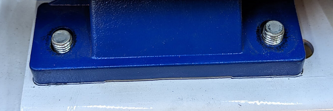

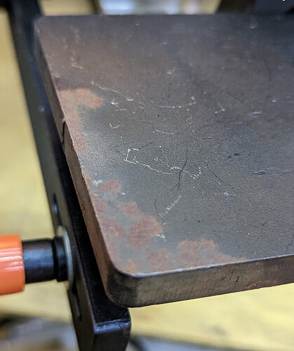

Things looked pretty good, everything packed well in the crate, until I got it up on the bench.

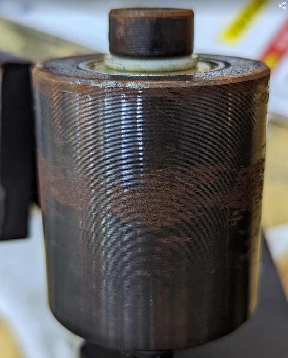

Every wonder why your import tools are covered with thick grease? Here’s your answer for a tool that sadly wasn’t so protected!
I treated all the surface rust with Corrosion-X to stop the rusting.
I missed getting a picture, but the 200N gas spring also had a lot of surface rust.

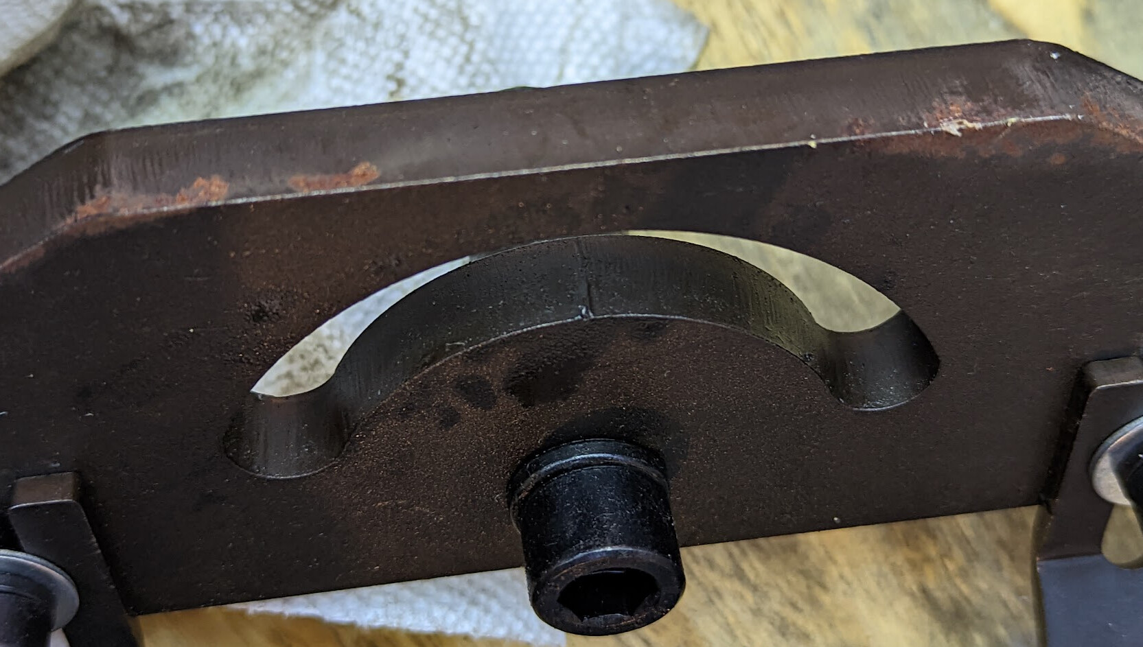

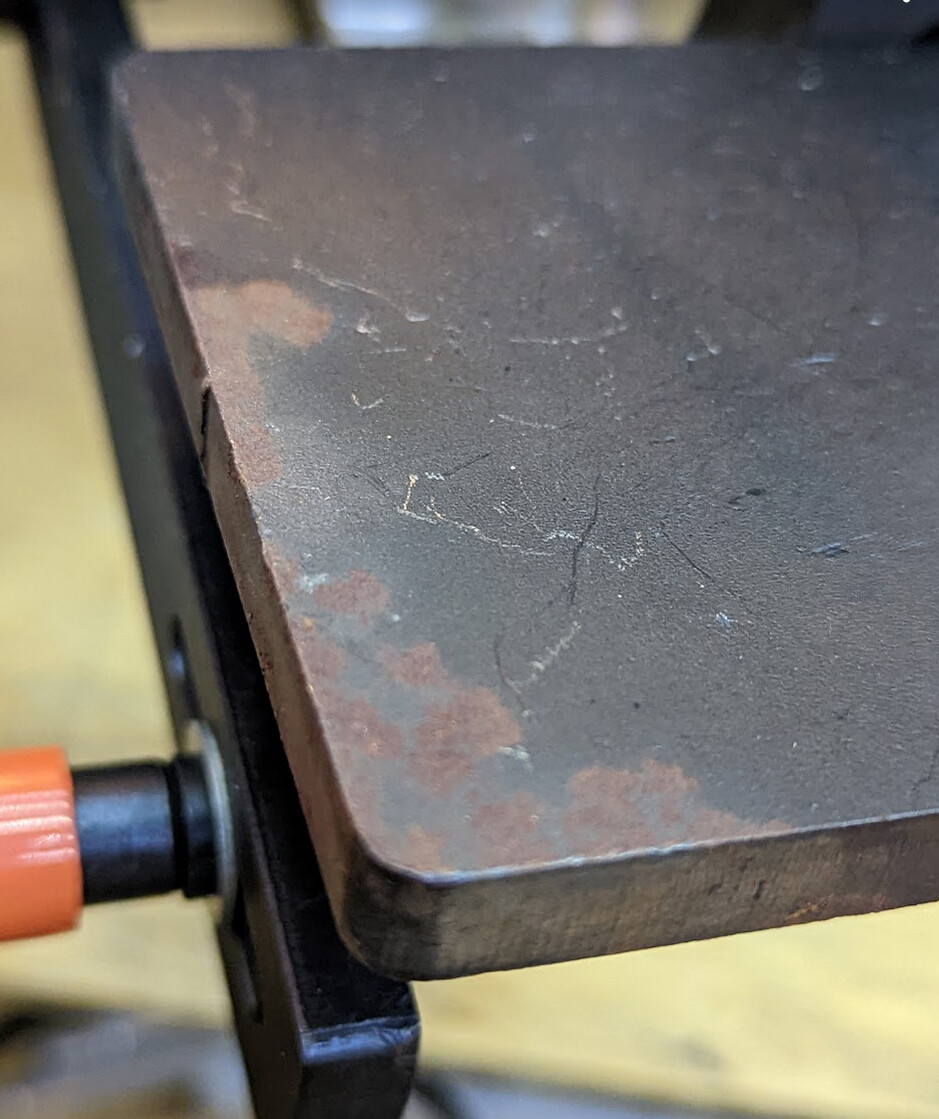

The welding on the table looks worse than my welds. I’m not sure yet what I’ll do with the table, but I’ll probably do something for precision angles for grinding HSS blanks for my lathe.

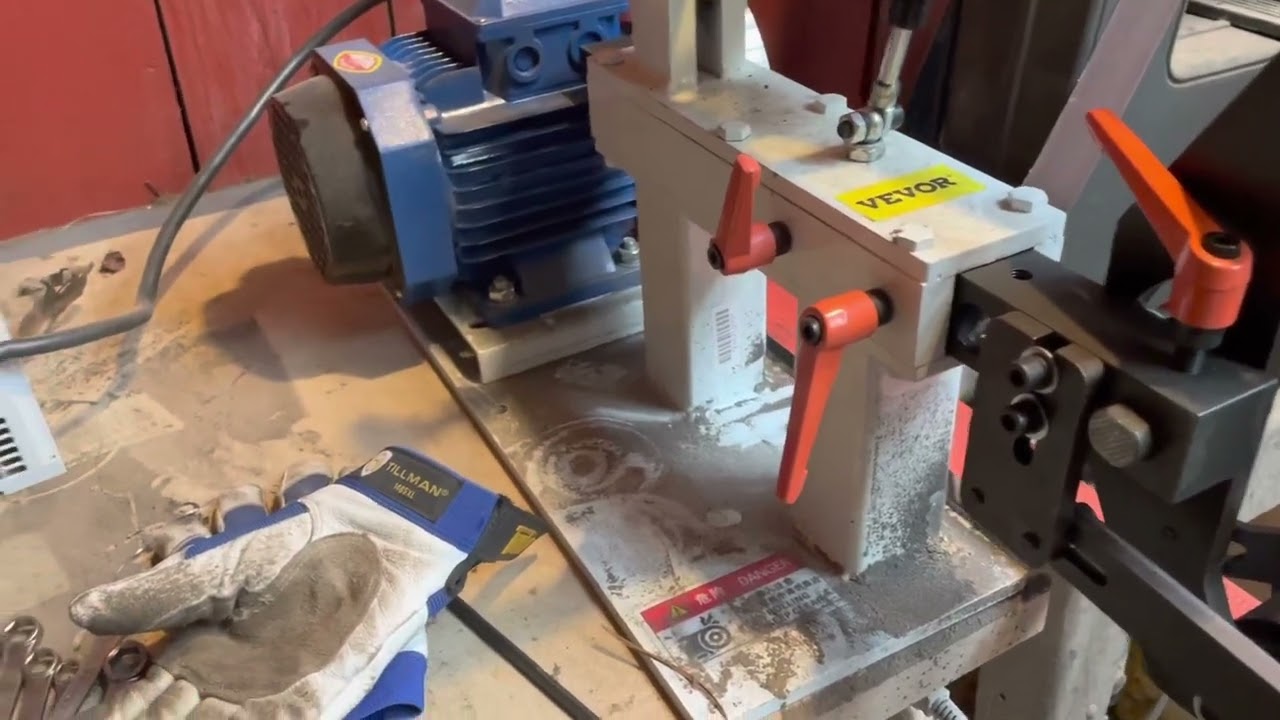

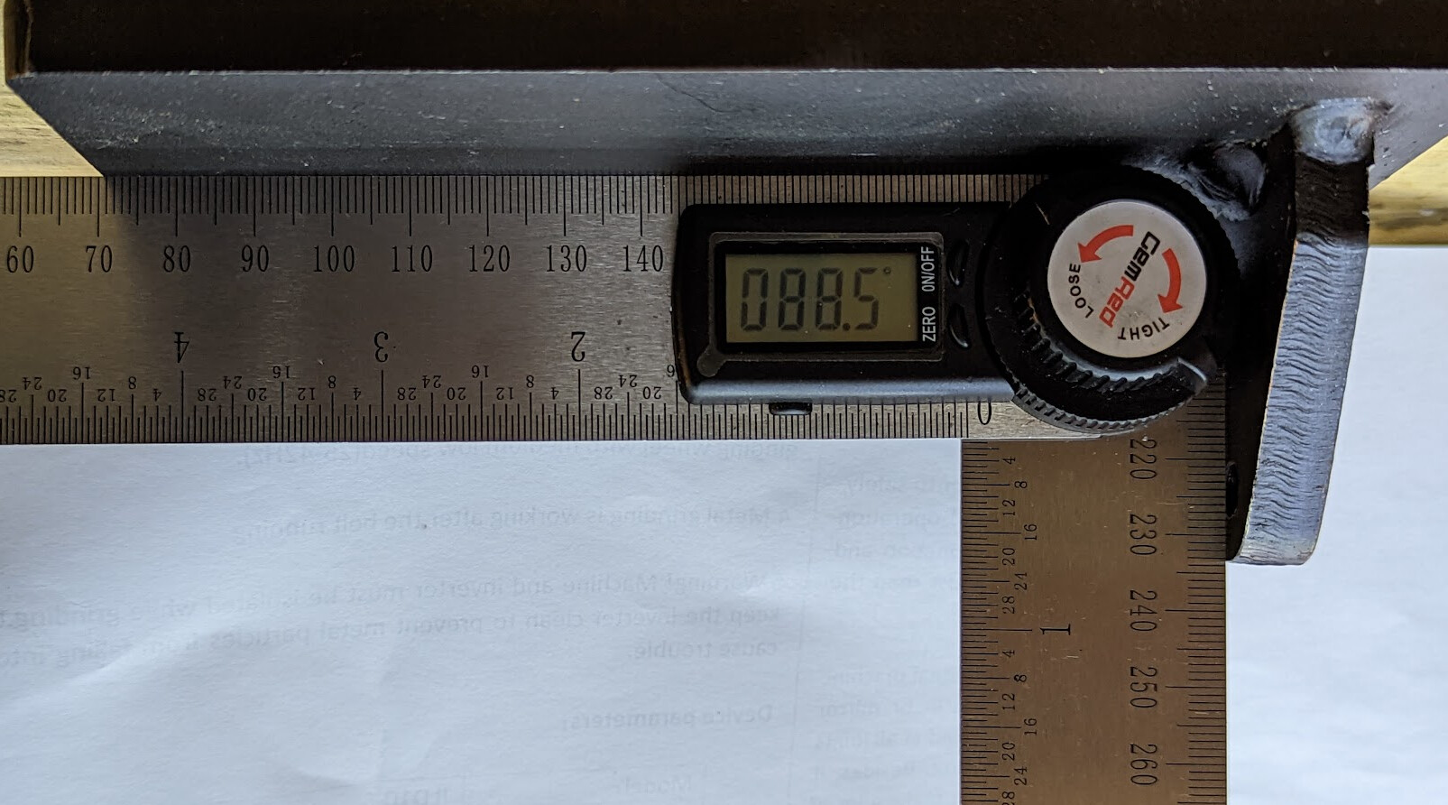

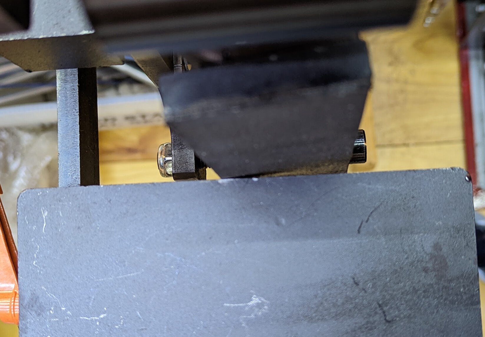

Mostly I expect to use the flat platen. The platen and at least upper roller are not square to the machine. This looks like more work:

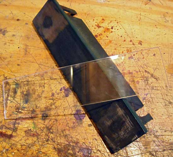

The platen is graphite coated. I’ve ordered a 2" x 6" ceramic platen liner to replace it and will add a safety shelf when I install it:

The only endmill I had long enough to fix the off-square table mount was a large “corncob” roughing mill. It didn’t leave a smooth finish, but it’s at least true. Their welding jig was so off-square that I had to remove 1mm from the side that interfaces with the arm to make it square.
I can measure the other, untouched, side later for how many degrees it was off square. But at least now it mounts square after facing that side in the mill.
The edges of the table appeared not to have been dressed. The edge was raised and dinged, and the laser-cut tab wasn’t finished. Took a few minutes of careful filing to properly fettle the table.

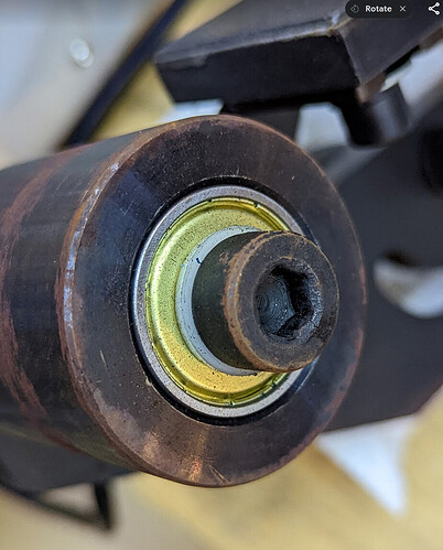

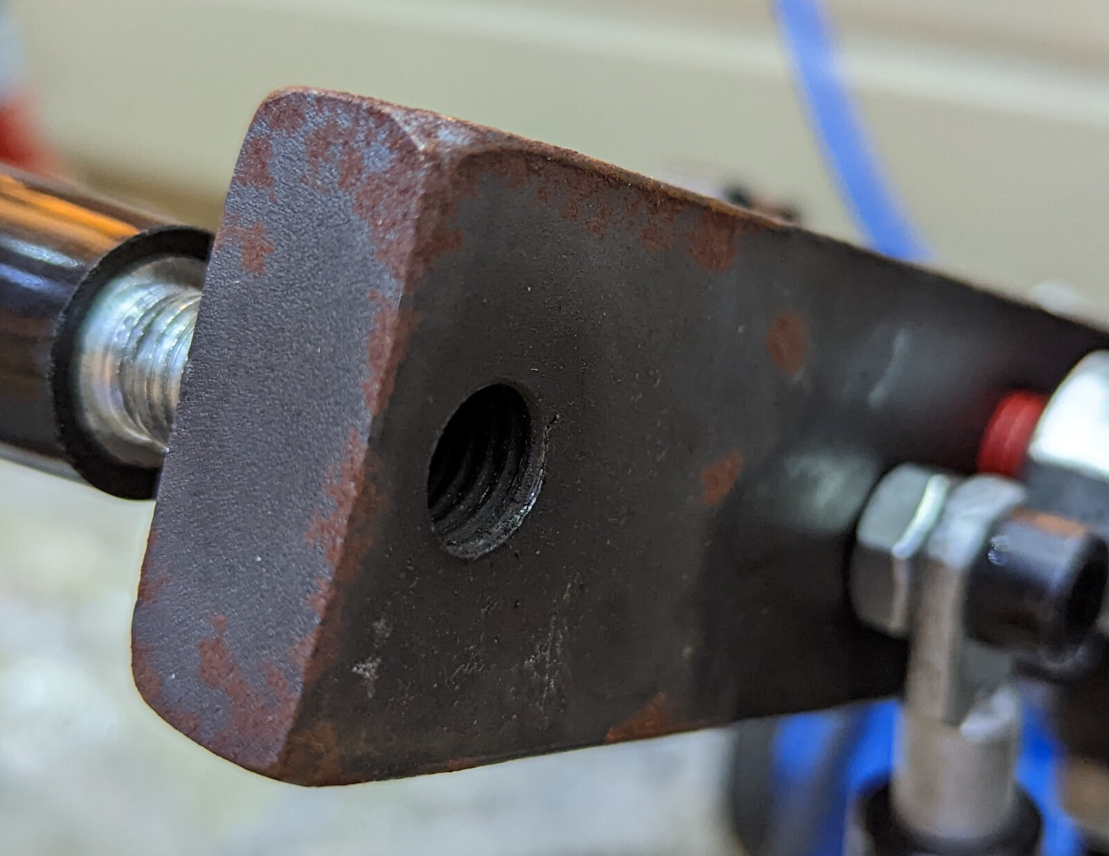

I think that the mounting hole for the upper roller is not straight; I don’t think it’s just a bent screw. I’m thinking about turning new shoulder bolts on the lathe that will be strong and register the shoulder on the platten arm to make them run square. I’ll have to look through my round stock for the right pieces for that work.
The angle brackets that mount the platen just aren’t 90° angles. I think I’ll try to bend them square in my vice; they are thin enough already that cutting them thinner to square them is probably a bad idea.

The tracking wheel and driving wheel were both specified as 4" but that’s not right. The tracking wheel is 5" nominal (about 125mm) and the drive wheel is about 220mm.

I managed to carefully bend the platen brackets from 85° to much closer to 90°
I removed the upper wheel and confirmed that the screw was not bent in shipping; the screw hole is just not straight. But it’s so far off straight (2°) that my shoulder bolt idea won’t work. All I can think of is to bore it out and pressure fit a bushing in and re-do the hole straight.
The RPM is misconfigured on the VFD (though I don’t know by how much) and I’m curious whether I could change the parameters so that it actually displays SFM which I care about more anyway.
Sorry to hear that your bargain was not such a bargain with all the work you are having to do to make it usable. In the end I know it will be better than the expensive ones and you will know every nook and cranny of the machine!
OK, setting P143 is number of poles. It’s set to the default 4, with an allowed range of 2–10. By shooting a video with 60RPM commanded, I could see that it made about 18 revolutions in about 10.4 seconds, rather than the commanded 10.4 revolutions. That’s pretty close to half the commanded speed, and there is obviously an integer number of poles in the motor!
Looking at the motor data plate, I see “TYPE YS90S-2” and the “-2” part of the type means that it is in fact a two-pole motor rather than the four-pole configured.
220mm diameter is just over 2 feet circumference, about 27.2 inches.
This means that when displaying 60RPM, it should actually be going 120RPM, giving almost 230 SFM or 45 inches per second.
So if I leave it configured this way, I’ll know that 75% of the displayed number is a good approximation of inches per second. :smiling_face:
Later…
I realized that telling it that the motor has 5 poles should display 48RPM by my math, so I tried it.
Changing the configured number of poles does not change the RPM reading at all. I tried 2, 4, and 5 and it didn’t change the RPM reading.
It turns out that it’s actually an asynchronous motor, so the frequency doesn’t directly control RPM, and the VFD can’t sense actual RPM via back-EMF.
The frequency doesn’t matter. It apparently varies the voltage with the frequency, and it has a mode for displaying the AC voltage it is providing. I have not validated this with a multimeter.
So I’ll just give up on measurement for now. :smiling_face:

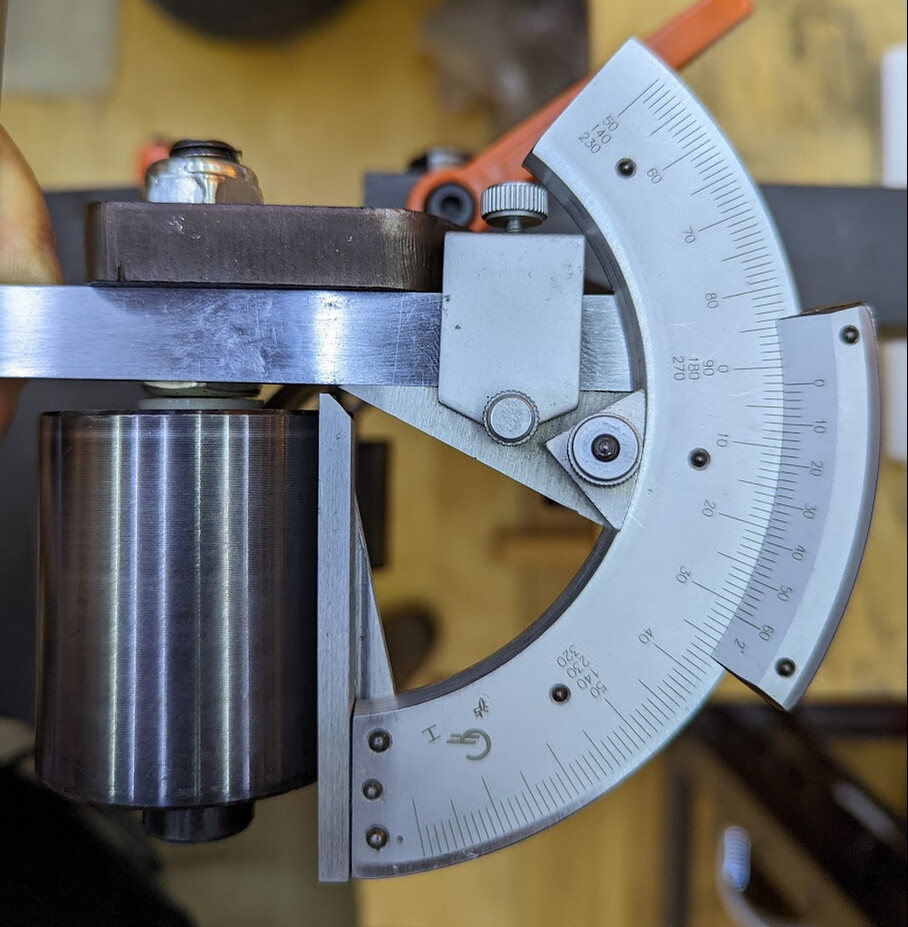

It was 1.5° off square before I milled it:
The wheel is about 2° off square:
Vevor support asked for pictures so I sent them some. I’ll post updates with what they say.

The correct socket for that europe schuko plug would have a ground pin (or a ground spring on the side) and this plug is usualy used for 240V 50Hz AC.
@cprezzi yeah, I’ve definitely seen those when I’ve traveled on your side of the Big Pond. :smiling_face: I thought about turning down a piece of brass to make a ground pin but decided I’d just rather not use the transformer at all.

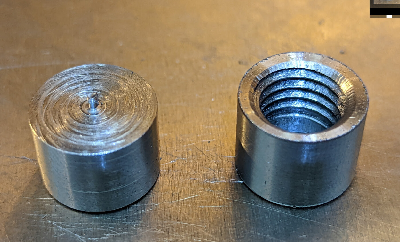

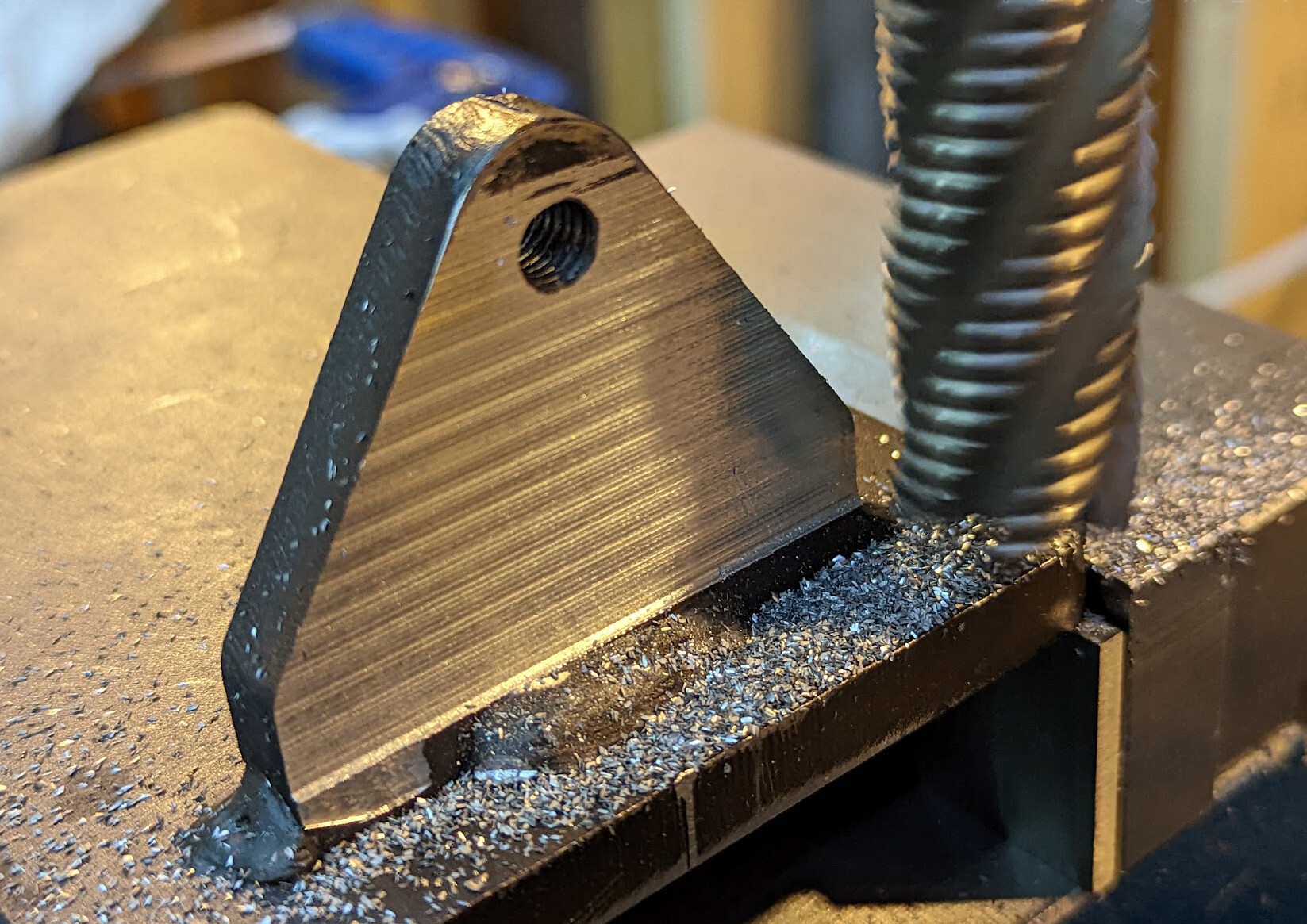

The platen wheels are mounted on M12 x 1.75 screws. The thread in the upper mounting hole is a bit chowdered. I should be able to center on the existing hole, run a 1/2" end mill through to get the hole straight, then drill 37/64 and tap M16 x 1.5.
Then on the lathe I can make a threaded bushing. I have some 1" 1117 CRS stock I can use for this.
That narrower section at the end will have the matching M16 x 1.5 thread externally, and the part will be drilled through 13/32" and tapped M12 x 1.75 to match the bolt that carries the wheel. I can loctite the threaded bushing into the bracket, and the shoulder will help carry the load, so this is perhaps ultimately better than the original design.
Of course now I find that a 37/64" drill (which I have) is the right size for 75% thread engagement recommended for aluminum, and 19/32" (which I don’t have) would provide the 50% thread engagement recommended for steel. If I have to, I can get out the boring head, but I’m hoping that a merely 10mm deep hole and plenty of cutting fluid will get me through. And I’d prefer to have the max thread engagement possible for strength.

Crooked idler repair appears to have been successful.
I clamped the bracket arm in my mill vice and held up the end with a machinists jack. Centered on the hole the best I could and plunged a 1/2" end mill through it to get a straight hole.
Then I found some 5/8" stock. That gives me 1/16" on each side to hold threads. But I don’t have an undersized 5/8" reamer. I had a choice between the fast way of turning larger stock down to oversize to use with my 5/8" reamer, or the slow way of making a custom hole with the boring head on the mill.
Of course I chose the slow way, by way of practice for when I really need to hit an odd dimension.
I skimmed the stock with a ground insert about 1" long. Then I turned a section about 1/2" long about .0015 thinner, and then about 1/4" about .005 thinner than the main section. I parted off just barely into the full width section to make a go/no-go gauge. Then I drilled half an inch deep 13/32" and tapped as far as I could with an M12x1.75 taper tap, and parted it off the thickness of the plate (about 10mm).
Here are the gauge and the partially-threaded bushing:
You can probably just barely make out the two lines on the gauge where the diameter steps are.
I then used the boring head to get close to the plug size, and then crept .002" until I could fit the .005" undersized section, then .001" at a time until I could just barely fit the .0015" undersized section into the hole.
I used the hydraulic press to press the bushing into the newly-bored hole, and then finished tapping.
As you can see, I don’t have a de-roughing tool for putting mill scale back on. :grin:
