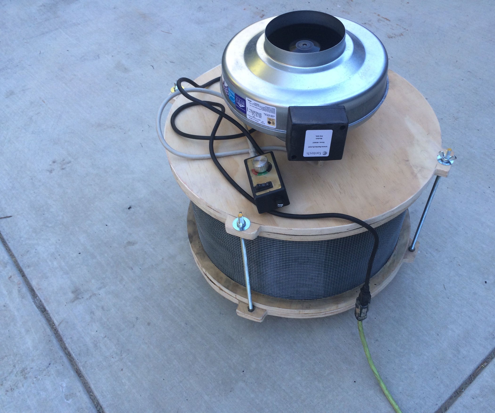

I’ve seen examples of people making DIY fume filters with particulate prefilters followed by activated carbon chemical absorbing medium. A good high efficiency particulate prefilter would be key to keep the activated carbon from plugging up to quickly

In our fablab we have built a filter system with 3 stages. 1st stage is high voltage ionizing, 2nd stage is a industrial fleece mat filter and the 3rd stage is a large activated carbon filter flanged to an industrial blower. The output is still vented outside.
The high voltage ionizing helps to build up bigger clusters of small vapor, which then can be captured in the fleece filter, instead of clogging the activated carbon.
Sounds interesting, but how to check if it works efficient enough and keeps the unwanted from the inside air if the final vent out is not possible. And how do you plan the maintenance cycle.
That sounds a bit difficult to me. I’m living in a house together with others and so would share the risk… I think I’ll stay wih my router bits… even, if it would be a bit slower!
I would not recomend blowing the output into the room. After a year of operation, we can see at the fins of our blower that there is still unwanted dust in the output (that I wouldn’t want to breath).
For early maintenance indication we have added pressure sensors between the 3 stages so we can predict when the filters need maintenance. Whithout this, it’s impossible to predict how long the filters will last, because it’s depending on the material you cut or engrave.
