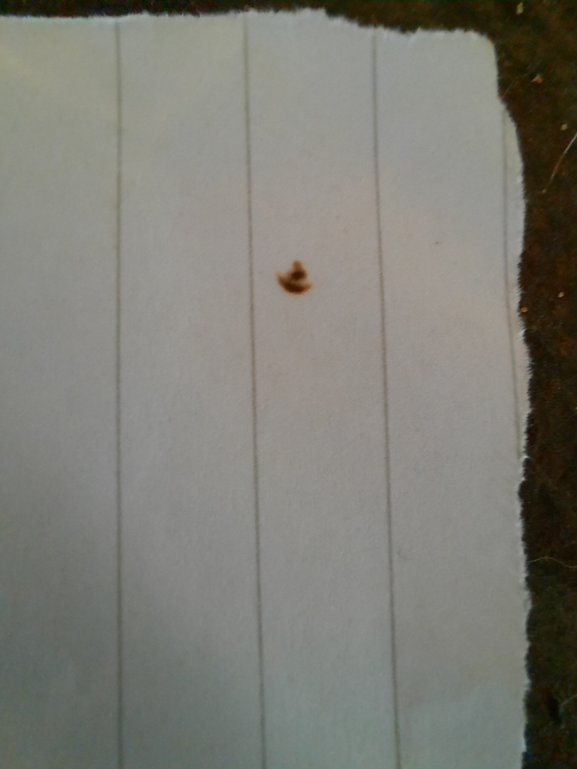

Have you done a first mirror pattern test?
Put paper between the laser and the first mirror, and do a short test fire. Take a picture of the pattern on the paper and post it here.
(Make sure you wait until your picture has finished uploading before clicking “Reply”, otherwise you’ll have the same problem as in the top post.)
I did the test like you said and this was the result i got. What am i looking for in the pattern?
Hopefully you can see the images!
There’s something wrong with the tube.
It may be resonating in TEM01 (the mode with two dots) but I’d expect the two dots to be more similar. Others more expert here might have seen more patterns. Maybe it’s actually TEM10 and part of the outer ring is attenuated by something?
This kind of damage makes me wonder whether the machine suffered some sharp mechanical shock that also affected the tube.

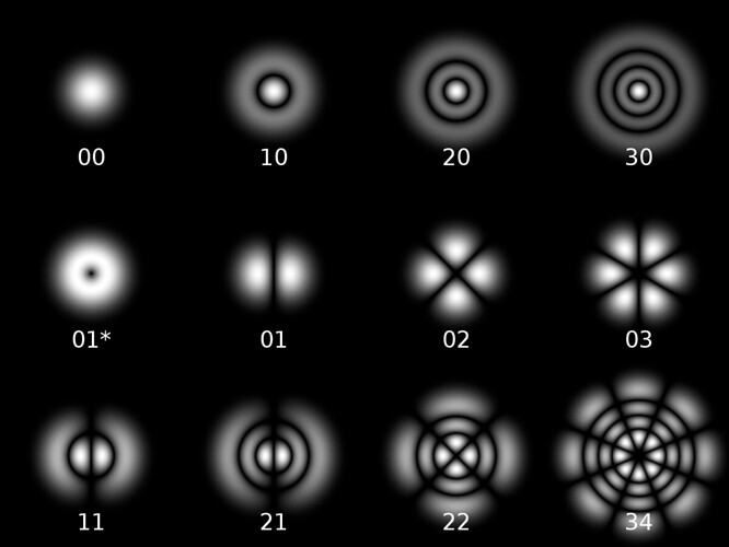

You want a dot that looks like “00” in this image from Transverse mode - Wikipedia
Any mode other than TEM00 is a failing tube that can’t be repaired.
That’s super helpful, thanks.
So, basically regardless of what the pattern that is firing is, the fact that it isn’t a single dot means i should replace the tube?
Let’s make double sure…
Last time I saw a pattern posted that looked to me like this, my recollection is that it was after at least the first mirror and was due to misalignment. But as it’s between the laser and first mirror, yes, I think it needs replacement.
I’m not the most expert person here. Anyone else here have an alternative reading of the burn pattern? Detritus stuck to the business end of the laser?
Assuming this is the beam from the tube, before m1…
I know if it isn’t TEM0 resonance then the tube is history.
I’d suspect there are an infinite number of patterns that could be produced. None of the ones that I’ve seen were perfectly balanced like the supplied photos.
But in all cases, it wasn’t TEM0 and the tube was bad. :face_with_spiral_eyes:

This test is before M1, so seems like I need a new bulb!
