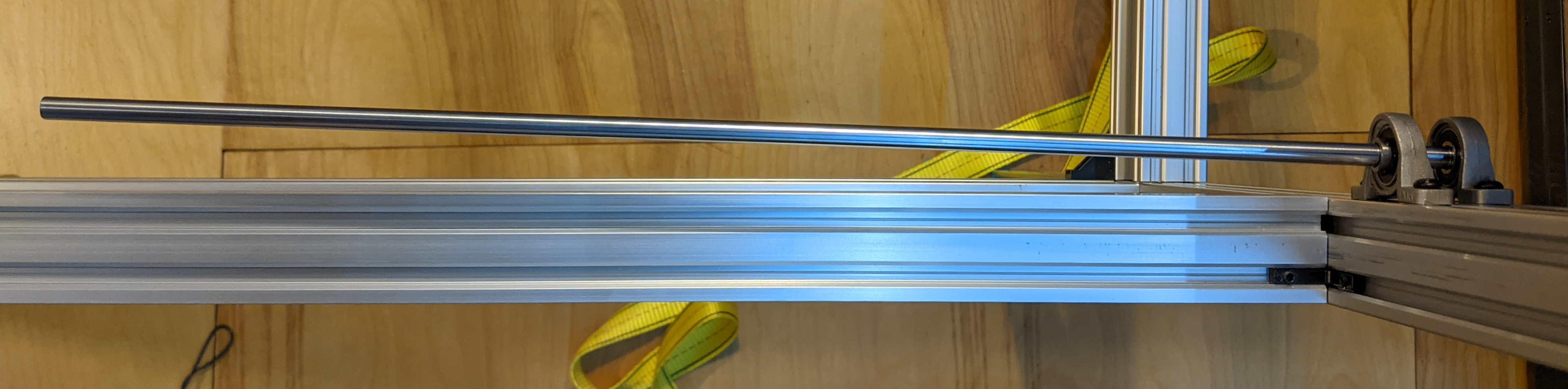

I tried installing some KP08 pillow block bearings in the Monocle this evening. I purchased all my bearings together in a single order and kept a pack together; I didn’t mix and match. Yet I had blocks of different heights, so that a rod through the bearings next to each other is not remotely close to even. I’ll have to test the rest of them and find out how many packs I need to return for replacement. This doesn’t have to be perfect, but it has to be a lot better than this to work right!

Nope, the casting is visibly a different height, and they are fixed to a vertical member (the image is looking down) so regardless of any difference in elevation, the problem of azimuth relative to the frame can only be related to that difference in height. It’s just real inconsistency between the parts.

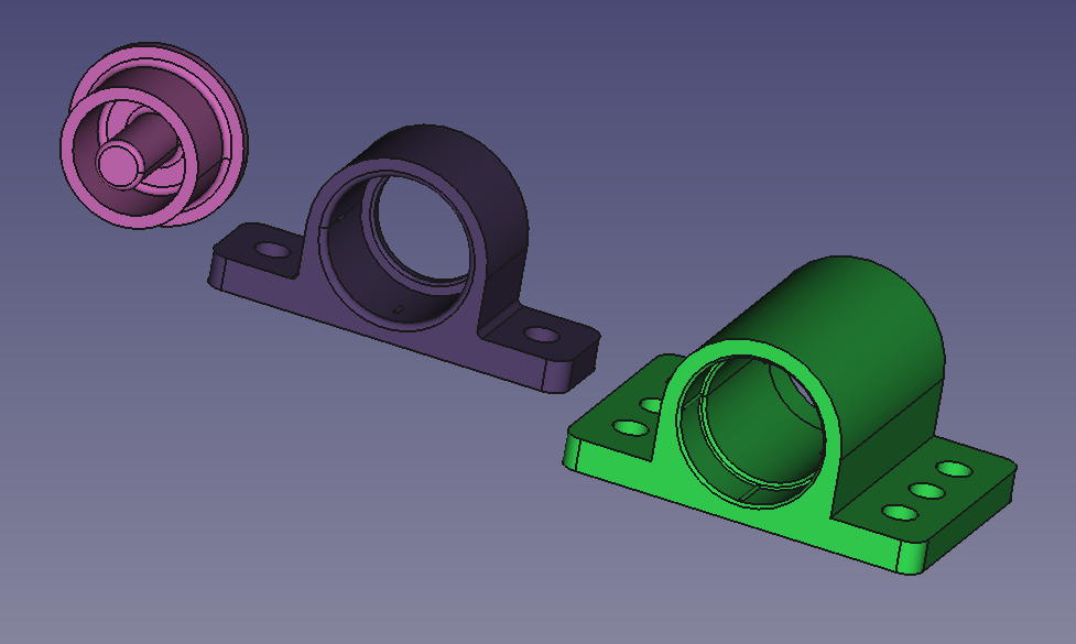

I made the silly mistake of using a second bearing to seat the first one, not considering that I wouldn’t be able to remove the second bearing. So I cut it apart and redesigned a bit based on that experience.
Here is what I have pushed to the repository right now:
On the left (in fuschia) is a tool for installing bearings in the single-bearing block (center, purple). The installation tool has a stem to register in the middle of the bearing being installed, and to press in only on the outer race. It is enough smaller than the hole to not bind, and has a ridge around it to grip.
I made the single block lower profile in this iteration. Someone who wants a higher profile to more closely match a KP08 would have to tweak the design. I also reduced the fillet on the foot to have a smaller overhang and print better. But designing for the exact diameter worked quite well; I expected to have to tweak it until it fit.
At the front, I need a cantilevered rod. Rather that aligning two blocks, I decided to take advantage of 3D printing and make one block that accepts two bearings. I put three holes in each foot; the outer two on each foot are on a 20mm pitch for installation on 4040 vslot, and the center one is for installation when only a larger center slot is available. I don’t need it but it might make the design more useful.

The single block cracked, so I need a bit more clearance. The double block did not crack even though it’s the same dimensions, so I didn’t adjust by very much for the next print (after my replacement control board arrives, sigh). It looks like the double block is going to work great; I’m planning to try the threadlock trick today and just make sure that no threadlock gets inside the bearing race! :smiley:
The installation tool worked great. I used a dead-blow hammer to seat the bearings, which might have contributed to cracking the single block; I think I’ll avoid the hammer next time and just go for a press fit.
Installed the replacement control board on my printer and printed the new versions with slightly more clearance. The bearings are a secure press fit with hand pressure, no hammering or mechanical advantage required.
