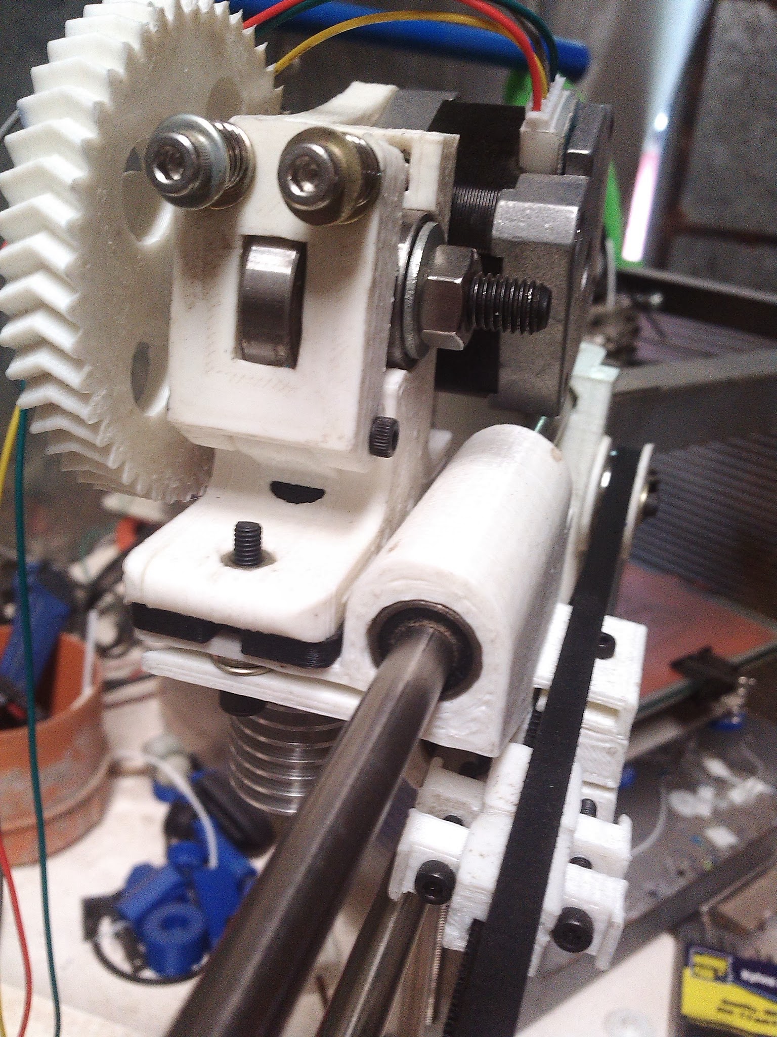

Not being able to design my own parts has really kept my back from making many thing. So i decided i need to learn a CAD program if i was to be able to advance in 3D Printing. Without this skill you are always just copping. This i couple of things i have designed or redesigned to fit my application. Lowered the extruder mounting down so the E3D hot end would touch the build platform, #wallace. Made a Y endstop holder. I had youse 123D Design some before but it was lacking for me to do much. Now DesignSpark Mechanical has been the one CAD program i have been able to really get things done with. If you are looking for a CAd program that is free and not to hard to learn i suggest that one.
