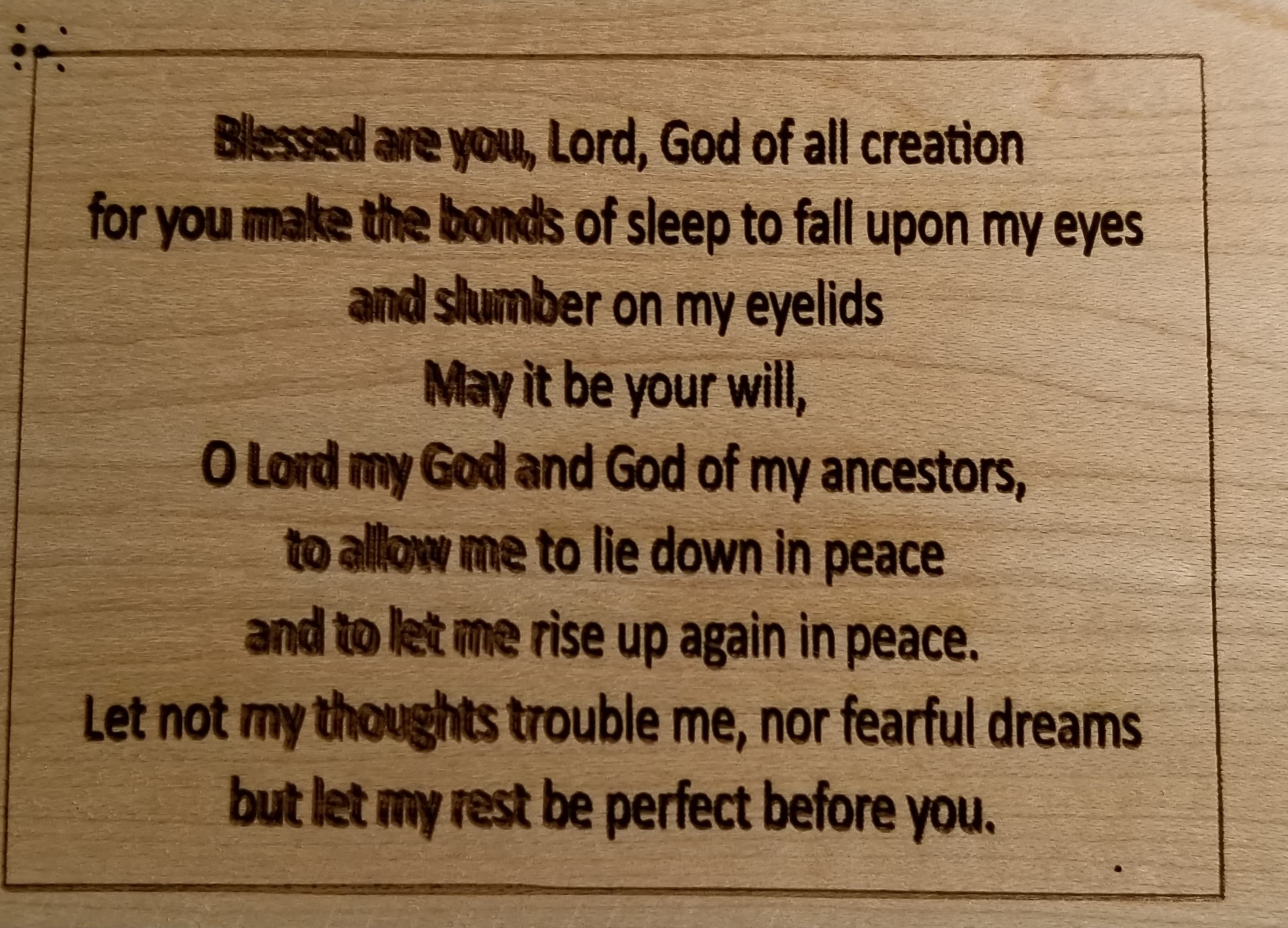

I am new here as well as to the laser world, I bought a K40 in December 2019, and have it set up (finally.) I have a problem when engraving.
K40 laser w/ analog amp meter, air assist, honeycomb bed , focused, mirrors aligned, water cooled, plenty of exhaust, using Inkscape to design, whisperer to engrave.
Problem: When engraving(Raster) a small 4"L(x) x 3" W(y) piece I get a heavy burn on my engraving on the right side towards the middle. this only happens when I set it up in the upper left portion of my bed. Lower right burns just fine. What am I missing?

If you look closely at the left side dark text it’s actually ghost engraved. Most likely it’s an optical alignment issue since it gets better as it moves to the right. The ghost splitting is most likely due to the beam clipping the inside edge of your air assist nozzle (or possible a mirror mount).
So check that your mirrors are all properly aligned around the bed and that the beam is exiting cleanly through the air assist nozzle.
The ghost engraving could also be caused by a damaged lens or mirror so check those as well.
Let us know what you find and we can go from there. Let me know if you have any questions.

My guess was a bit of drag on the X axis in that area and engraving in both directions so that the drag pulls it back as it travels in each direction. If that’s the case, engraving at a slower speed would likely reduce the impact, and engraving at a higher speed would likely make it worse. It does look like it is offset not only left/right, but also a little bit up/down, which would make sense for the mechanism racking slightly under certain loads.
It still looks to me like a mechanical problem, but I don’t have any good ideas why it would affect only that corner.

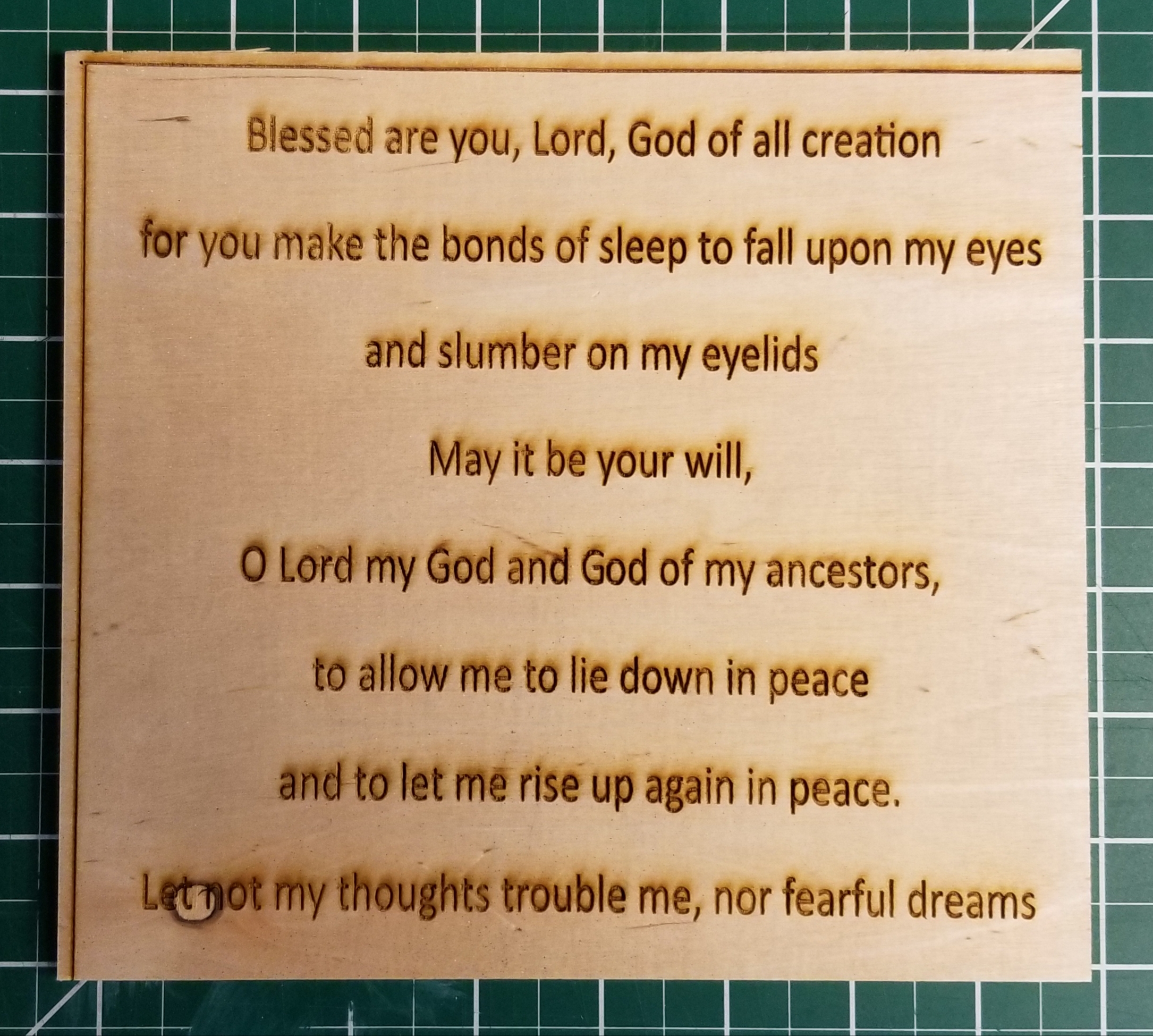

The problem only exists in that one area (upper left). The odd thing is larger text engraves just fine.
Can you provide a picture of the large text engraved in the upper left?
Here is the larger text aprox 8 in x 8 in on 1/4 in ply. The original was aprox 4 x3 on hard maple.
I see no problem with the larger text. But zi may be missing something a more expirienced eye will catch.

I could be wrong, and I’m not an expert, and it could be an artifact of the photo, but the “Blessed” and “make” below it look to me like they are affected by the same problem. I’m particularly comparing the second “e” in “Blessed” to the “e” in “slumber” because the “e” is sensitive to the diagonal ghosting effect. @NedMan your thoughts?
