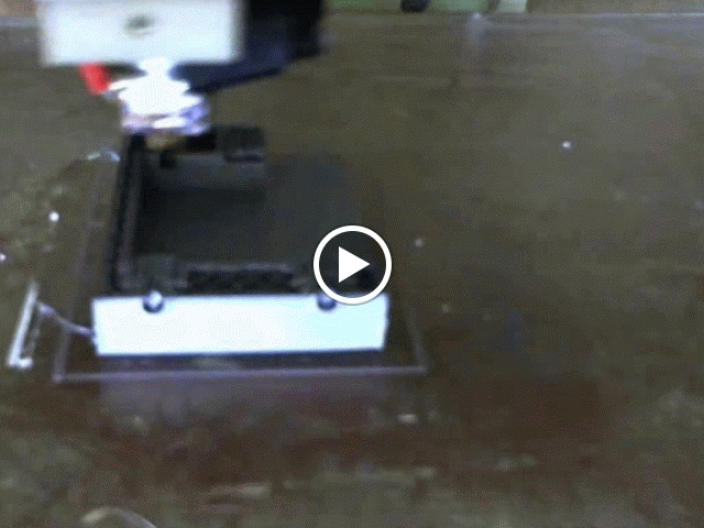

I have been having prints fail consistently for almost a month. I have been trying to make these parts for a new concept Im building. Simple 4 walls, no complex geometry.
Almost every time I get halfway through and the parts fail at the cold end. Either filament binds up or grinds away or back drives the motor in the case of the airtripper. Here’s what I’ve tried so far and machine specs.

Ive cleaned my nozzle many times to the point that its shining inside and out, Ive changed bowden tubes, motors, drivers, extruder gears and hobbed bolts. Im not sure what too try next. I just know I want to print reliably.
If you need any other details ask that’s all I can think of now. Whats really frustrating is its random I have a full set of these parts that printed fine. But it took almost 2kg of filament to get there. This is to a point that Im ready to quit this all together. The time I have spent on this is just too damn much and the only variable left is me I think. So who’s got some advice.
